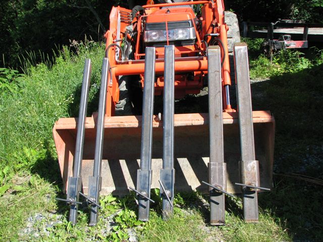

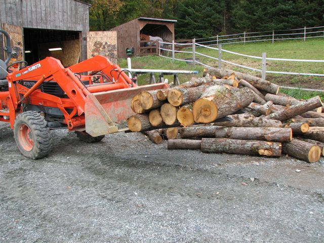

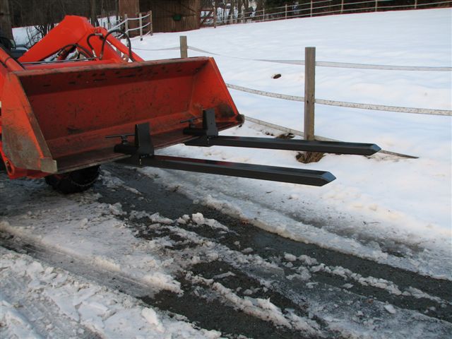

I use the heck out of these.....which I built in my home shop. I have lifted over 2000 lbs (different tractor, My 4310 won't lift more than about 1600). They are made from 2 x4 x .25 wall rectangular tube, usable length of 42". Can't bend them with the Kubota, and the bucket has no signs of bending.
Jim

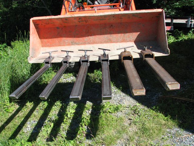

Here's a few different versions I built for friends! From left to right they can handle 1200, 1600 and 2000 lbs.
Jim

Hi Jim
What are the 2000 pound units made from?
I live in Wolfeboro.
Tim

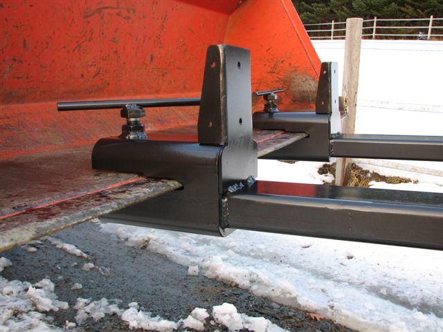

   / Newbie likes clamp-on forks #19
The fork tongs are 2 x 4 x .250 wall rect tubing, the side plates and clamp assembly are 3/8" steel, the clamp bolt is 7/8-9.
I'm in Enfield, near Lebanon, Hanover area.
Jim
