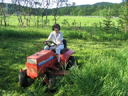

Picture shows mowing ~30" tall field...
...the Gravely mows like an animal... makin' full 60" cuts with deck at 3 1/4" and not breakin' a sweat...
Dave...
