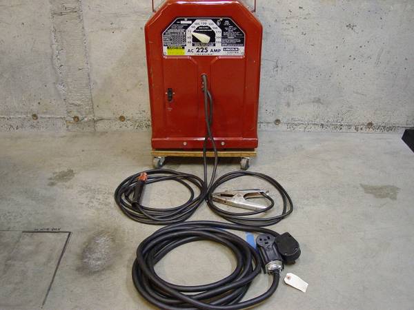

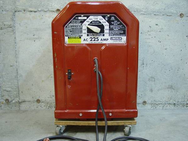

I've read here on TBN this is the only welder you'll ever need. They build bridges, and skyscrapers with these.:D
Shield, I have one of them I will sell ya... and uh... I have a bridge up in NY, I will let go pretty reasonable too!:D

A lincoln 225 which is called a buzz box is a good beginner machine. I don't like SMAW stick welding with AC current.You can look for a Lincoln 225 AC/DC buzz box which would be better. The Everlast looks like a nice machine also. Look at your options. You may want to consider taking a evening Welding class at a local high school or career center in your area.
