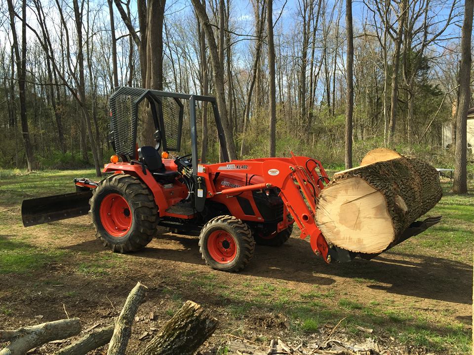

I only have 2 acres total and wouldn't mind a bigger tractor than my Kioti DS4510HS. The size of the land doesn't matter, it's what you expect to be able to do with your tractor. I always find that I have something heavy to lift. In reality, I have not yet wanted to lift anything that I couldn't lift with my tractor. However, I routinely move things around that make me which the tractor had a little more weight / stability. Even just moving "sticks" around with the loader can make the rear feel light with loaded tires and a heavy hydraulic angle back blade!
I often do things with my tractor that I never thought I'd do before having a tractor. Like give hay rides at my cousin's company picnic. trailer with hay and people gets up to 7000 pounds and there are some big hills. For this, the bigger the tractor the better.
The thing is, after you get the tractor, stuff will come up. You'll get idea's. You'll want to do things you never thought of doing before. And inevitably (and I think it's happened to just about every member of this site)... you'll say "I wish I had a bigger tractor".
Like the previous poster said, pick the biggest highest capacity tractor you can get for the money you are willing to spend that will fit all the places you want to take it and can be operated by all who need to operate it. As long as it can fit where you want to store it, fit on whatever you plan to transport it with and go where you want it to go, it's not too big for your property.:thumbsup:
