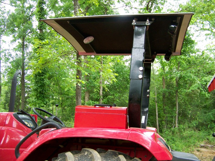

If no cab, buy an insulated aluminum canopy. They don't fall apart after years of vibration and sun baring down on it. I put a thermometer and lights on front and back of my canopy. 4-9-08 Temp guage and tool box installed.jpg
