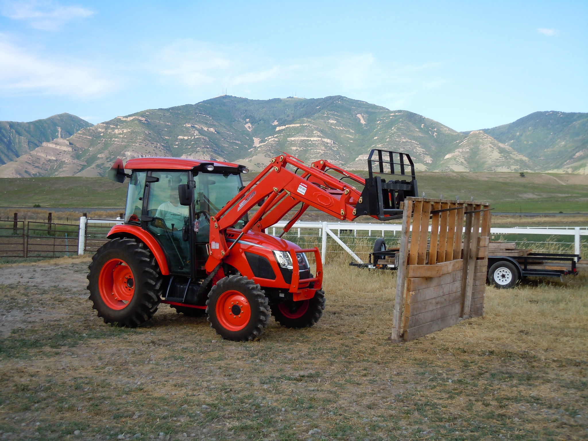

My fiance and I are about to purchase a new (to us) house on a 3.6 acre lot in Denison TX. I will also be moving my part of the family business into the outbuilding on the property, which will sometimes require a forklift for unloading and loading pallets from freight trucks.
I will need a tractor for mowing, moving rock/dirt, repair/maintenance of the gravel driveway, and to double as a forklift to move pallets (up to ~1000 lbs). I would rather stick with a mid mount mower deck since I will be mowing around fences, driveways, flower beds, and a pond.
I also think I will probably have to buy a rear forklift attachment like this to handle the weight of the pallets:
(Sorry, I haven't reached my 3 post limit to post links)
I have been researching equipment on the internet, and have narrowed my choices down to either the Kubota B series, or John Deere 2 or 3 series. Hoping to find something used rather than brand new, I'd rather not finance if I can avoid it.
Am I on the right track?
Any suggestions will be appreciated.
Thanks

You are on the right path. From what your posted needs I would think a B series Kubota ~30HP should meet your needs.

From what you describe I would look for a used L series Kubota with a FEL, don't think a B series will pick up that weight safely.
A self leveling FEL would be perfect, you don't have to look behind you to operate the tractor, suggest you pick a tractor (tractordata.com is a great guide) with 50 percent more lift capacity than you expect, and make sure you have rear tires filled plus rear ballast. Alternatively, you would have to add a lot of suitcase weights up front on your tractor to balance out a heavy rear load with that fancy fork lift attachment.
Most folks here have found that buying a separate lawn mower/zero turn works out better than trying to get a do everything tractor that also mows. You may like the simplicity of one machine but functionally, a separate lawn mower usually results in a happier owner.
I also suggest you get a model with a hydrostatic transmission for doing loader work, less jerky and much easier learning curve.

1000lb FEL lifts + B series = not a good idea
Recommend 2500lb+ bare tractor weight with loaded rear tires and counterweight. Kubota L series, Kioti CK series, Yanmar YT2 series are all good options and provide the weight you need.
Recommend separate mower for the lawn; cheaper, faster, and non-proprietary.

The pallets I will be moving will be stacked with IT equipment (routers/switches), and the packing/strapping on the pallet(s) is often just barely adequate for riding in the truck. They need to be held as perfectly level as possible to avoid damage. My plan for ballast was to load the FEL bucket with ballast when needing to lift heavy pallets (probably only 2 or 3 times a month). A separate mower is out of the question. I can justify one or the other to the fiance, not both.

I hate to say it, but to get a compact tractor big enough to do the fork lifting you want, and to be much use at all for dirt work, it won't be very practical for mowing around the house. The first time you knock the corner off of the kitchen with it, your fiance will think differently. Better yet, have HER try to mow around the house with it, so she can see for herself that you're not just trying to "scam" her into more cool tools.

Rear mounted forks can only lift 12-18" (whatever the 3pt lift range is on the model you get). That'd be fine if you're picking then up off the floor and moving them around but not if you're unloading them off trucks. If you're moving the pallets around on a hard surface you can use a pallet jack instead of a tractor.
With pallet forks on the FEL it can be difficult to keep the pallet perfectly level as you raise and lower it. Self-leveling loaders are rare in CUTs especially smaller ones. The pallet level will change some with the 3pt pallet forks too, and unless you have a hydraulic top link you won't be able to compensate as you're raising the pallet. You can change the geometry to lessen the effect some by moving the top link to the upper hole on the tractor.

Financing with Kubota or Deere really isnt financing. You going to pay very close to the cash price, and if you finance it will be 0% interest over 4+ years. The only downside to it is that you must carry insurance. You might want insurance anyway, so it could be mute.
Now now on to the machine.
1. How high do these pallets need to be lifted up or down for loading and unloading? If you are spending hours a day moving pallets a rear lift is going to be a pain and front forks arent very maneuverable. If only once or twice it will probably work.
2. Self leveling loader is harder to find in the smaller machines. I am not sure they are offered on any of the compact machines....Grand L included. I looked at the L3560 and lower and didnt see them.
3. As others have said...1000lbs on a B series is really pushing it. If you are lifting it 2 ft off the ground maybe. If you are going higher, it just isntgoing to do it safely if at all. It isnt just about lifting it. It is about stability when you move with the load and overall tractor stability when lifting or lowering the FEL with the weight on it.
4. To me your real decision is FEL lift capacity vs MMM. You arent going to get both of these in 1. If you really need the lift, then you will need to skip the MMM. Lots of other great suggestions here...a ZT or riding mower or even RFM + push mower for tight spots could work.
5. You can get a good riding mower or maybe a ZT for the price of that rear fork lift.

I will probably only have pallet deliveries once or twice a month at most. The highest point they would have to be lifted is about 55" (to remove from the truck). This would literally be a matter of a couple of times a month getting deliveries of multiple pallets that are usually 1000 lbs or less each, unloading them from the truck, moving them down the gravel driveway (100 yards if unloading from the street, or 5 yards if the truck backs into the property), and setting them down on a concrete pad outside the shop. A pallet jack is then used for moving them inside.
As shooterdon suggested I can (and will) break apart any pallets that I think are too heavy for my tractor to handle.
After reading all of the replies here I am convinced that the mmm is probably not the best solution, so I will look for a zero turn mower first, but that will allow me to consider a larger tractor to do the other jobs I need it for.
