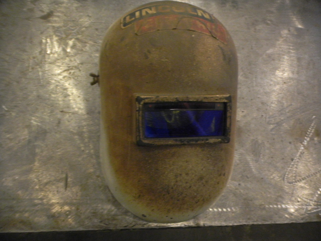

   / newbie needs safety equipment? #12
I still want to try those fancy "smoke n' spatter" rods you used SA, my hoods are too clean :D
