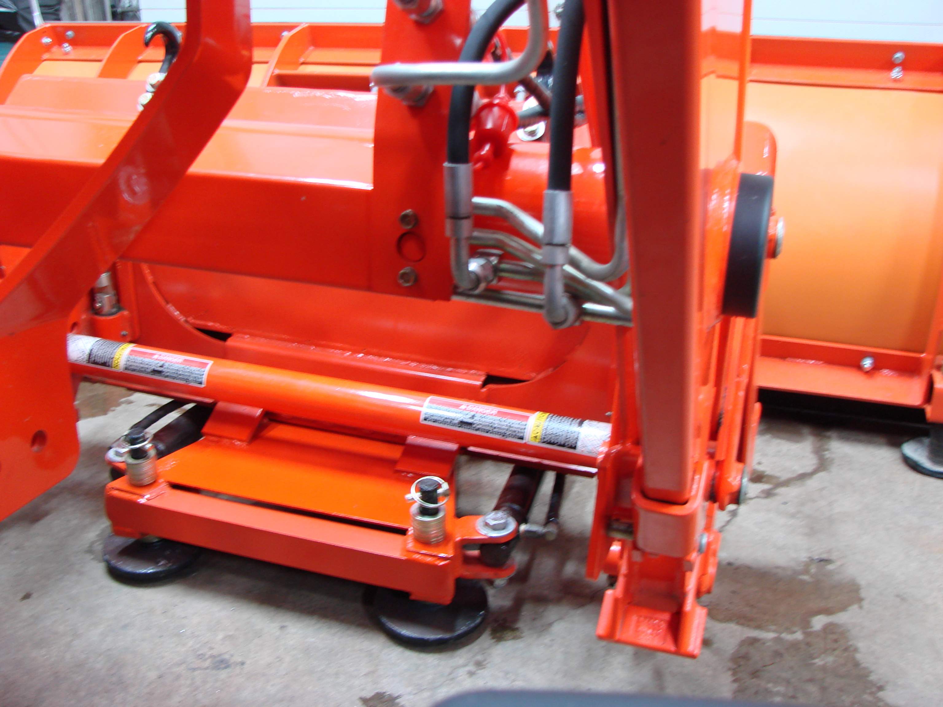

There seems to be some confusion to why I put the skids on the blade. Yes most of my plowing is on asphalt but most of our back property is gravel. When I originally did the plow conversion my goal was to get the blade as close to the FEL as possible. Because it was moved back meant the rear of the blades "A" frame could have gouged out the pavement so I simply added those rear shoes to keep the rear frame up. Incidentally I seldom use float mode. I have much more steering control without it and the only time I will use it is on straight pushes if I use it at all.
I did the same thing.
My A frame and cylinders are under the loader arms to keep the plow close to the FEL.
I only added skids to the back to keep the cylinders from grinding in the dirt.
I never use float. Can't steer.
