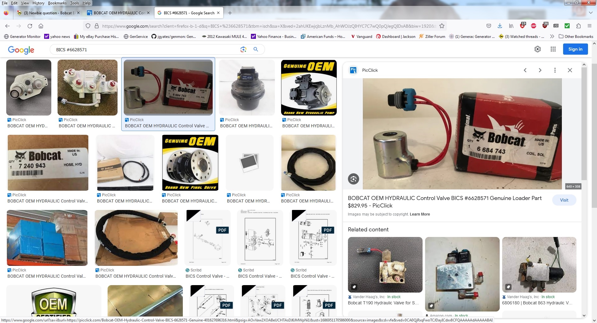

Thanks, I had found that as well, although I'm not sure what the main control valve is, and I don't know where the BICS lock solenoid would be. Do you know if the "main control valve" is the same thing as the Hydraulic Control Valve shown here:
Hydraulic Control Valve (9 Section Assembly) (W/O Angle Blade) - Excavators Bobcat E42 (B2VW11001 & Above) | 777parts.com
For the BICS lock solenoid, do you know if I should be looking for something that looks like this:
Solenoid Valve Coil For Bobcat® | Replaces OEM # 6309311
I'm also trying to determine if this E42 excavator has a BICS controller. I've found other references to a BICS controller for a bobcat skid steer, like this:
https://f01.justanswer.com/Fieldtec...-9568-5e02dddc1e4e_Bobcat_BICS_Controller.png
Do you know if the E42 excavator has something similar that I could investigate?

the BICS is the hydraulic control valve. find the valve and look for an electrical solenoid attached to it. then follow the wires. you will need to contact bobcat to get exact part number asociated with model and possible vin number. but it should look something like this
