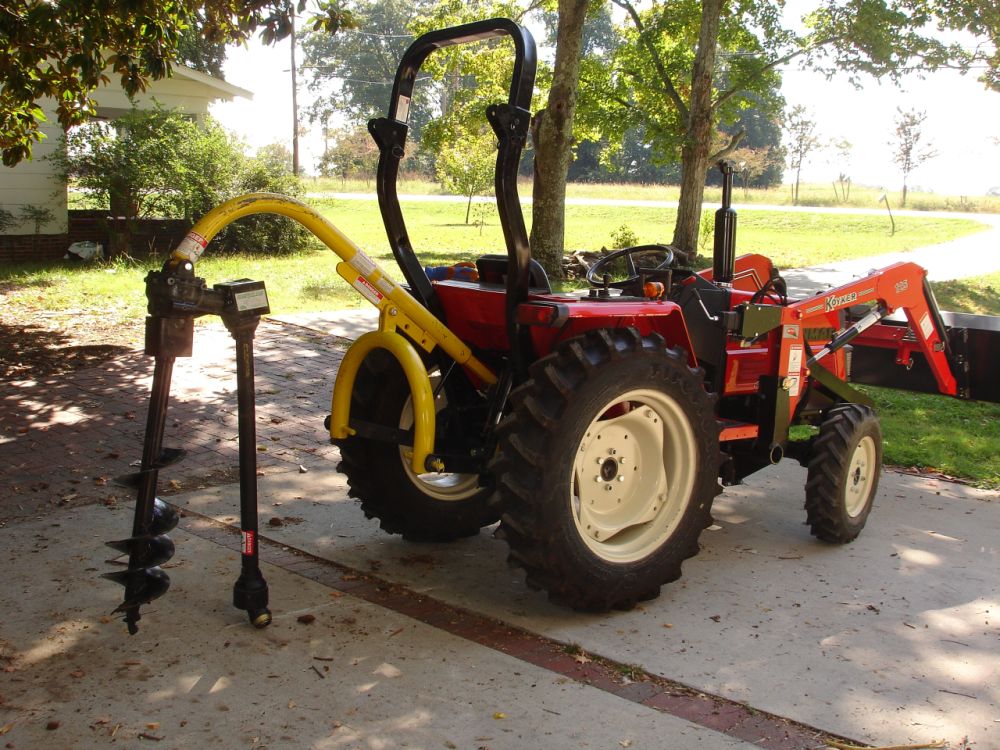

Finally, I hooked up the post hole digger, because I need (pretty desperately) to dig a hole for a mail box at our new house. Problem is, when everything's attached, the driveline is about 1 or 2 inches too short, and won't reach the PTO. I can't see any way to lengthen it, and I'm stumped. The top arm of the auger is pinned through the top of the three holes in the piece above the PTO where the top arm of the 3-point hitch (no, I don't know what it's called because I'm new to all this :) ) goes. Perhaps putting it in one of the lower holes? I've attached a picture to show everything hooked up, just to make sure I don't have it on upside down or backwards or something. Anyone have any ideas how to get the drive line to reach the PTO?

That pto shaft is probably 60" or so....I don't see how it can be too short. It does not appear that you have it pulled out as far as it will go.
   / Newbie questions about my new FX24D
You mean all I had to do was pull on it? :)
Getting that auger hooked up was by far the hardest thing I did today. I'm gonna kick myself if I just needed to pull on the shaft to make it longer.

Loosen the bolts a little & shoot some grease in between the folding area work the unit back& forth then, tighten back up . This should help, mine was tight at first.Like LMTC said,. Have you pulled that drive shaft to it's full extension ? You do know it slides in & out to make it longer or shoter ? looks like I was posting at the same time you were . glad to see you figured it out
