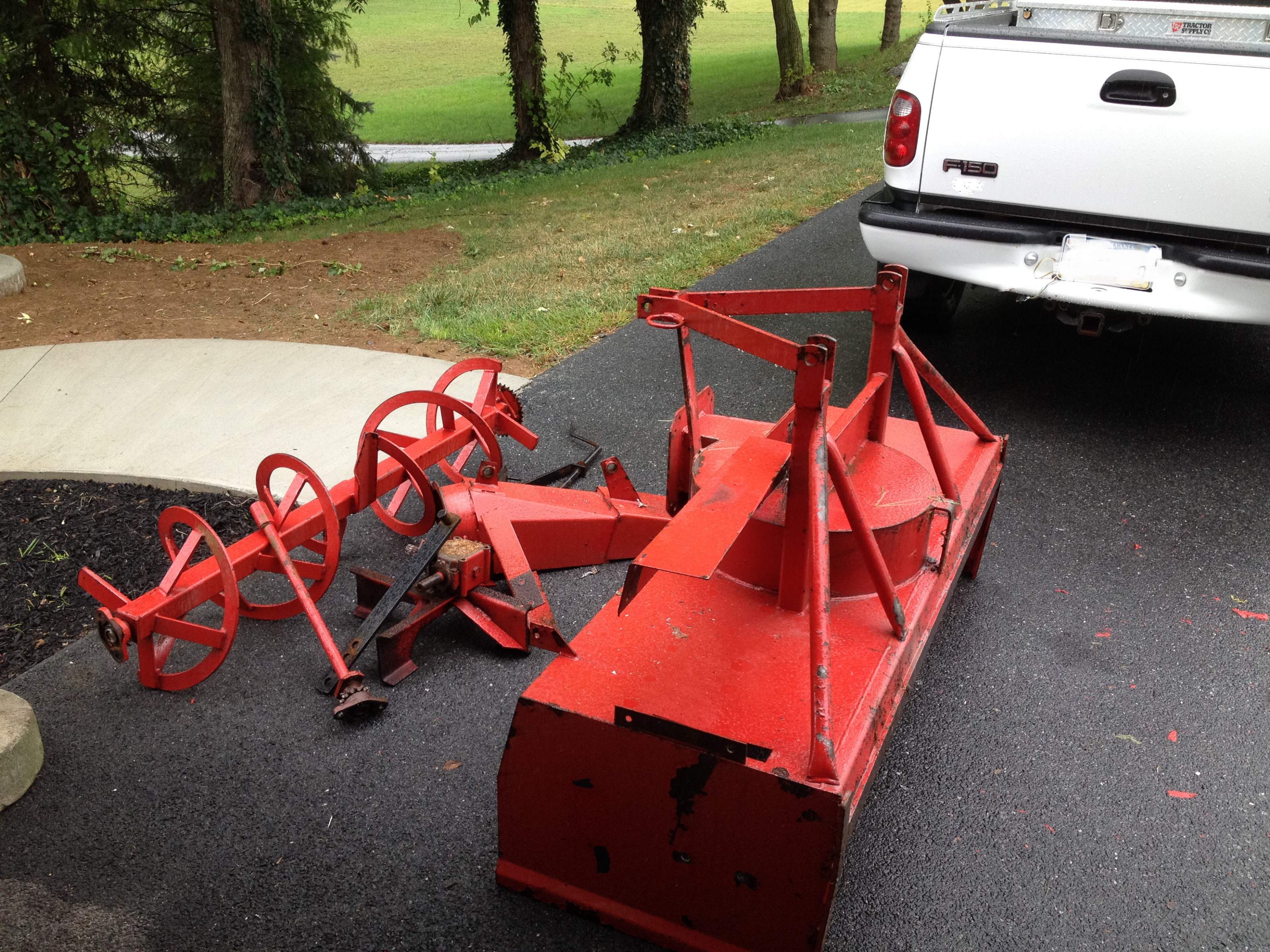

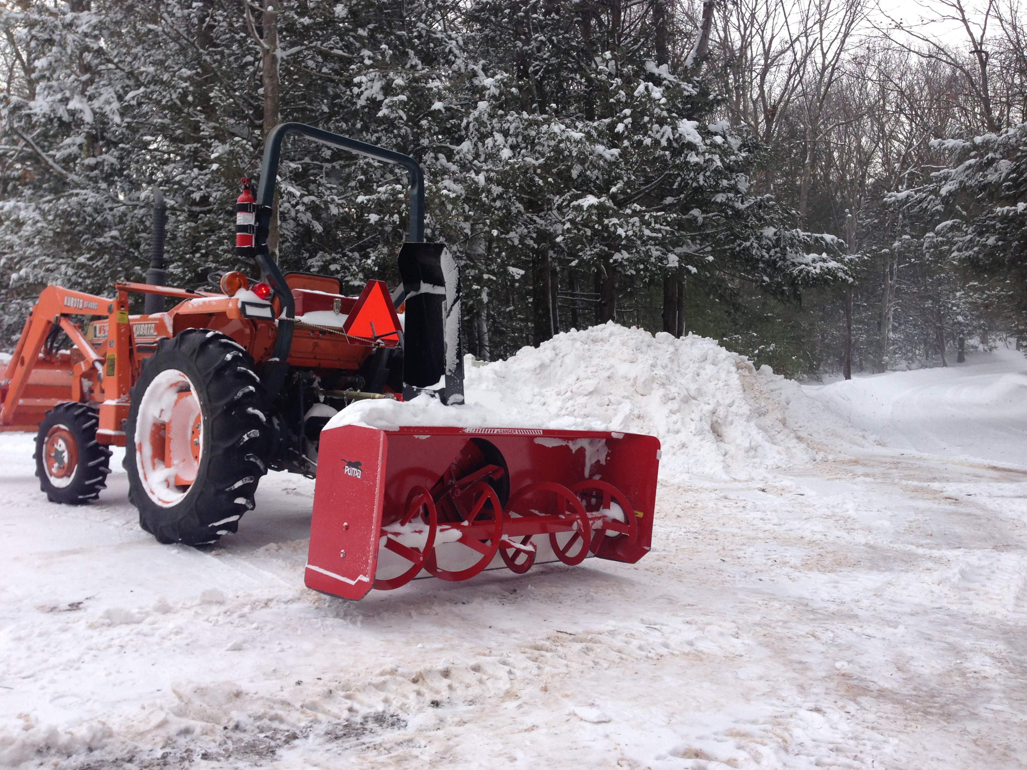

This past Winter was the first season for the used Pronovost Puma 64 I bought in the heat of Summer 2014. It was in good mechanical shape but needed paint. I used Pittsburgh AUE300 and it held up very well. The only area that didn't was part of the inside of the blower. Small stones can be more than a little bit abrasive.

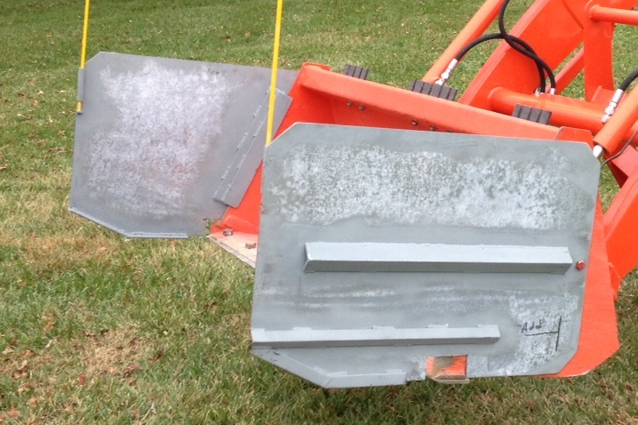

While I had it in the shop, I added an electric seat motor for rotation and a small linear actuator for UP/DOWN of the discharge chute. The FEL and rear blower combo worked well. I also made a pair of extensions for the FEL bucket that made it into a fairly effective pusher. The extensions sandwich onto the side of the bucket and are effectively held in place with one bolt each.
Here's a short video of the chute operation and pics of the blower disassembled & then installed. Also a shot of the bucket extensions.

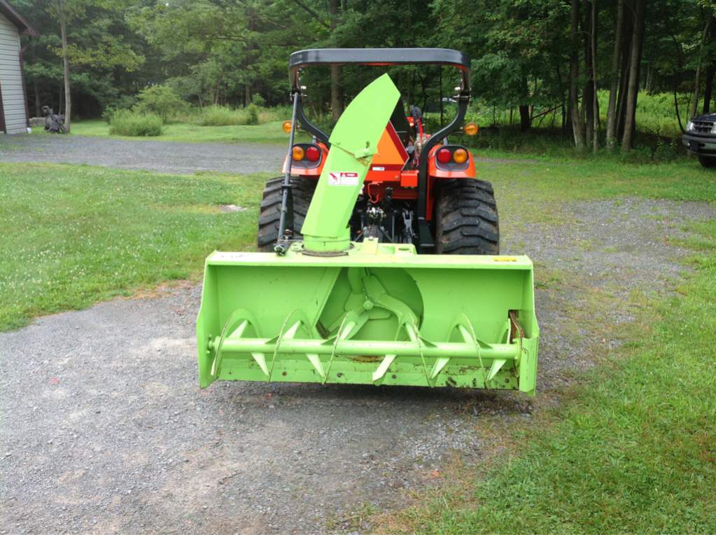

If I was looking for another 3pt blower I would buy a used one again. I looked for about 5 months till I drove by one for sale on someones front yard last July. They are out there but you have to always be looking and patient. You could save yourself a lot of money. 3pt blowers are pretty simple and durable machines with few parts,drive shaft, chain, auger, impeller, gearbox. Most units will rust away before any of these parts fail. Also, used blowers typically have low hours on them since they are only used after a significant snowfall. Maintaining 2 properties, both with 200' drives and parking for 8 vehicles, I only put 6hrs. on my blower last winter. Anything under 5" I plow with my garden tractor and blow back the banks with the 3pt the next big storm. The 62" Schulte blower I purchased is 3" narrower than my rear tire track and this concerned me the rest of the 2014 summer until the first snow. I could see the advantage of the wider blower letting me get closer to objects, but I personally don't have any conditions where this is very important. After the first pass, subsequent passes are about 3/4 the width of the blower to prevent wind rowing. When buying the blower of your choice I would make sure that you get at least a 22" fan with 20" being the very, very minimum. Also a chain driven auger.
This is the 1995 Schulte 6200 I picked up last summer for $1,000. Good luck hunting.
