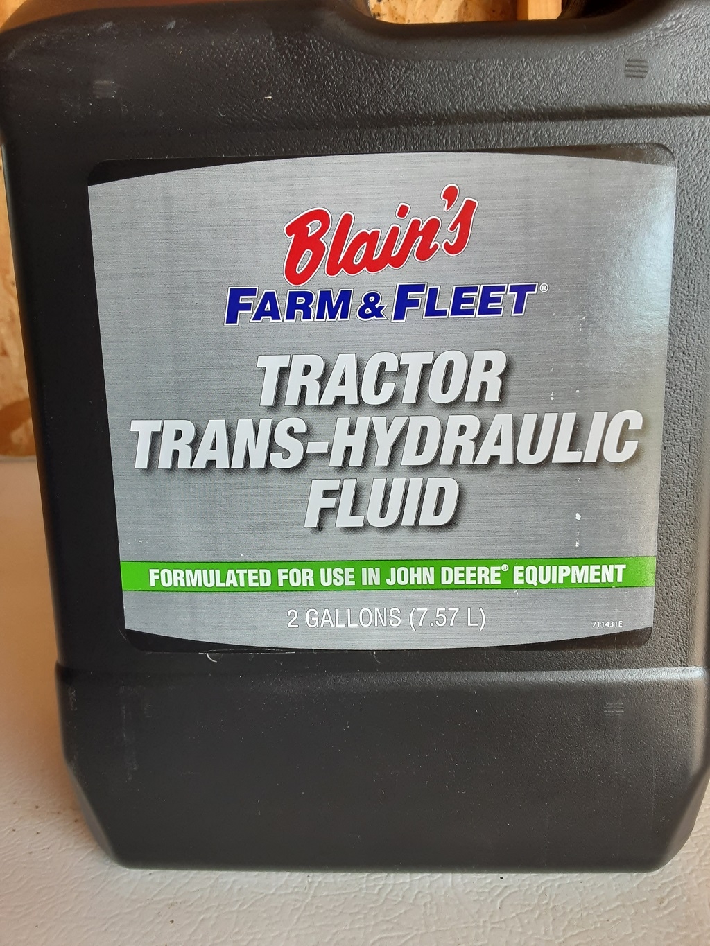

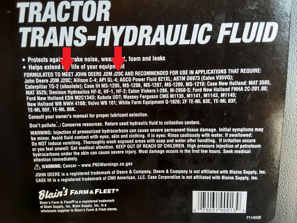

When you flushed the hydraulic system, these older tractors can use diesel for the flush and a few cans of Seafoam. From Yanmar records, the capacity is between 8.5 to 9qts stock, without loader nor power steering nor external power beyond.
And when refilling use only J20C specified fluid. Be sure it states MEETS J20C and never 'compatible' with nor 'recommended'. Those are marketing terms and can cause odd behaviors with the hydraulics otherwise.
Here are examples,
