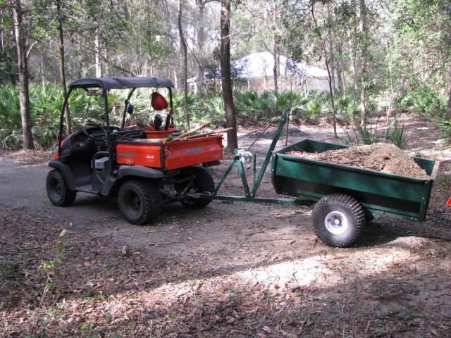

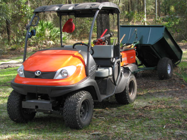

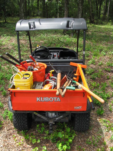

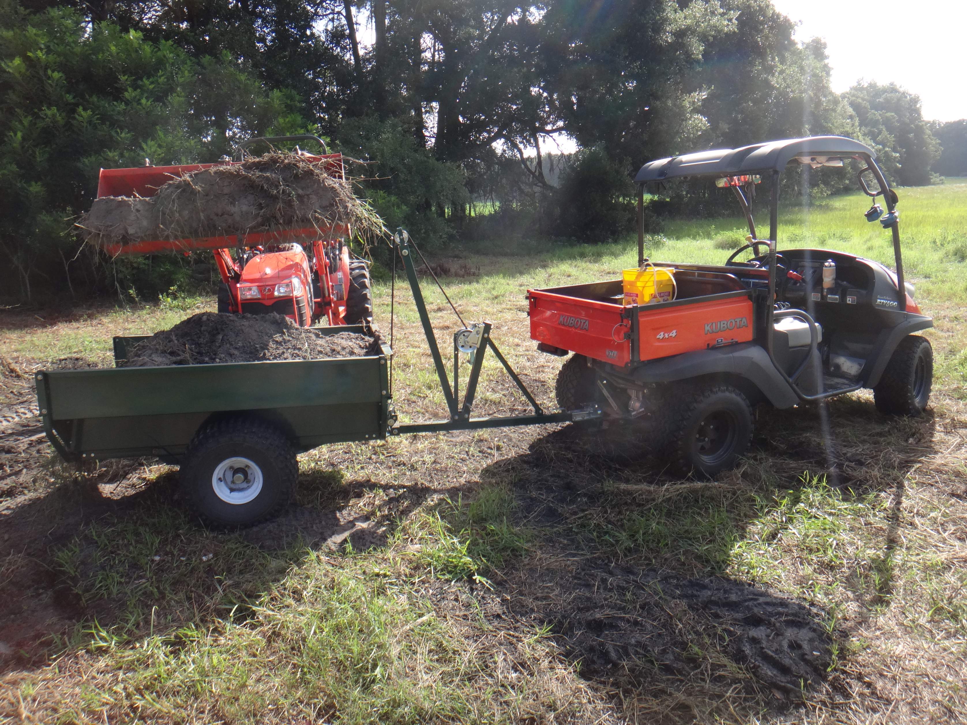

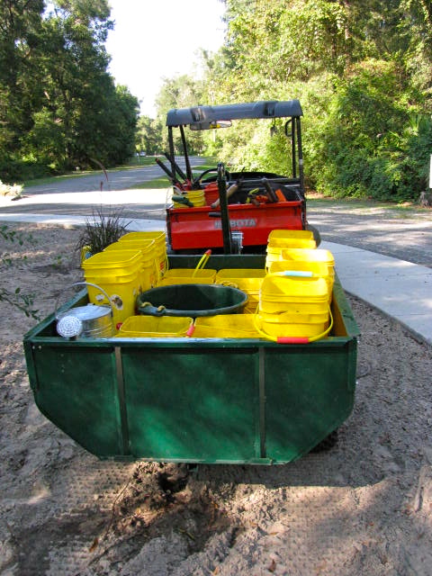

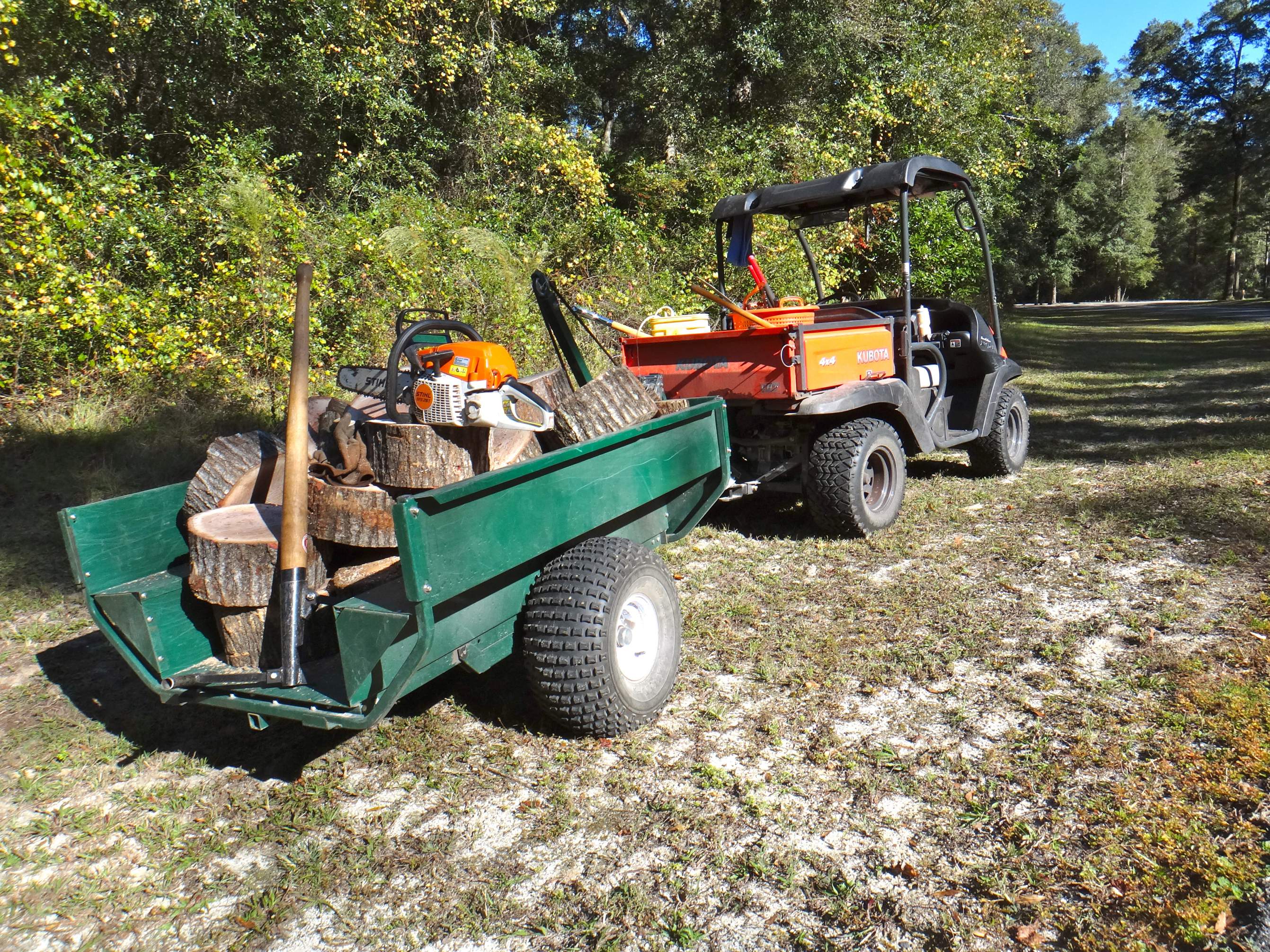

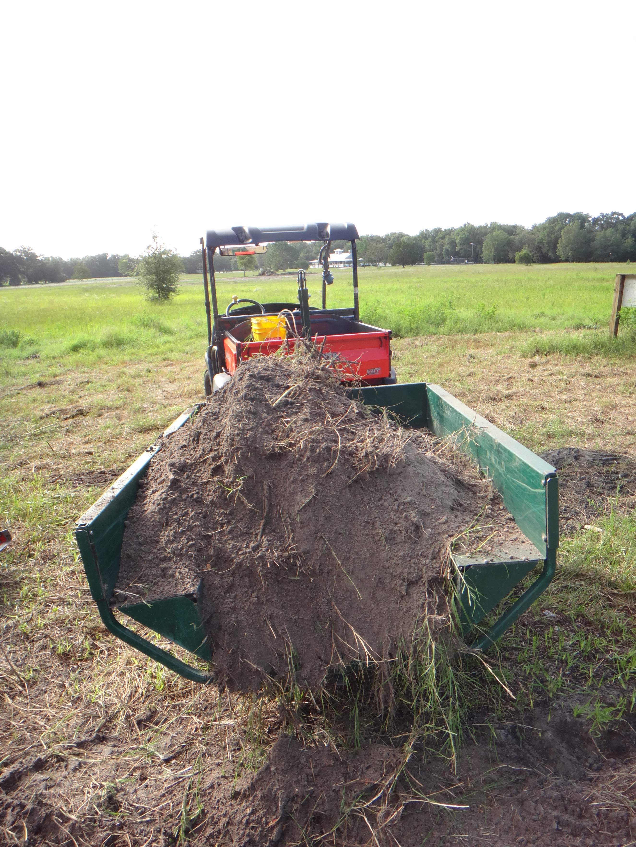

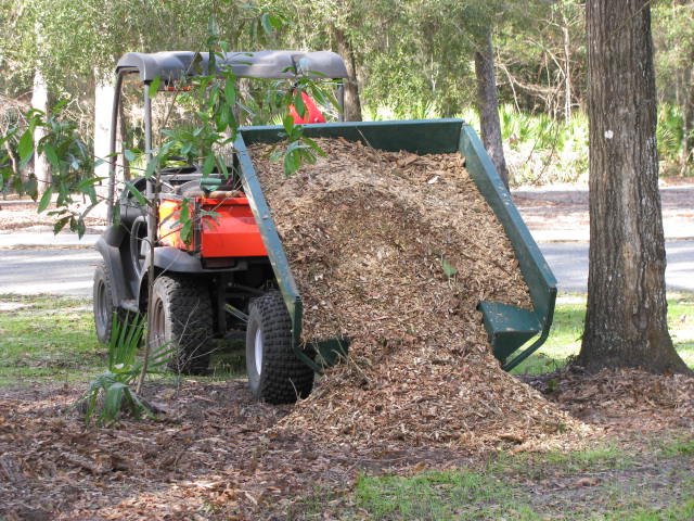

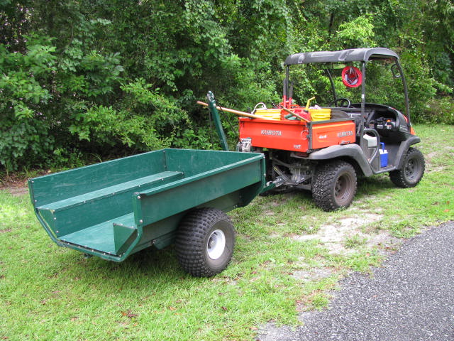

Your Gator, if it is a heavy one, with the addition of an all-terrain dump trailer, should take care of a lot of your barn, farm animal, snow and garden tasks, mitigating your perceived need for two tractors. I have a friend in Iowa who moves a lot of snow with his heavy Gator and a front snow plow.
LINK: MUTS - Multi-Use Trailer System for your ATV, Quad and 4 Wheeler
- Welcome
