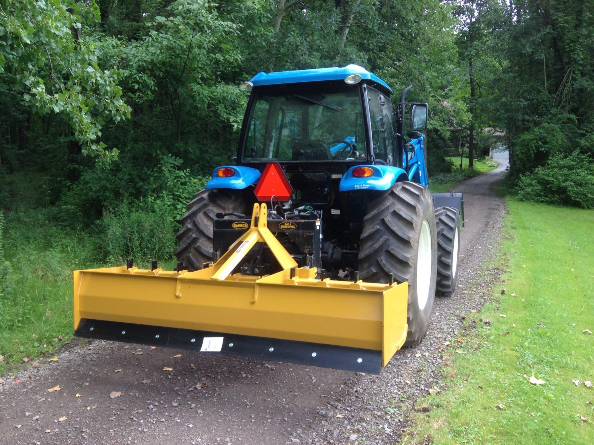

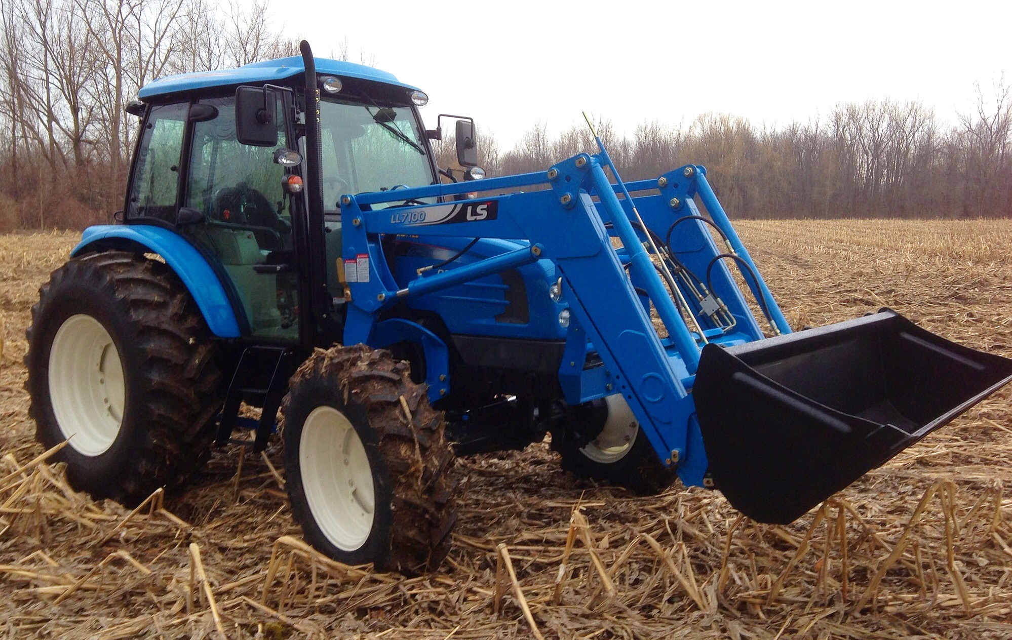

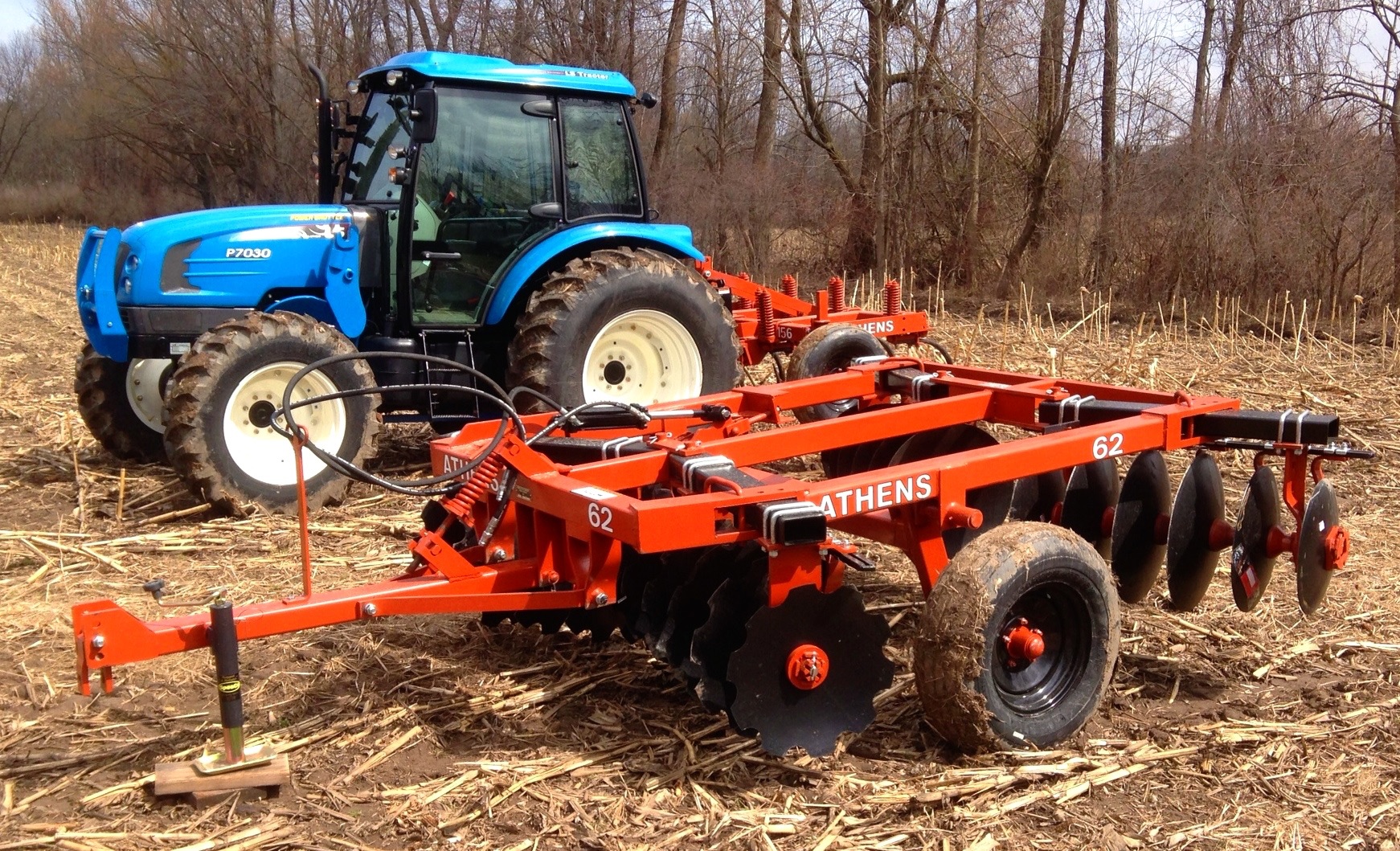

I have the 88 hp version, the P7030 with the power shuttle. They still list it on the LS website but don't think they have any more in stock. With the power shuttle, you don't need to use the clutch when going from forward to reverse or back. On the 7030 and 7040 you also have push a hydraulic/electronic hi/lo that allows you to go up or down a gear with the push of a button. It's a great feature that you will use all the time.
I maintain a 1/4 mile gravel drive in winter and summer and have 35 acres of tillable and 42 acres of woods to maintain. The tractor seemed large at first but has gotten smaller over time. I run a snowplow, land plane, box blade and landscape rake on the drive and it's not too big. I have a 7 shank chisel plow and transport disc that it pulls great, plus many more attachments.
It would be a lot of tractor for a persons first tractor but I don't feel it is too big for your needs. Good luck in your search!
