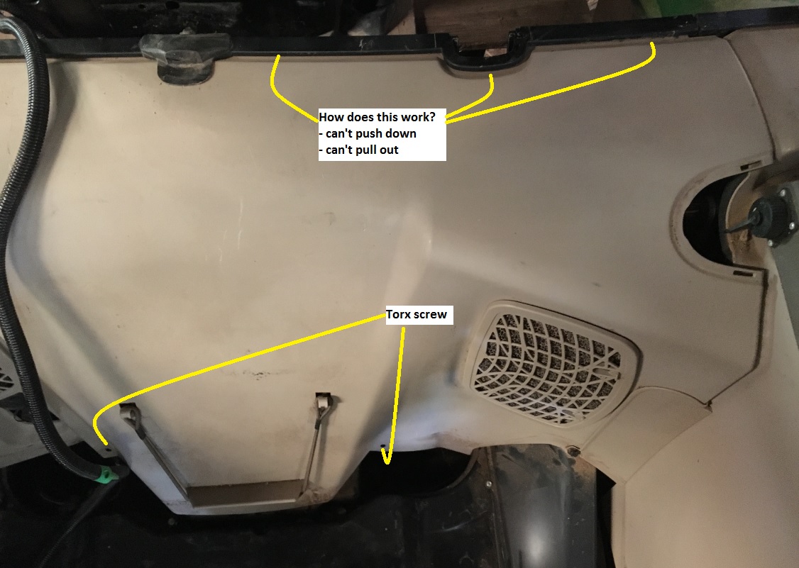

#16
Getting frustrated here. I *thought* I paid good money for information from JD. I guess it wasn't enough. Here is one step in their instruction to get to the evaporator/blower: "Take out floor mats (A) and remove trim panels (B)." The mats are not attached, so no problem. Trim panels are composed of a side and a rear panel. They provided picture and instructions for the side, which I did without their help. But the rear panel -- whoa. I am stumped and there is no information provided other than the word "remove".
Two lower screws are out and the panel can pull out at the bottom, but the top seems like it could be designed like a barb - push in to catch, but can't pull out. Even expecting this, it is very tight and I can't get one edge started to see if my concept is correct:
Anyone removed this? Care to share a tip?

Started a new thread just for the panel. Hopefully can get some info.
