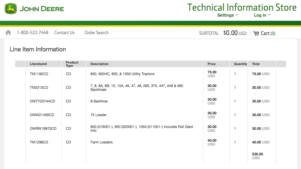

A bit more searching on this forum and I found threads answering some of my questions:
Coolant system: Folks talk about flushing with distilled water, then things like vinegar and a Prestone radiator flush, before refilling. It sounds like whether that is useful or needed depends on how bad the system is, so I'll see what the fluid and filter/screen look like when I drain.
I called John Deere techpubs, and they confirmed the cd's just come with PDF's on them, so I can get copies printed locally whenever I need to. I'm a bit surprised they still use cd's as opposed to emailing me a file, as most computers don't even come with disc drives anymore! I ordered the whole set (tech and operator's for tractor and both implements):
They cost more than I was expecting, but the manuals look pretty useful. Now I've got to wait a week or two on those manuals shipping and printing before I start digging too much into the little fixes needed!
