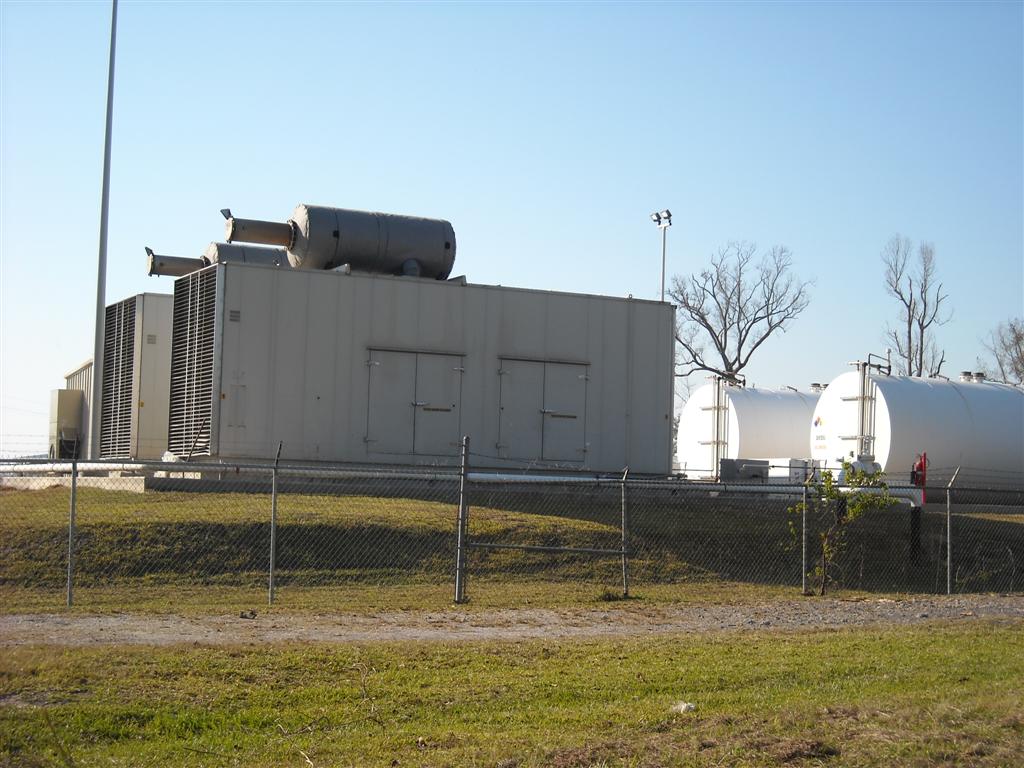

Dargo,
finally got a picture of what you really need. :D
