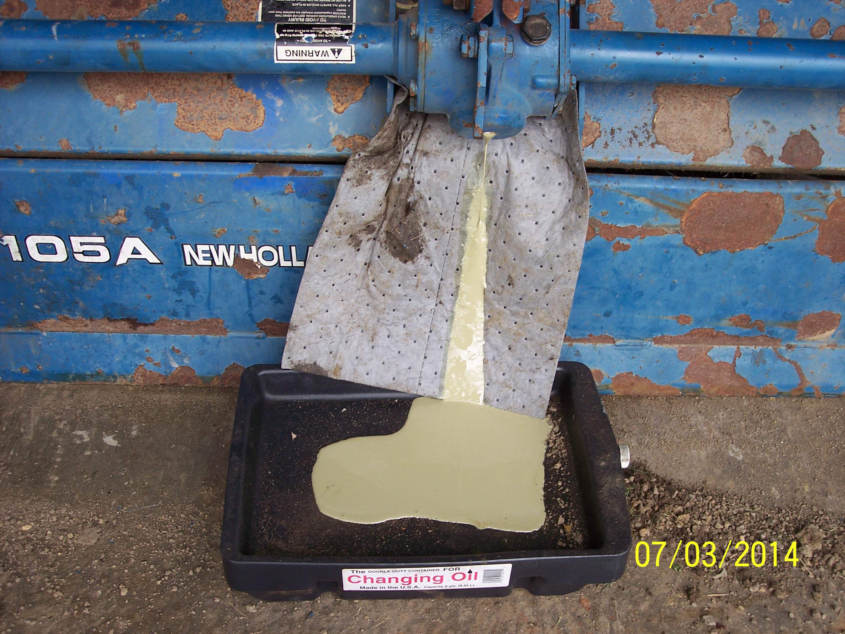

   / NH 105A Tiller Chain Tensioner #5
I borrowed it from a neighbor and thought I'd check the oil before I used it and found this:
The golden rule: "Do unto others as.........." My neighbor was tickled and I got to use his tiller.
