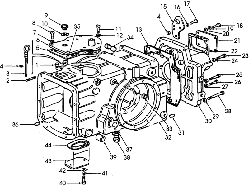

I have spent the last 30 minutes trying to find the hydraulic dipstick on this tractor. The FEL has a little hitch and I wonder if the hydraulic fluid is a little low. Despite all efforts I can't figure out where to check the fluid. Can somebody help me. Thanks.
/ NH 3010 Hydraulics #2
It's #3, should be on the RH side of the rear axle center housing.

Well I have gone over that area with a magnifying glass......and there is no dipstick there. Called the dealer and they said some are up around the deck.....find nothing there either. Apparently these a made more than one way. Anybody else with a suggestion? TIA
No it's not a compact. Finally had the dealer come by, He couldn't find it either. We finally started taking bolts out of the hydraulic area and found the right one. It's on the left side of the hydraulic case. Not on the back, but the left side about 5 inches from the rear of the case. There is not a dipstick, but it is like you see on a gearbox. You take the bolt out and the fluid comes out...just like on a gearbox. Fill through the same hole....just like a gearbox. Strange to me (and the dealer was also surprised). Didn't need any fluid. At least I know how to check it now!! Thanks for the interest.

Thanks for sharing your info. I've been searching for the dipstick and fill bolt for my 3010 for a couple of days now! The owners manual clearly shows a dipstick and fill bolt near the PTO engage lever.
As for the difference between the 3010 and 3010S, Near as I can figure, the 3010 was made back before New Holland was bought out by Ford. When the company became Ford New Holland, they produced the 3010S, which was essentially the same tractor with just a little less hp. I think the dividing line is somewhere between '02 and '03.
/ NH 3010 Hydraulics #11
Found it right where you said it would be. Thanks! My bolt has a little dipstick on it
