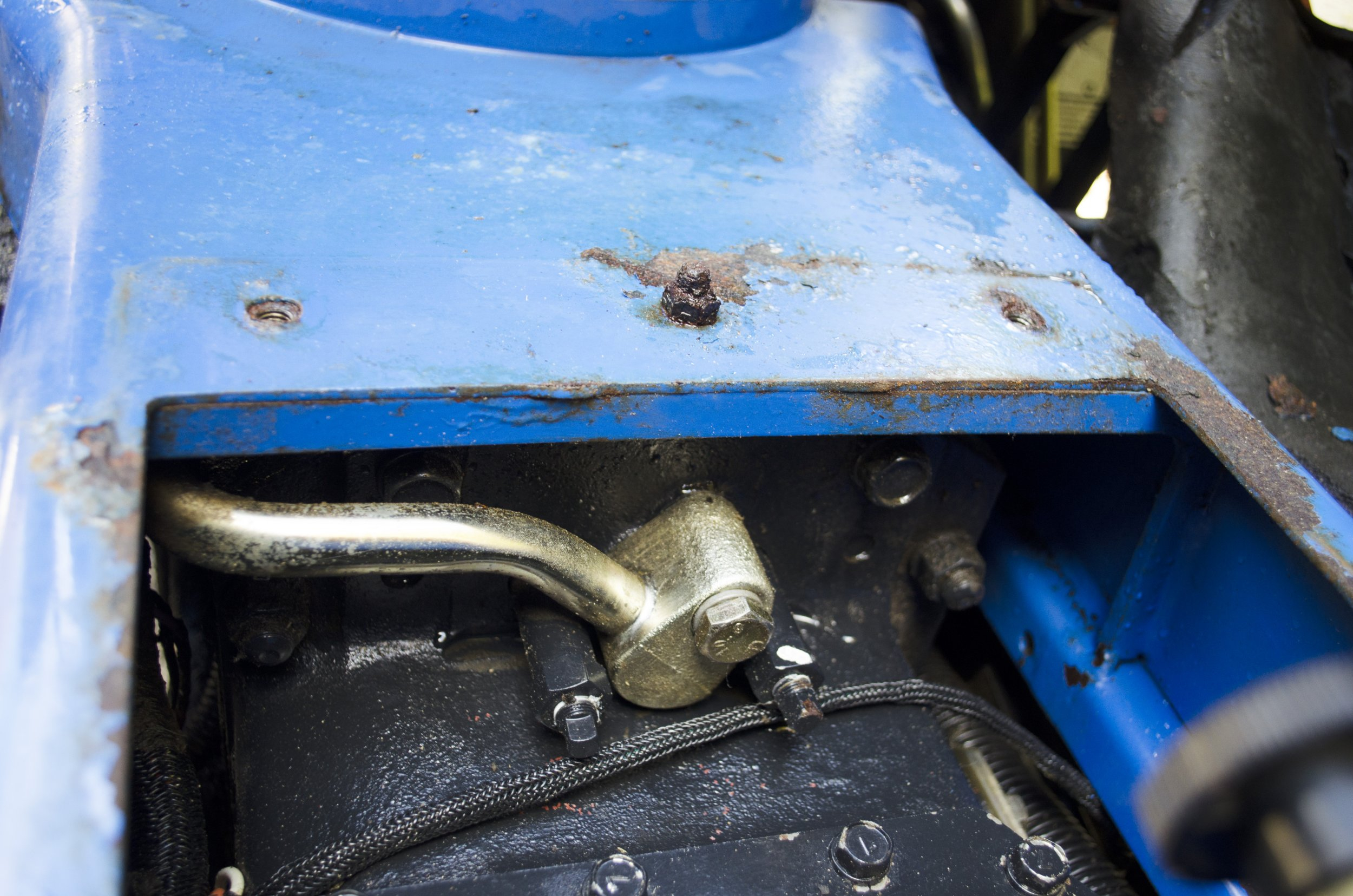

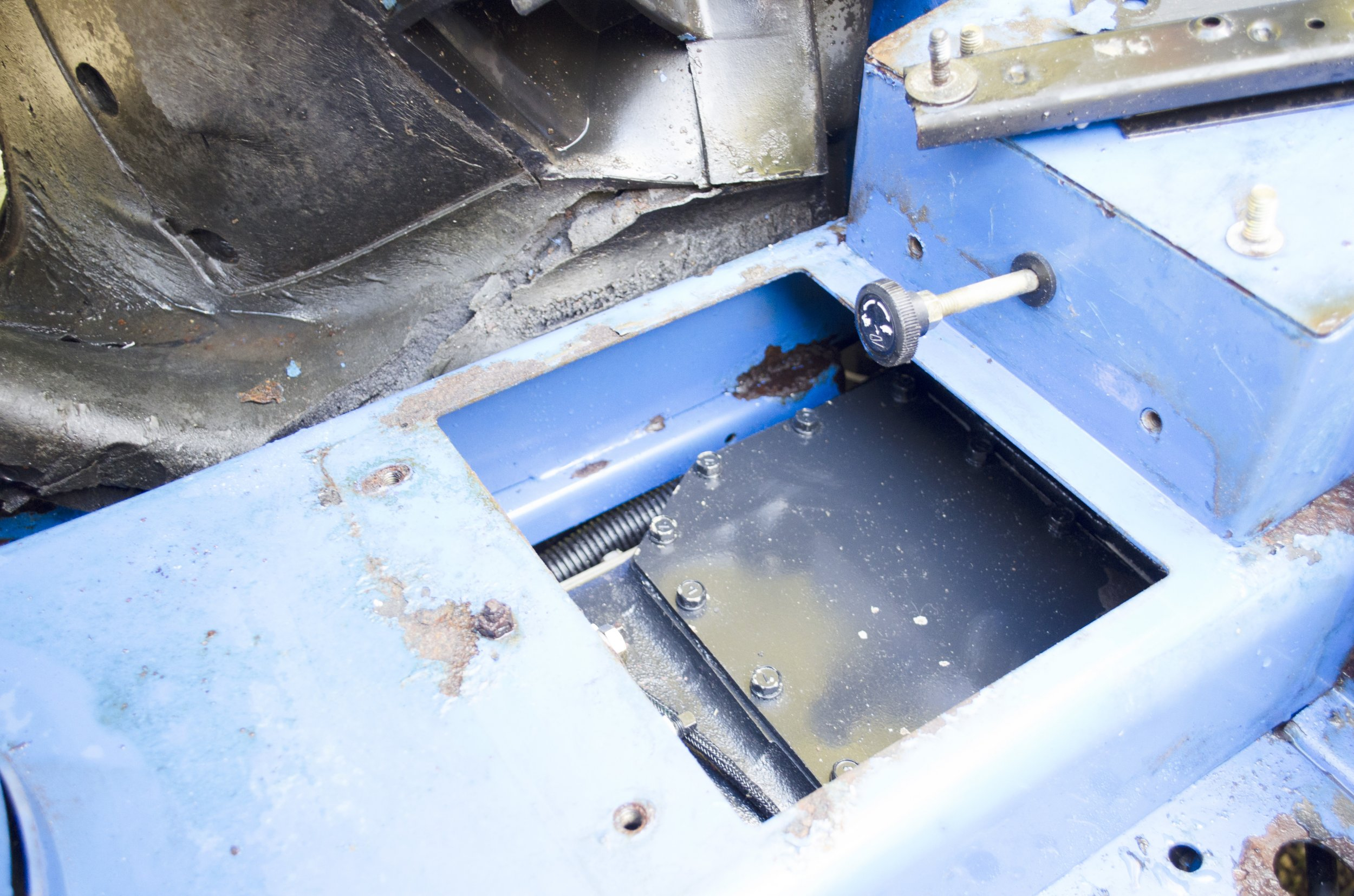

Found Source of Hydraulic Fluid Leak. After many brake-fluid flushes and pressure washes I still could not find the source of the fluid leak which was leaving trails of fluid wherever I went and was draining the fluid reservoir below the dip stick. All I could determine after all these cleanings was that it was probably coming from higher up which forced me to bite the bullet and pull off the rubber mat from the driver platform. Getting the mat off was not an easy task. I eventually had to cut the mat in a several places. Even before getting it off, I knew that it was a water sponge and a rust incubator [before putting the mat back I performed rust removal procedures, rust inhibitor paint, and a NH-blue top paint, but that doesn’t solve the long-term problem that the mat causes.] Once the mat was out of the way, I was able to open the rectangular lid on the raised platform between one’s feet. The first photo shows the lid removed, and the second photo shows the two nipples that were supposed to close off the hydraulic fluid. [Does anyone know why those nipples are there?]. You can plainly see that the right nipple was standing out too far, it was so loose that I could rotate it with my fingers. The other was somewhat tighter but still not tight enough to prevent leaks. Both nipples were spewing hydraulic fluid when the tractor was operating, and drips kept coming down when the tractor was parked. After adding new Teflon tape, tightening down the nipples, and putting things back together, there have been no more hydraulic fluid leaks!!! At 78, I am not sure how many more times I can or want to crawl under my beloved NH tractor and fix things.

I wonder if those two plugs are the transmission pressure test ports?
