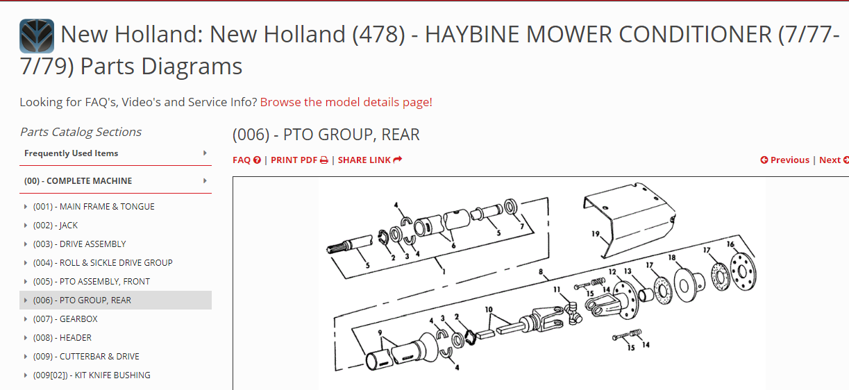

I'm working on making my own friction discs before I weld it
   / NH 488 Slip Clutch #12
This is really poor advice. But thanks for trying.
Have you worked on a NH slip clutch like this before? They are something special!
488 slip clutch also looks fairly simple to me very similar to other slip clutches I've worked on. Friction disc PN is 127434 @ $103.33 ea

So let's get some things straight here! It is interesting how NH calls them 'friction' discs and in the picture above they are clearly illustrated with texture different from the rest of the clutch.
However upon removal of the discs they are just a 'special' (NH dealers words, not mine) type of metal with no friction material on them. Now doesn't that just mess with ones mind? How is (smooth) metal on metal on metal going to hold? Why have a $160 special metal disc where you could easily have a $5 disc of brake pad material?
Now this mower is new to me, is in rough shape, and has many parts already thrown at it by me and the previous owner. The rolls are near the end of its life and I'm concerned about spending too much fixing little things, like over $300 on the slip clutch.
Anyways when I removed my slip clutch on my 478 to try it on my 488 I noticed the special friction discs were conical where my 488 discs are perfectly flat. Maybe this is how they get friction with extra tension on the clutch.
Well the story ends good. The clutch was fine the whole time. It's the female end of the rear PTO drive shaft that is broke!! Popped the one of my 478 and onto the 488. In less than 2 minutes I'm running again!
According to NH 478 parts catalog 478 & 488 utilize the same friction disc(127434).
