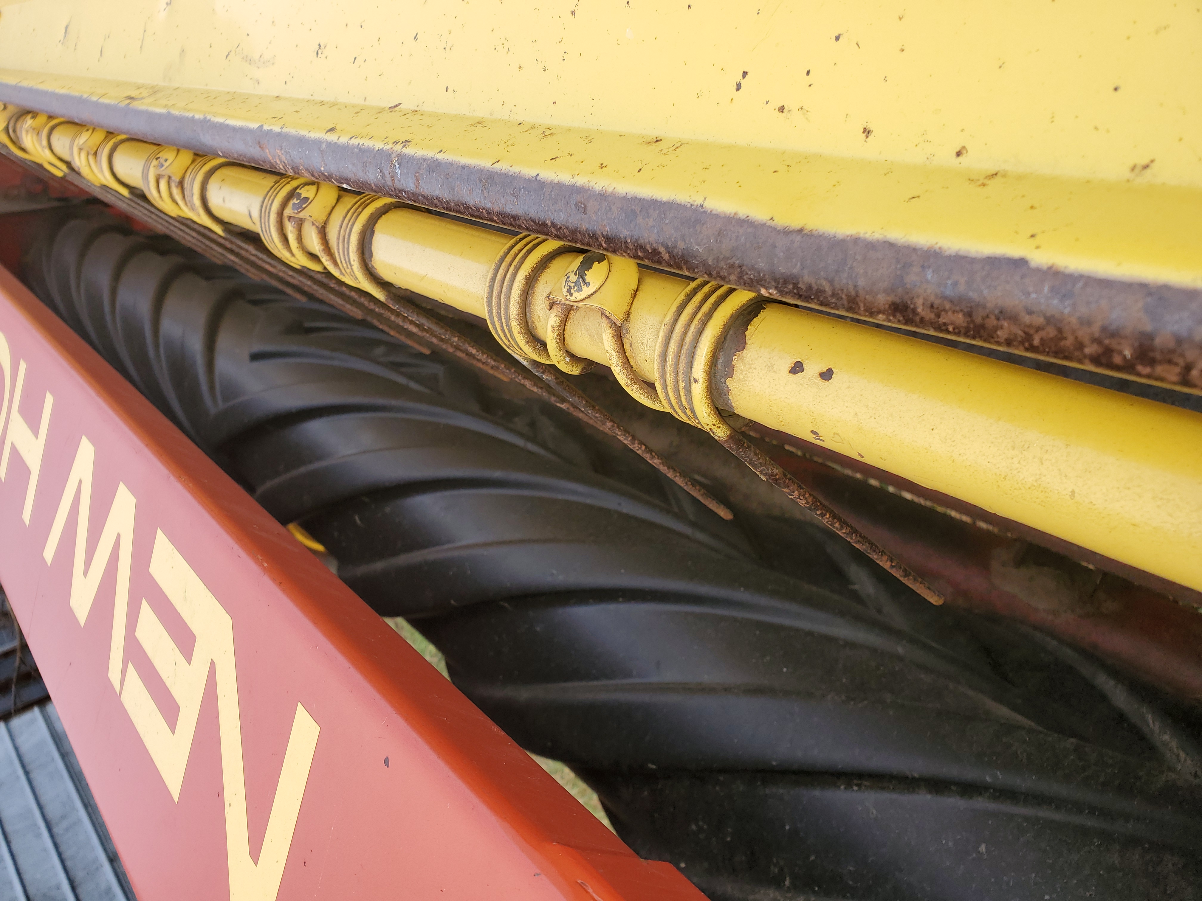

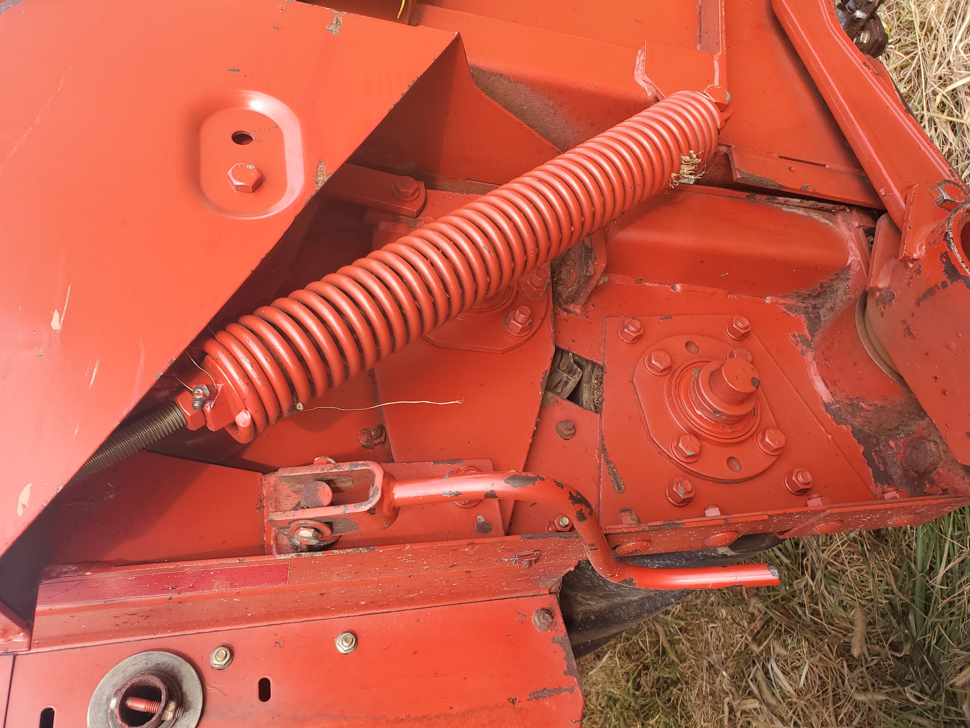

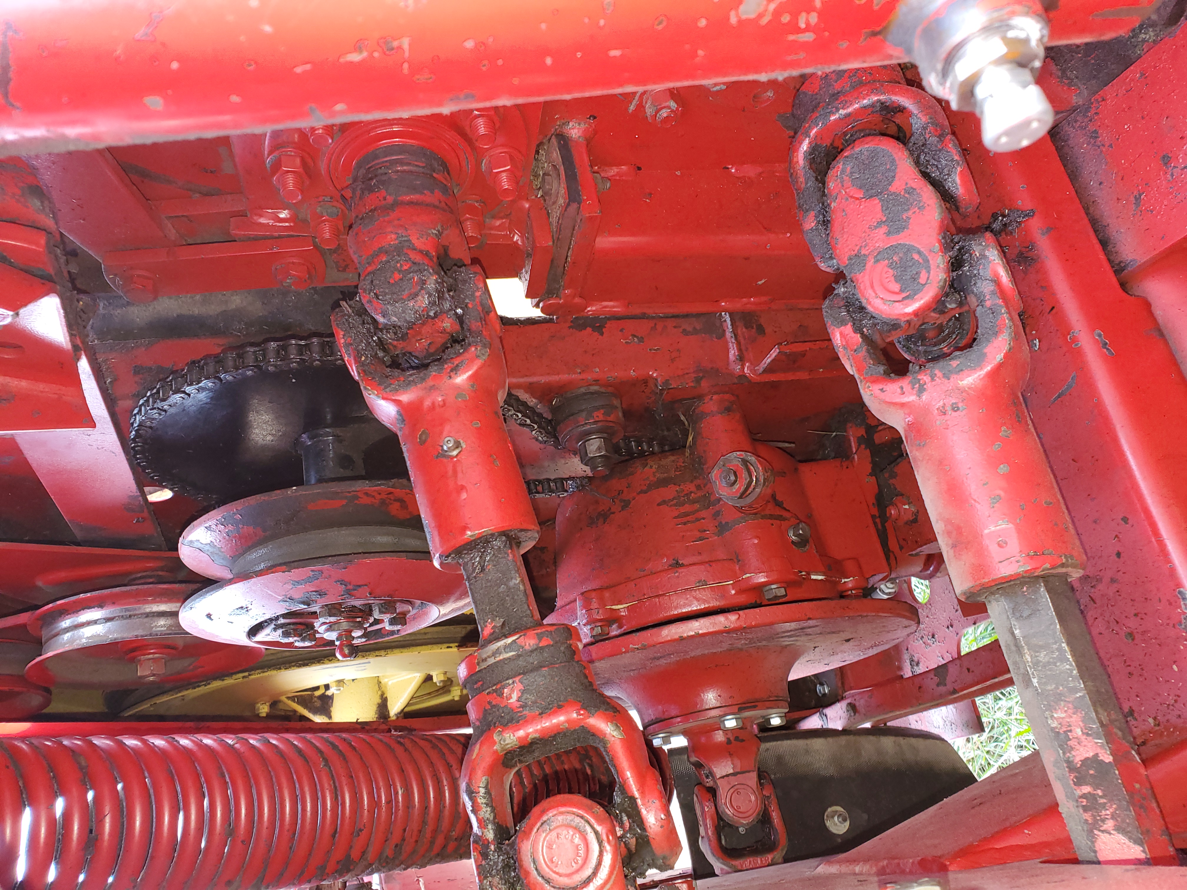

I'm now the proud owner of a NH 492 haybine.

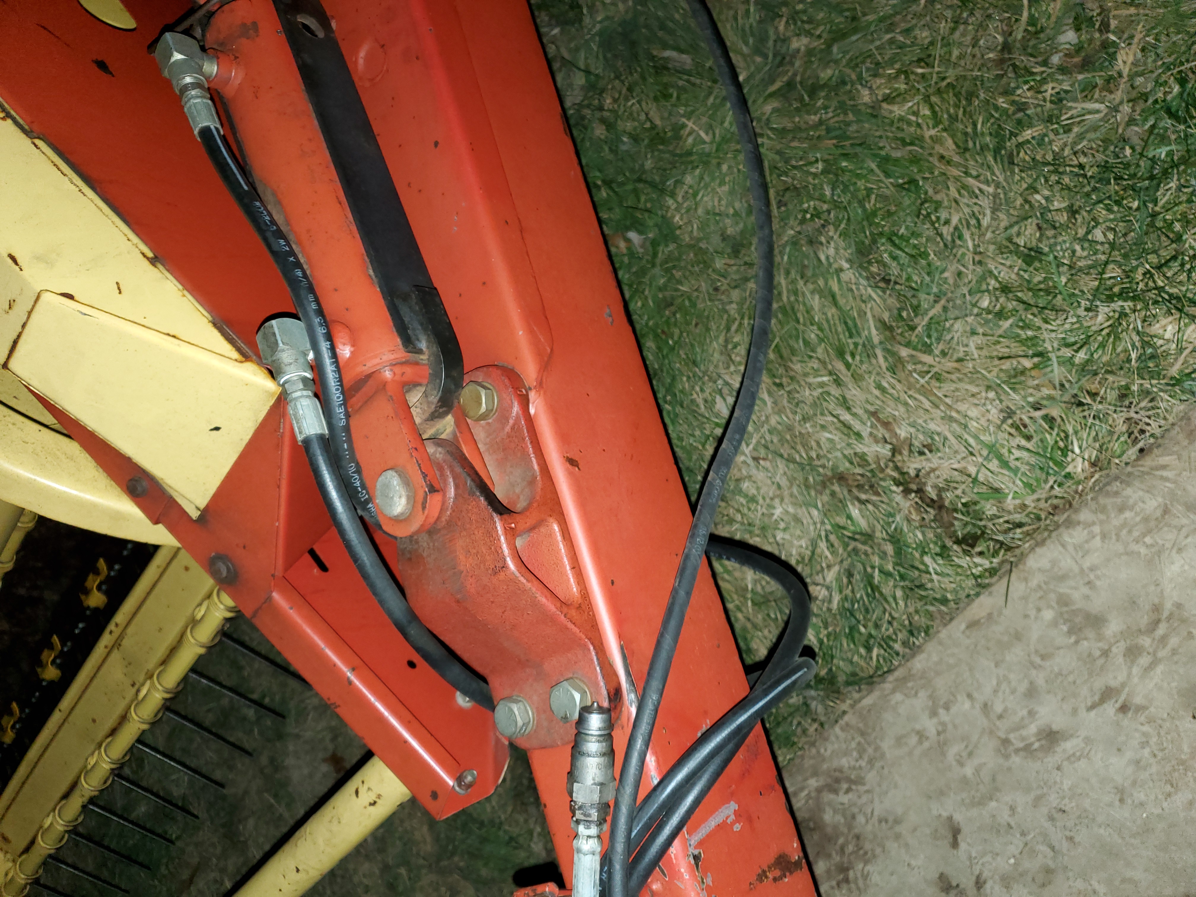

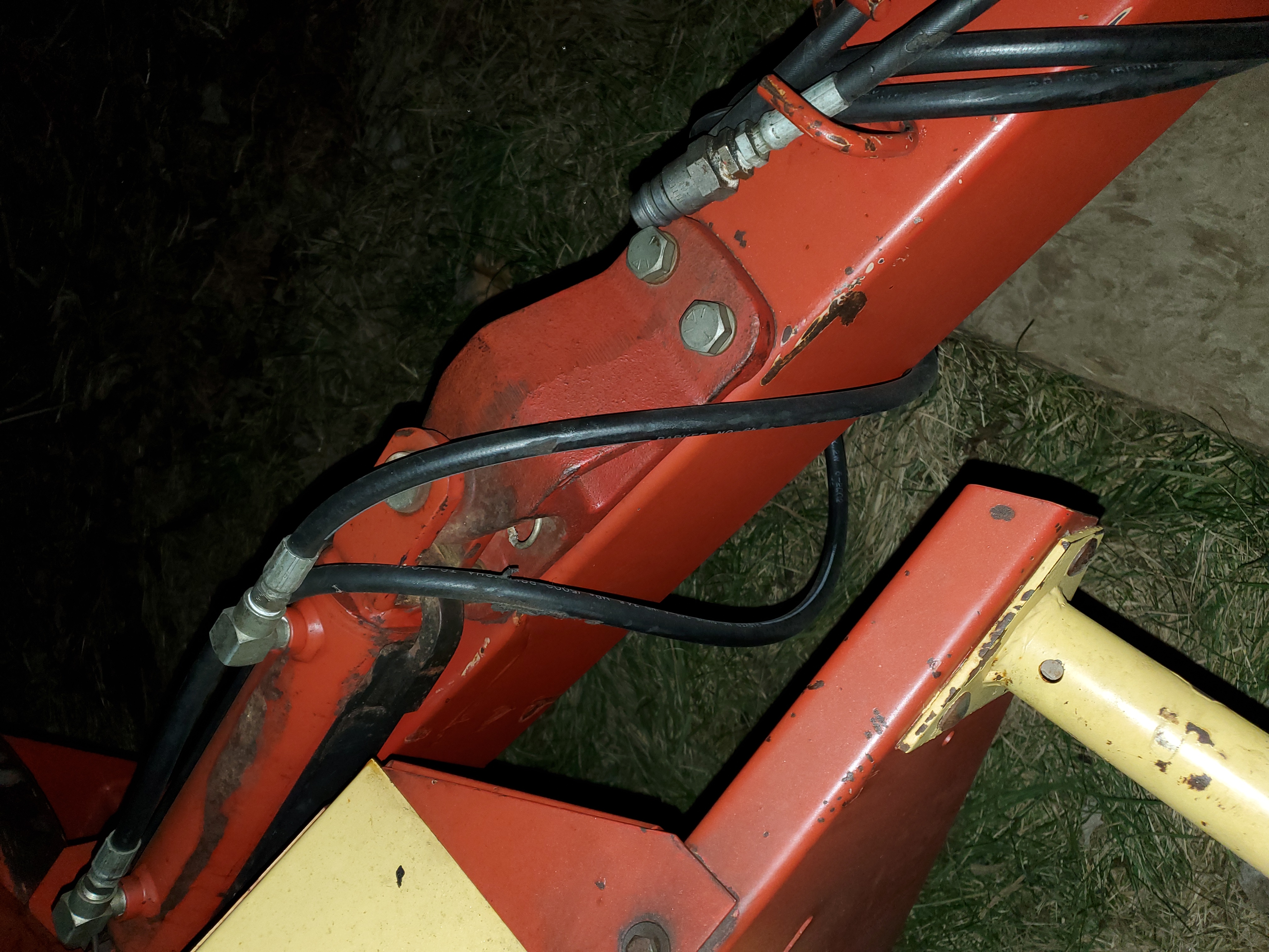

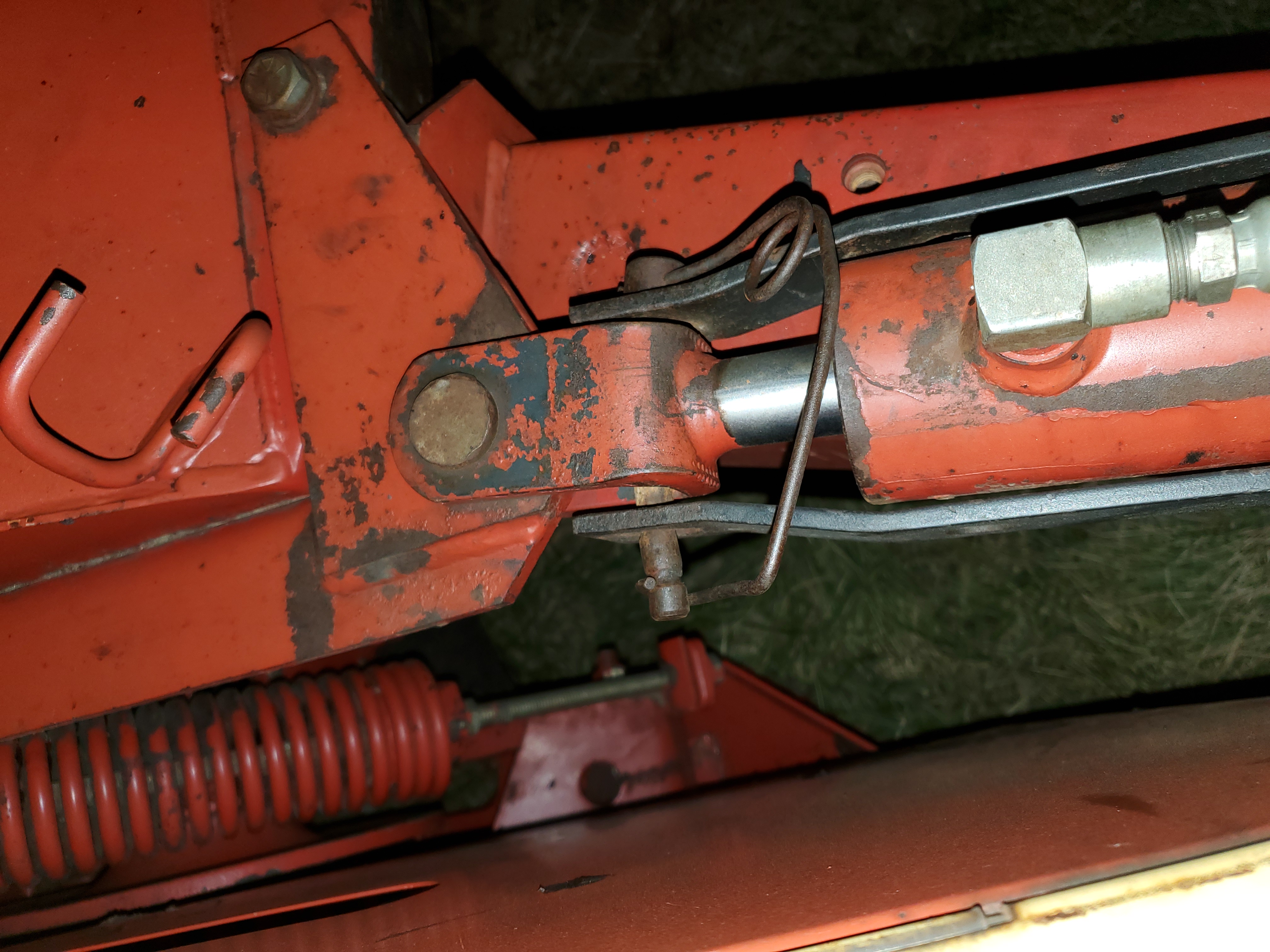

That looks nice, can you post a couple more pictures of the hydraulic tongue swing mechanism? Considering copying something like that to go on our mower conditioner.
Thanks
Aaron Z
   / NH 492 vs NH 1465 mowers
Not a problem. These were taken in the dark, so might not be the greatest. Let me know if there's anything else.
20191221_231435.jpg20191221_231451.jpg20191221_231525.jpg20191221_231530.jpg20191221_231534.jpg
In the first picture here, you can see the hose coupler has a flat point instead of a ball. Haven't seen that type before. Will these be fine for use, or should they be changed out for a ball valve type? Tractor has ball valve type.
