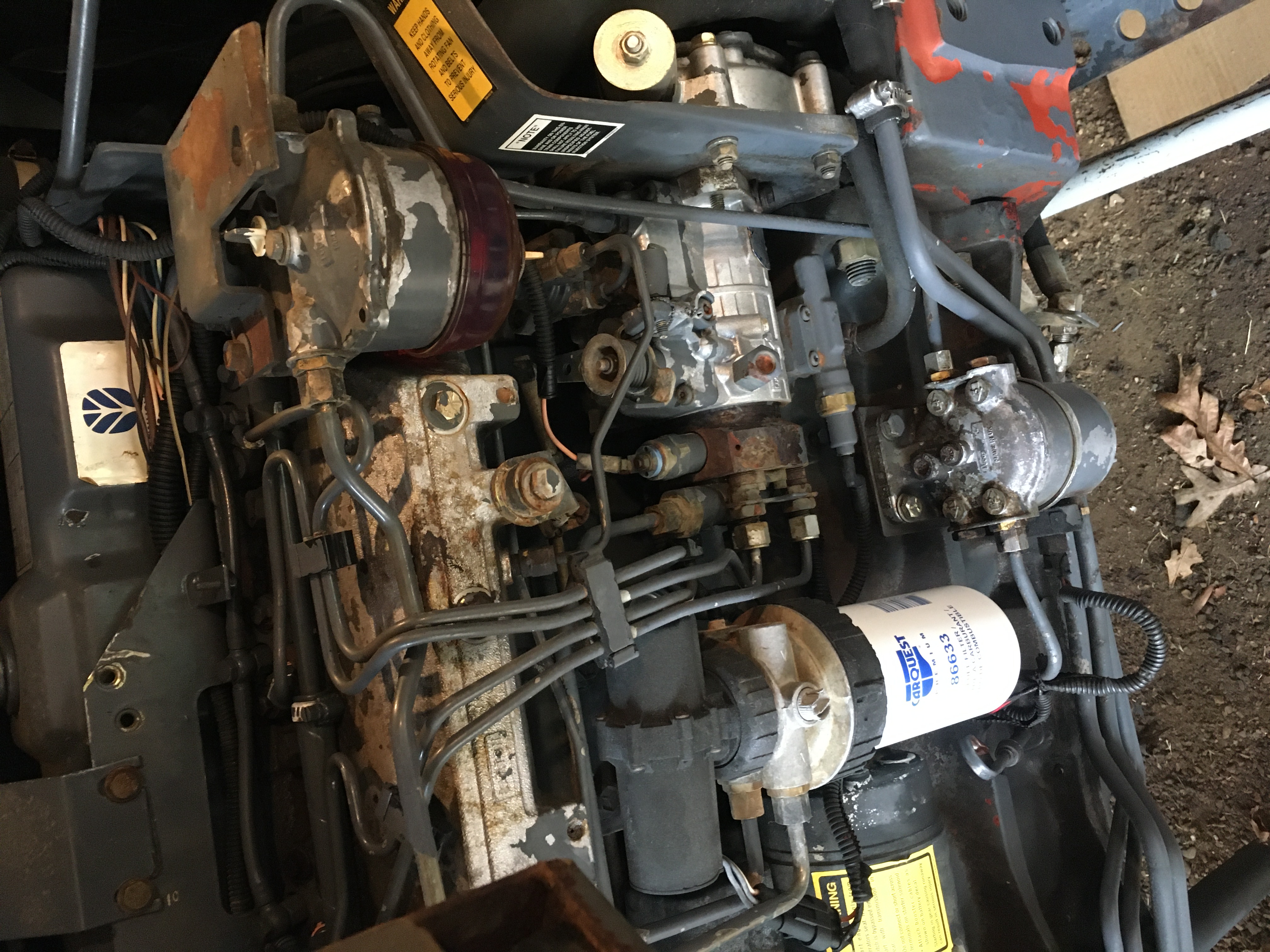

How do I quickly determine if tractor is emission controlled? Thanks
   / NH 6610S Emissions #2
If the fuel filter is retained with a large gray or black plastic ring the engine is emissionized. If the fuel filter is a conventional spin on element it is not.
Thanks!!! Thanks
   / NH 6610S Emissions #6
You appear to have four lines going from the injection pump - one for each injector. The tractor was manufactured from 1994 to 2003. I think it unlikely there is any emission control. A further indicator would be the throttle. If you have a mechanical throttle as opposed to computer controlled it is even less likely to have any emission control.
   / NH 6610S Emissions #7
You are misinformed. You can go to the New Holland online parts lookup and see the various parts diagrams for emissionized and non emissionized 6610S engine components. All Tier I and II as well as the vast majority of Tier III compliant off-road diesel engines use conventional mechanical injection pumps.

It has mechanical throttle.
