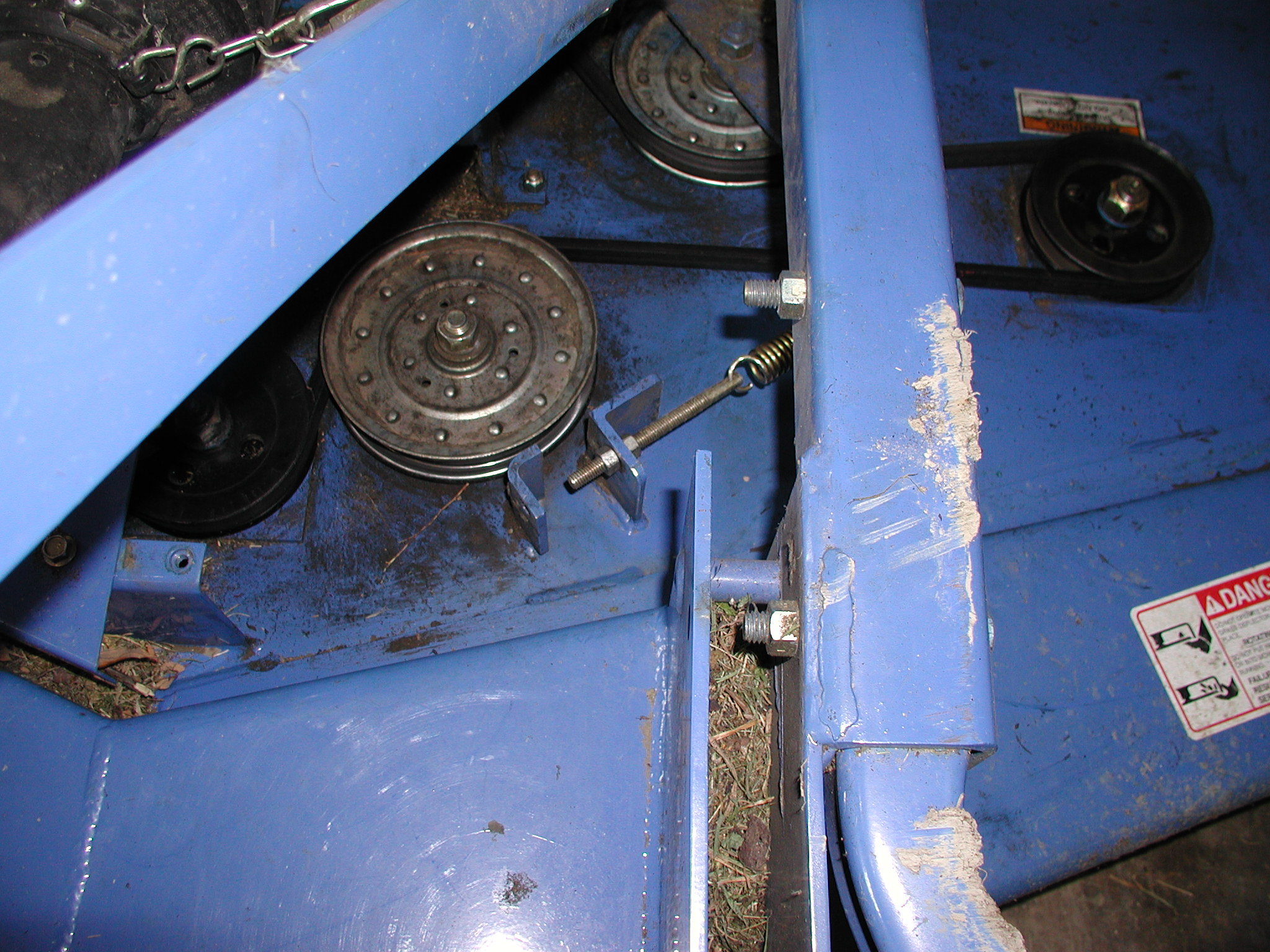

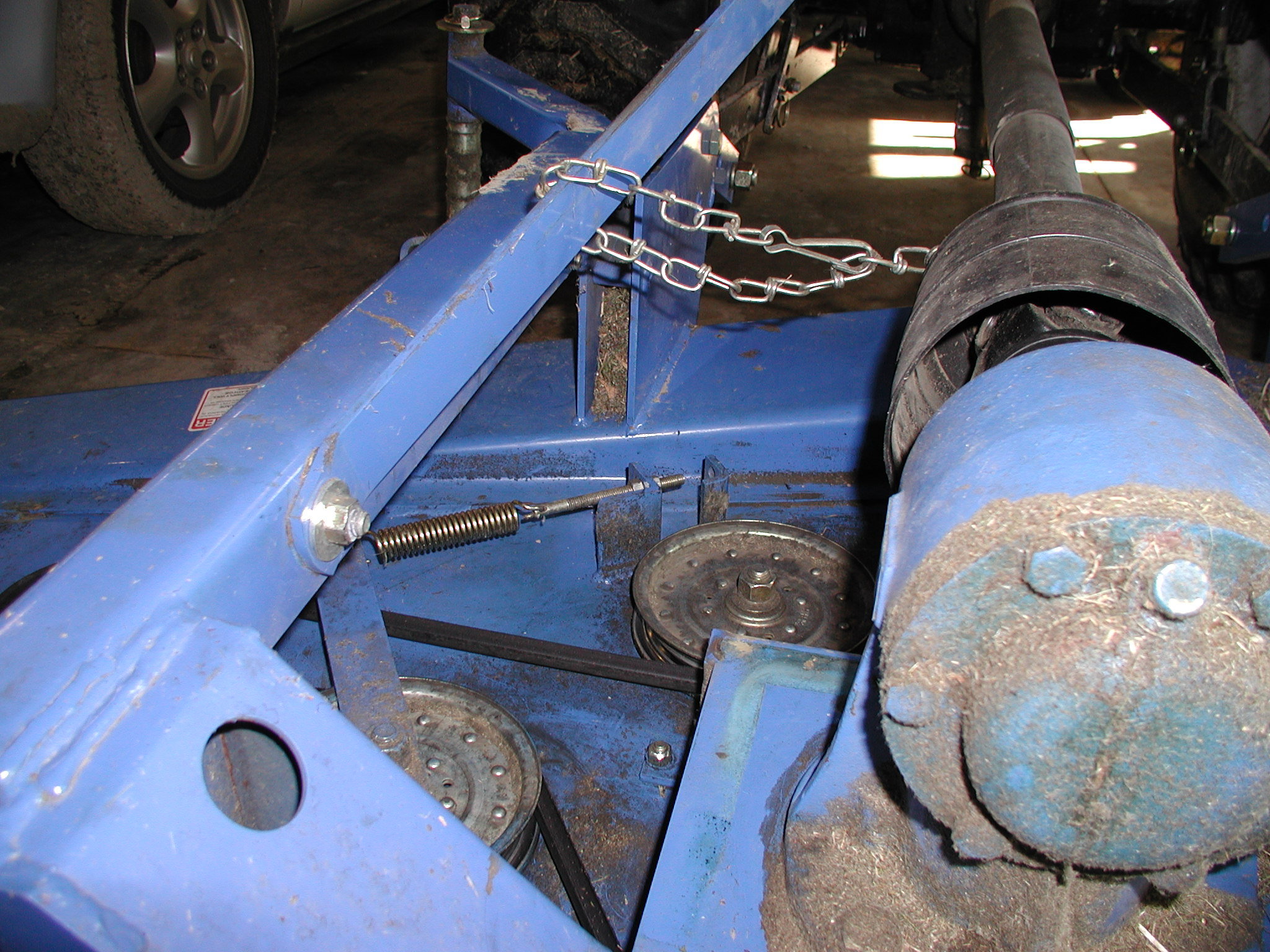

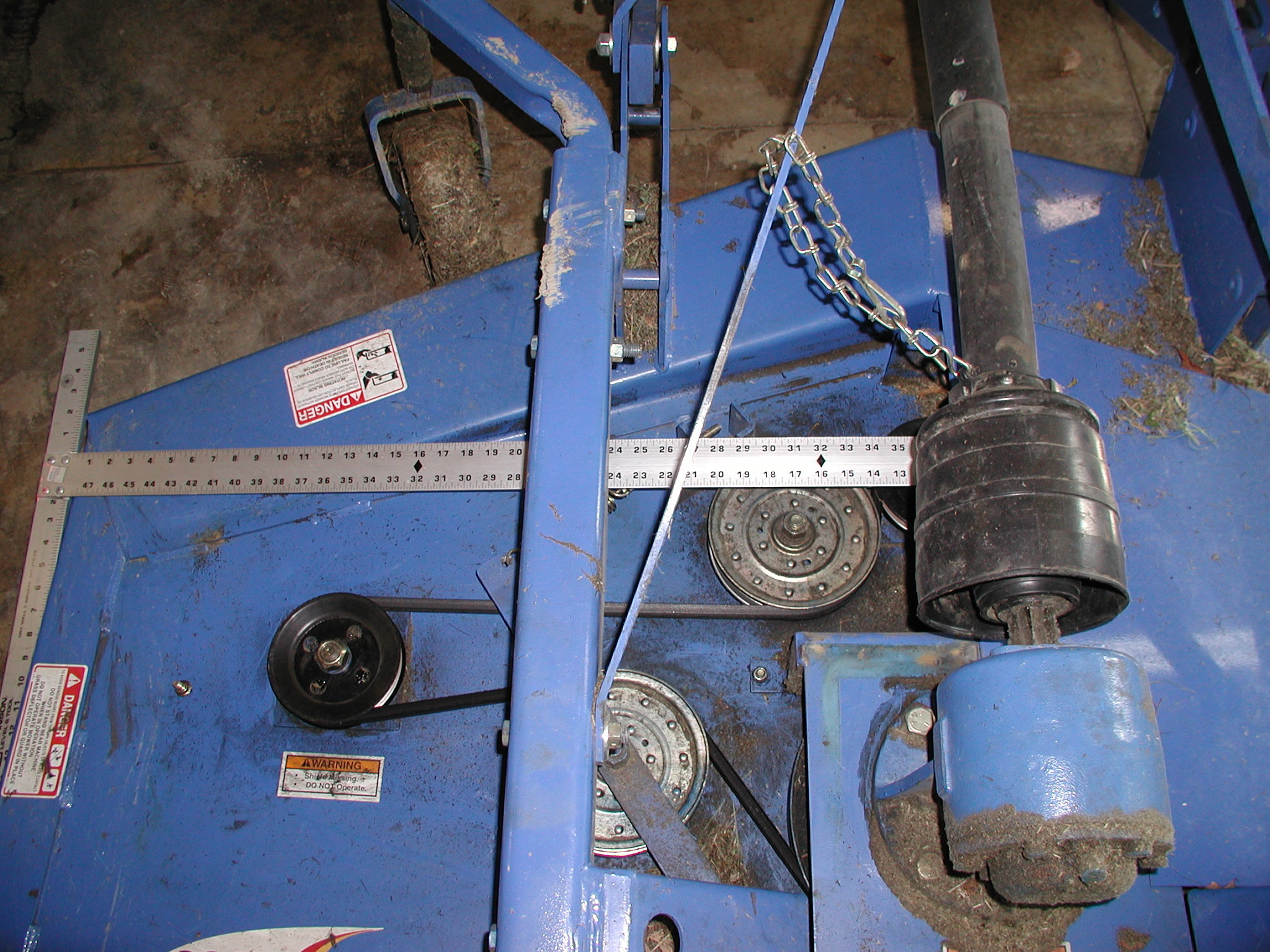

Rayrla - Sorry so long on this response (we're putting on a 1300 sq.ft. addition to the house, and the mower hasn't been a priority). The only (I think) measurement of yours that I wasn't clear about was the 4 7/8" dimension, but it may not matter. At your 7 5/8" dimension, I get 9", and for your 24 3/8" dimension (which I think is the most important to my problem), I get 28 3/8"! I'm now going to try to insert some pictures (?), and I think it should be obvious to you that my anchor is in a different location than yours. If I'm successful with the pictures, you will see my TWO anchor points ("LAPs"). The one in use is the one the dealer added - the other one is the OEM.
Well, I can't yet figure the picture thing out. If you're willing, you can PM me with your email address and I'll send them to you (I know how to do that). If not - I understand. I'll try and do a little research on how to do the pictures on TBN.

OK - Let's try this.

Sorry, Welshman. The measurements that I posted were wrong. I' ll try again.
All measurements are to the center of the hole that the adjustment rod goes through in the link anchor.
First, your picture 1, from left mower deck top....29".
Second, your picture 2, from LAP up to first raised surface of mower deck...2 7/8"(perpendicular distance from this surface to LAP).
Third, from gearbox support front left leg to LAP 9 7/8". If I remember correctly, in your picture 2, go from LAP to edge of gearbox support plate.
From your pictures, it appears that your OEM LAP is located close to mine.
If any measurements are unclear, let me know. Perhaps I can get some pictures.
