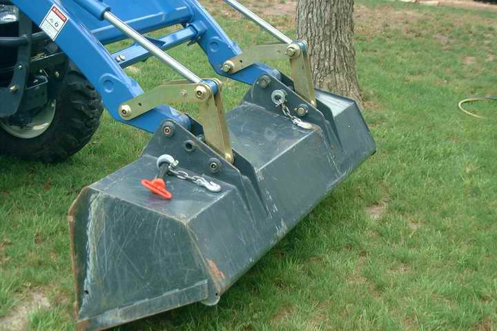

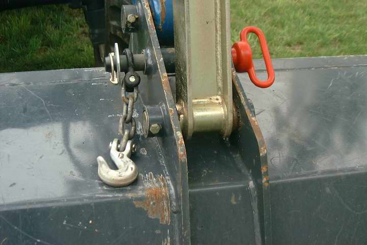

Here are the pictures. This will work only on the NH heavy duty bucket that is not a quick-attach. If you roll the bucket up, you essentially have the full lift at the pins which is more than on the top lip of the bucket.

That is a great idea and I may go that route. :cool: No problem of the pin getting hit by any of the FEL links on the bucket when curled all the way forward or backwards?

Thanks for the pics.. Looks good to me.

I guess that is possible, but you could shorten the chain to fewer links if you think it might get caught/pinched. It's also easy to remove them, but you'll end up needing them when they aren't installed if your luck is like mine.:eek:
Now I see you asked about the pin...
No you won't hit the pin. There is a tube all the way across anyway. The only chance of a pinch is if the chain and hook flops around.
   / NH Heavy duty bucket chain hooks #15
I put longer chain on mine - never had any problem with them hitting anything -- I was able to stretch the hooks so they would almost touch in the center of the bucket - made it real handy too when letting them hang down behind the bucket for lifting. Then I went and cut off the brackets to make a QA bucket so I now I gotta re-config the jinman hooks.

As opposed to some of the home designed riggings I've seen here, I have nothing to say about your setup but "great job"! What a great job of thinking how to solve a problem without making any permanent changes or modifications.

DARGO: Thanks for the compliment. Those holes were just "begging" to be used for something.
