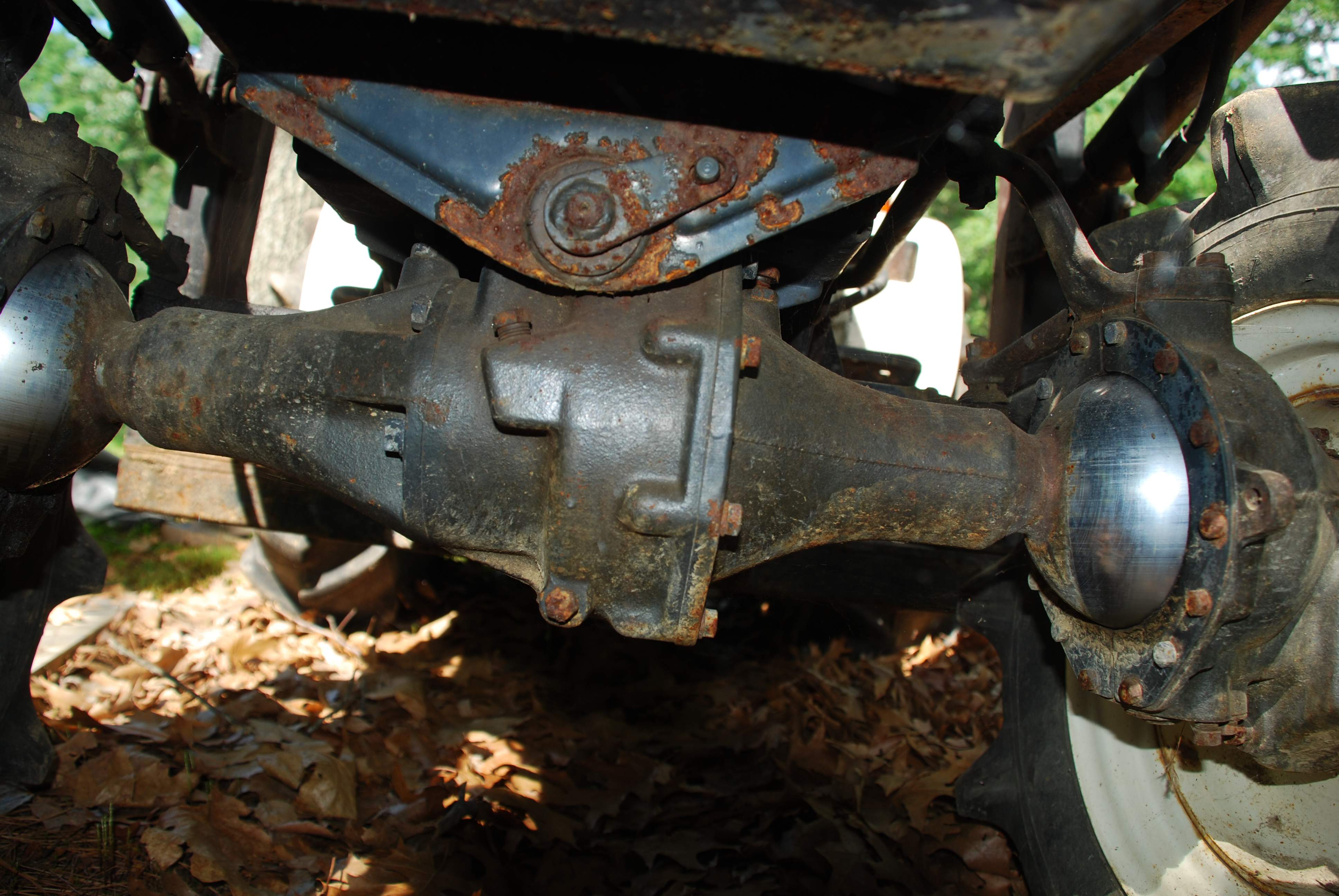

I guess this must be the place that the take off gets installed, but there's not much room for it with the FEL frame in the way.

I found a starter switch on ebay, I know that you were looking for one. Bolens Iseki 1502H Start Switch | eBay The front PTO adapter installs between the front bumper bracket and the radiator grill like in the photo below. I wouldn't mind the belly mower, but with my R1 ag tires, I would just tear the lawn up. I do want to eventually get a 4ft brush hog. I know that they are all over craigslist, and new at TSC.

It should be behind the small white plate that is below the radiator screen. You will have to remove the two bolts on either side to expose it.
