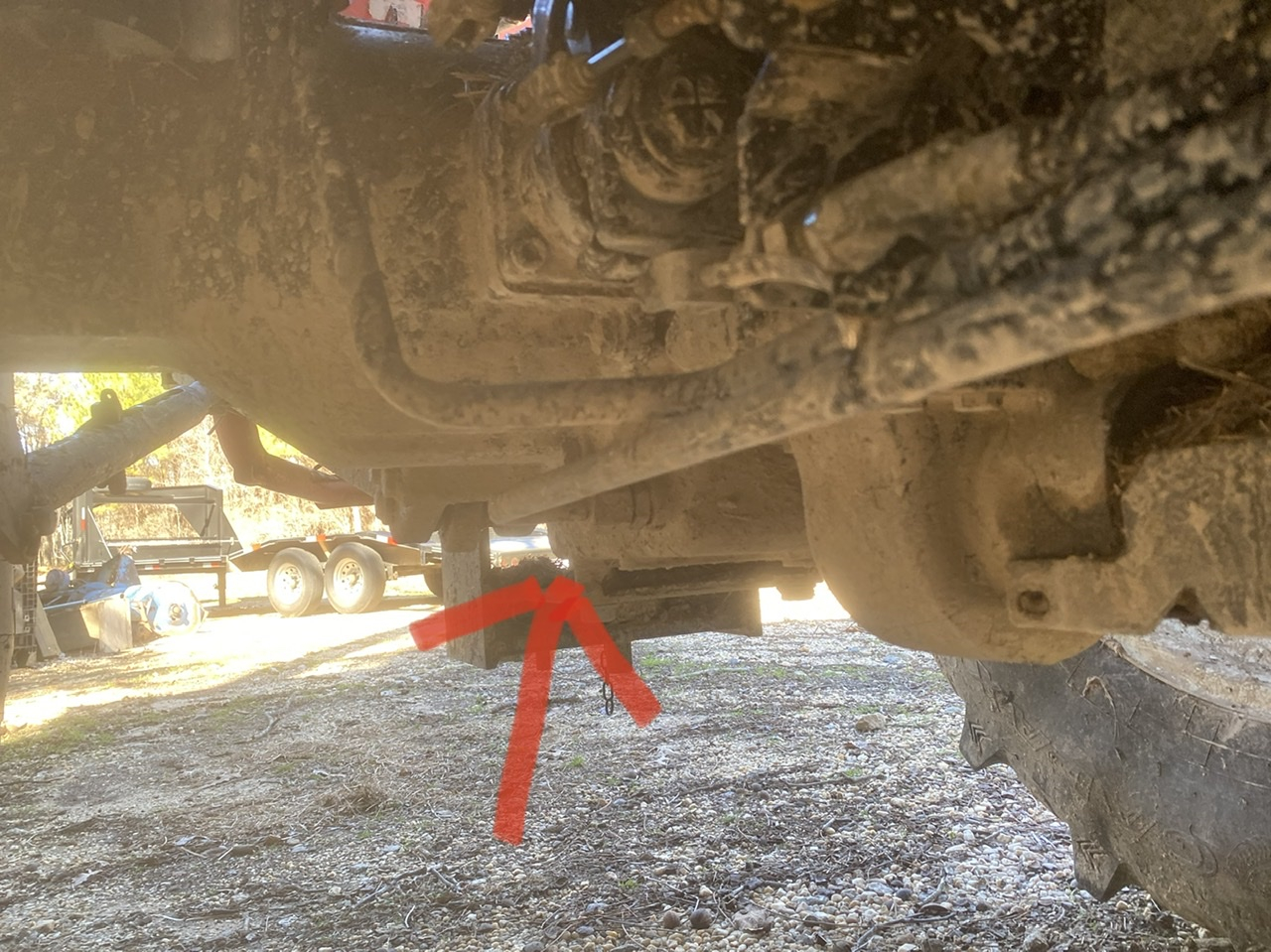

I looked at the tractor today I believe I see the current return circled in red.

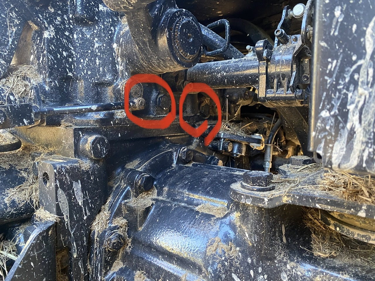

I also see two either bolts or plugs. Any idea if these hold something in place inside the housing or are just plugs? I really don’t want to pull them and drop something loose inside. This the the same

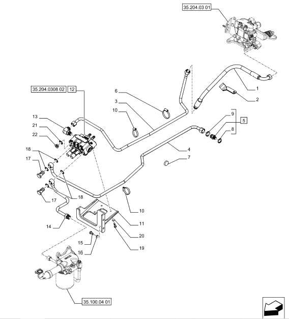

I'm back on this project and I wondering if I place a T where the front end loader valve returns to the case could I put the fluid there? I believe that would be placing a T between #4 and #5 in the diagram below. Does anyone see any issue with placing a T here and using this as my return? Thanks for the help!
