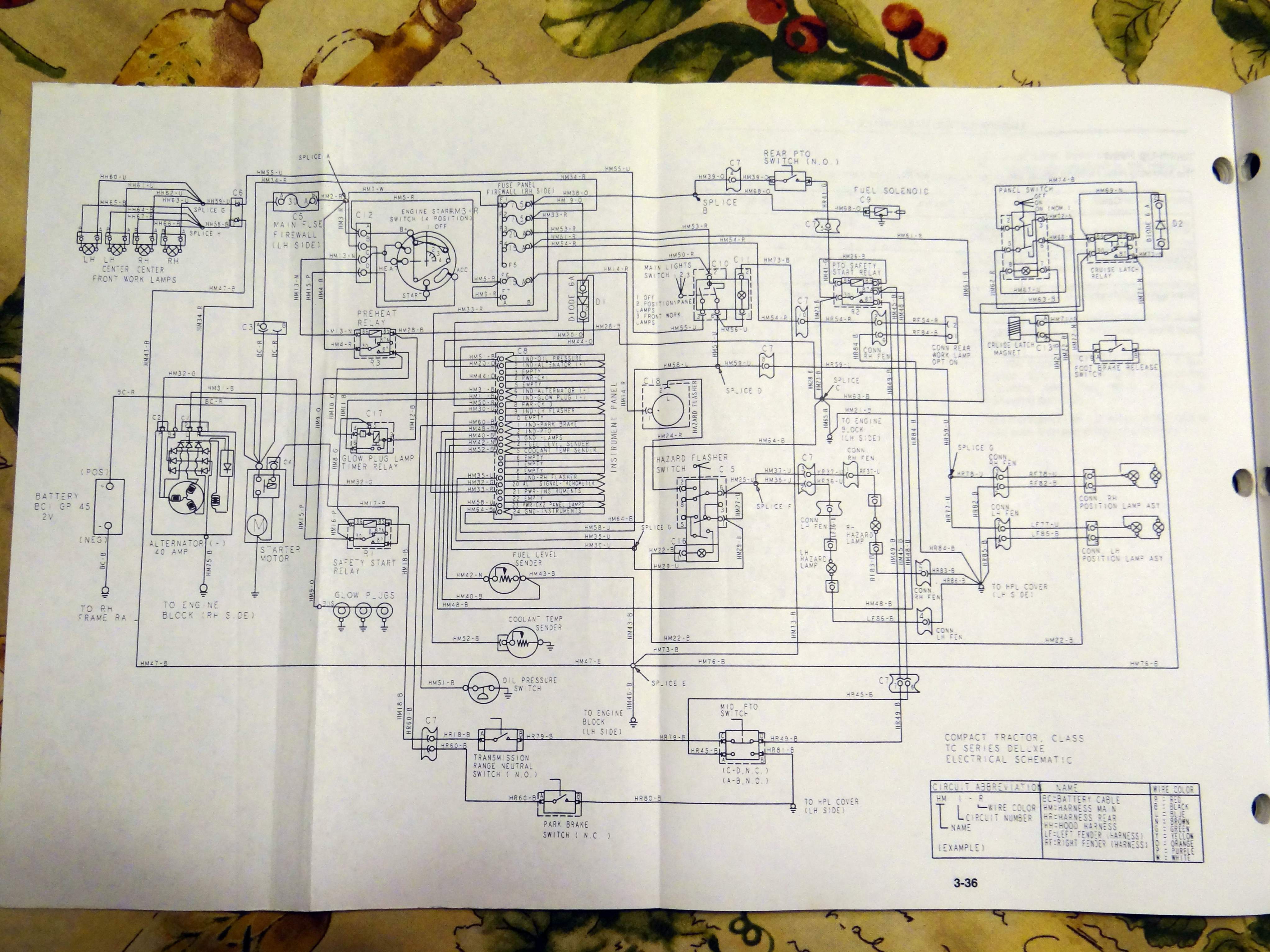

I could sure use some help here. Like the title says, I have a New Holland TC33DA, but I have an OEM manual for my previous tractor which was a TC33D. The year I traded was the year they changed the safety circuits, and the wiring schematic. I recently had an electrical malfunction in that circuit and after several days of fooling with it with an outdated wiring schematic, I gave up on it and took it to my dealer who kept it for five weeks only to change a fuse. I checked all the fuses first so I know that isn't what made the tractor stop to begin with. I don't blame the dealer at all. He was busy and he fixed what he found, but whatever caused the problem to begin with is still there. I really need a copy of the new schematic. I have even searched the net for a new manual, but the only ones available are used and $250+, and know one is guaranteeing what year models they will cover. Please, if anyone can help, I would really, really appreciate it, I can't afford to be behind another 5 weeks if the tractor stops again. I will be happy to provide any information I have on a TC33D if anyone needs something from the manual I have.

NH must have changed after that model. Both my operator's manuals have detailed wiring diagrams.

Randy......you are right on the money. Since there is a separate electrical service manual, it never occurred to me that NH would actually put a complex schematic in the operators manual of all places and give it to you for free. How stupid of me. You are my savior. Is there anything I can do for you? I am really greatful for your leading me through this one. Thanks again....Bill E.

Hopes this helps.

Thanks Paul. I really appreciate the time it took for you to post the schematic. R.E. Powell was kind enough to point out to me that I had a schematic in my Operator's Manual, but since yours is in a different format, I'm really glad to have it as well. You guys have both been great. Thank you so much. Bill E.
