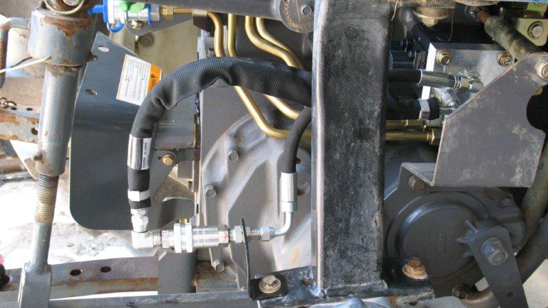

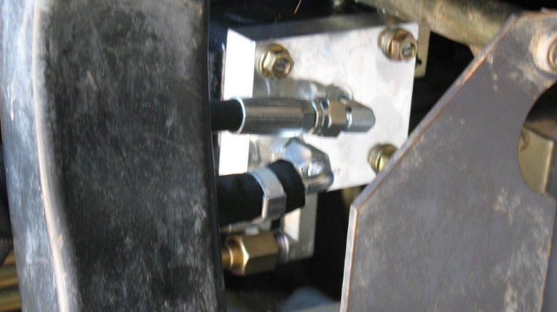

Woods makes a "Hose Kit" for backhoe plumbing or an attachment like a log splitter. It replaces the end block at the tank port on the rear axle (same area where rear remote valves go). You can install the block on top of the remote blocks you have there already. You would no longer use one of your remote valves to provide flow to the BH. If the BH is removed however then the hoses must be connected to one another to complete the circuit. The part number is1021867 for your TC40D. Only problem is it costs about $300, certainly not as inexpensive as a bungee cord but It is a very clean setup with easy access. Hoses remain connected when the accessory is not used, when using the implement unplug QDs and plug in the spitter or BH.
