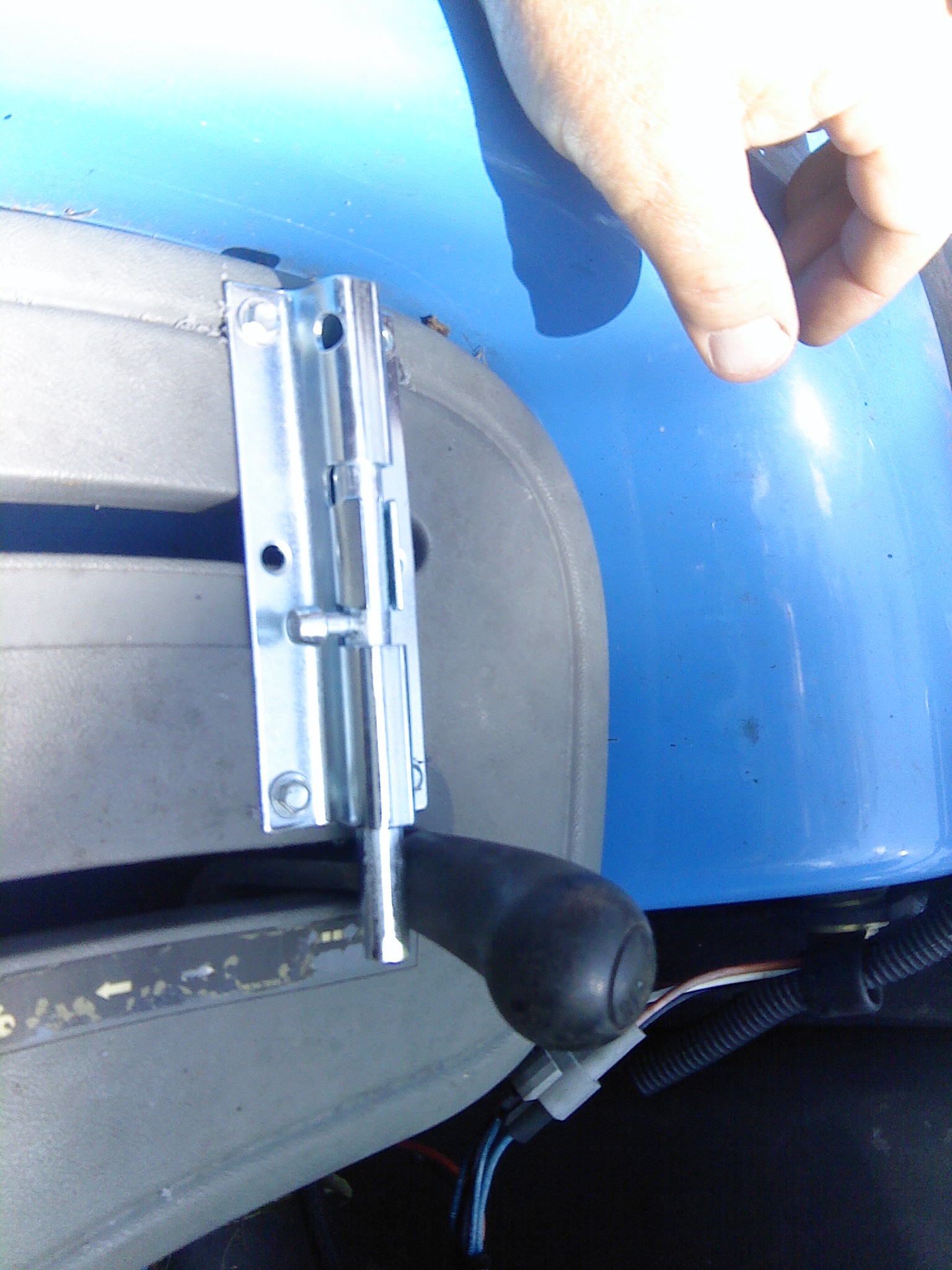

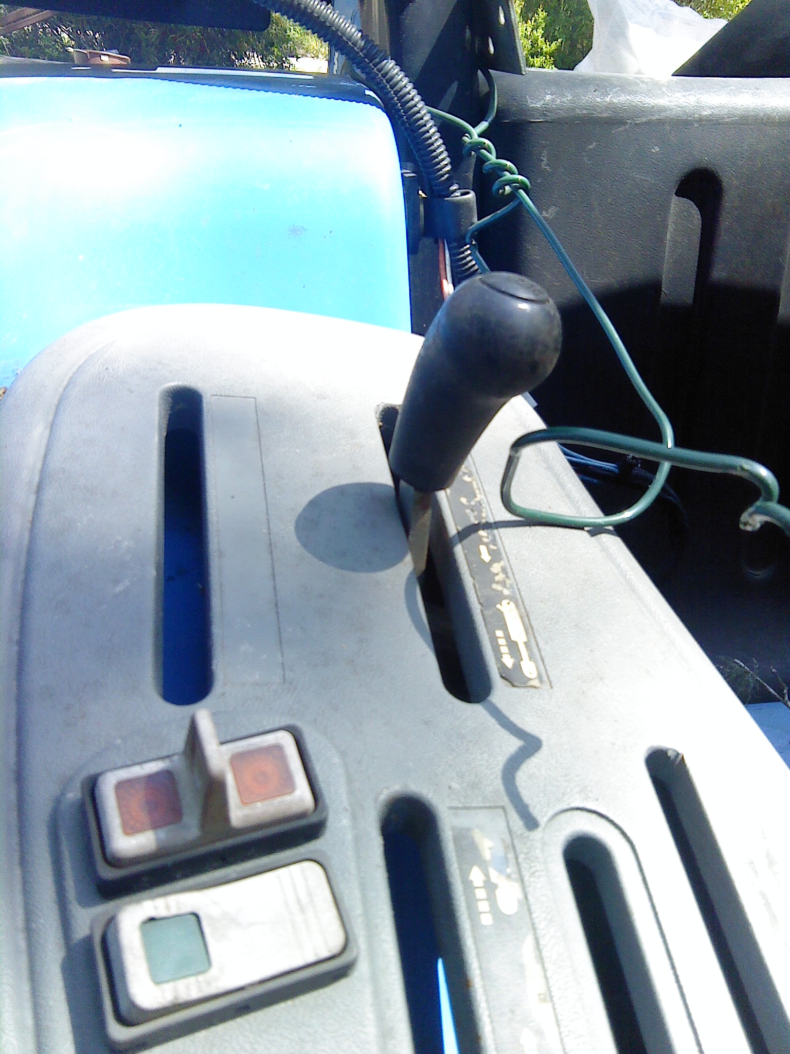

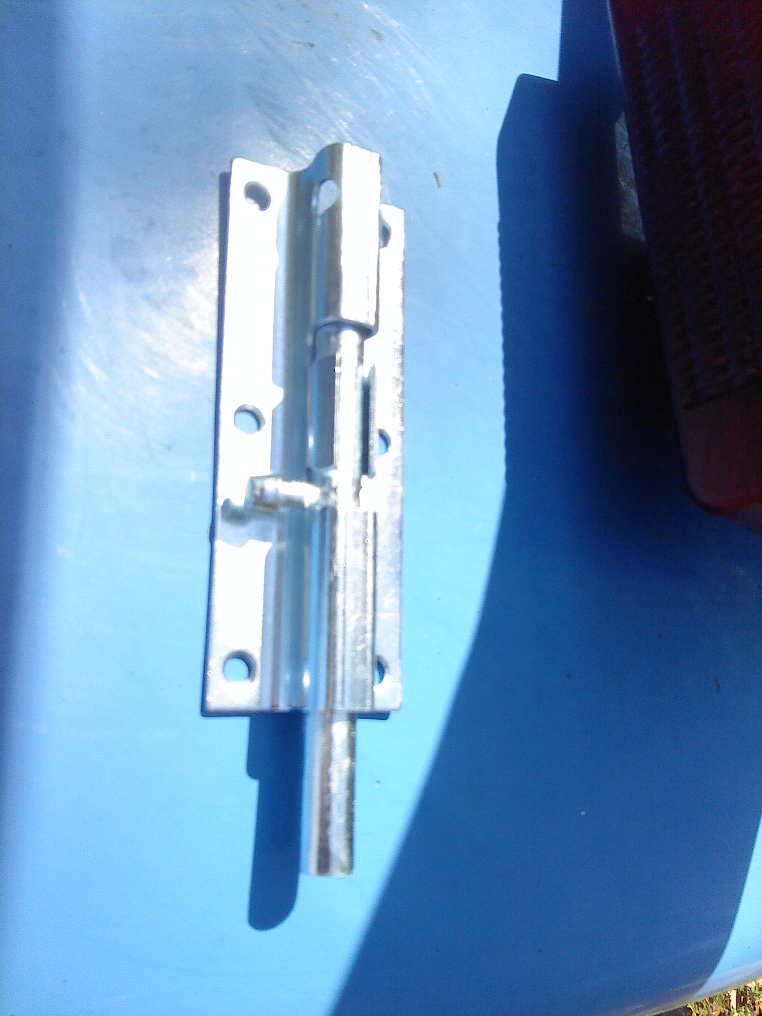

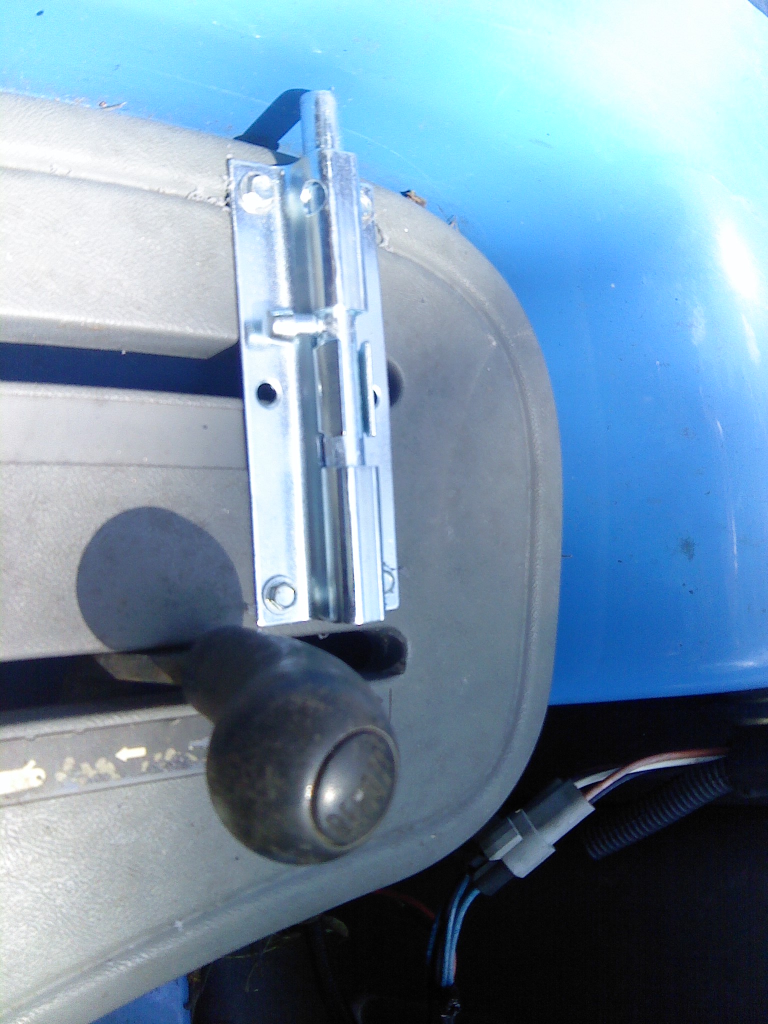

The Solution:
After getting the info that using the remote already installed and locking back the arm is the way to go - here is what we did
The first picture is what was there when we got the tractor - the rest are the solution.
The slide barrel bolt cost $6 at WalMart
Thanks all.
