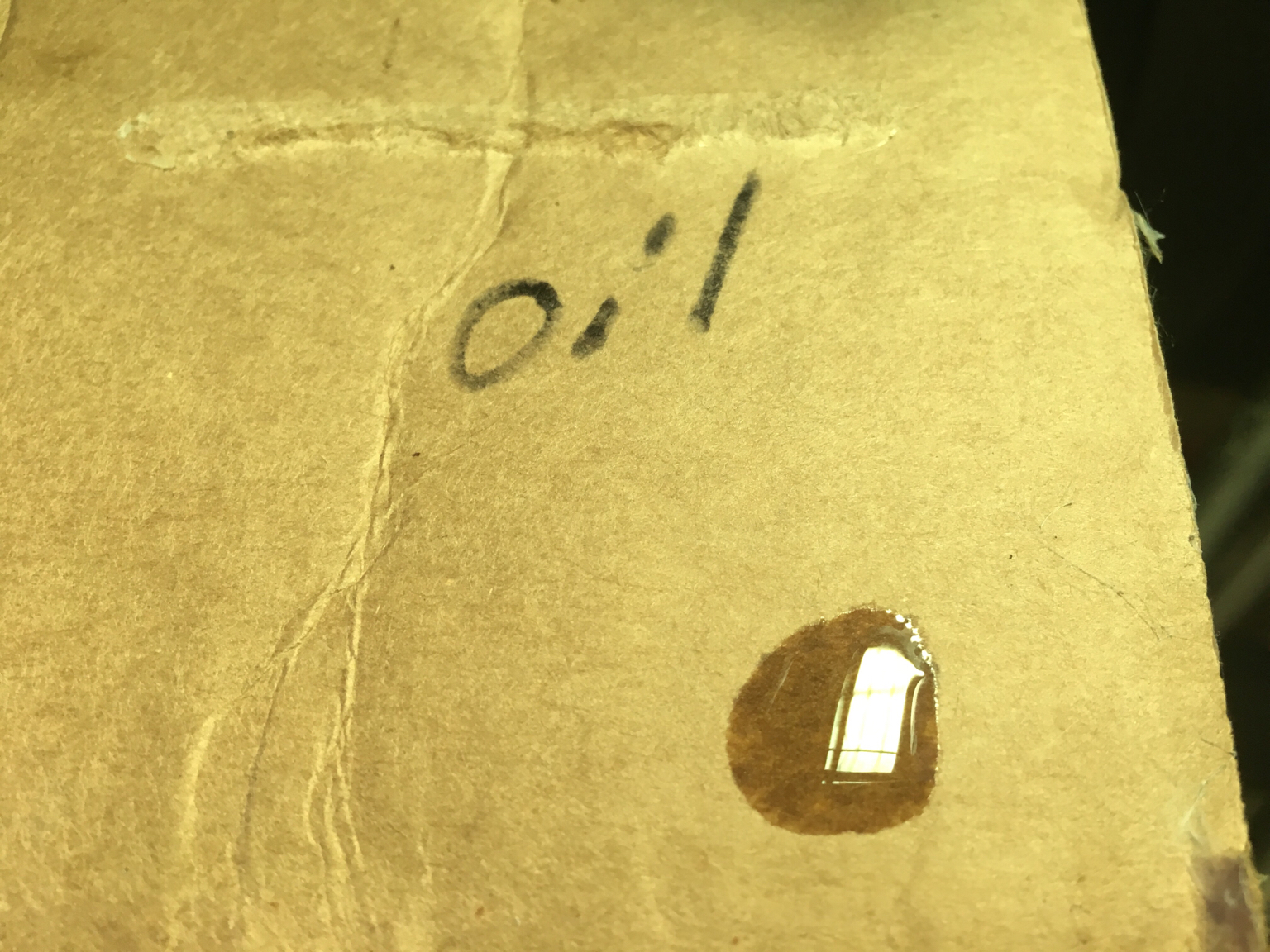

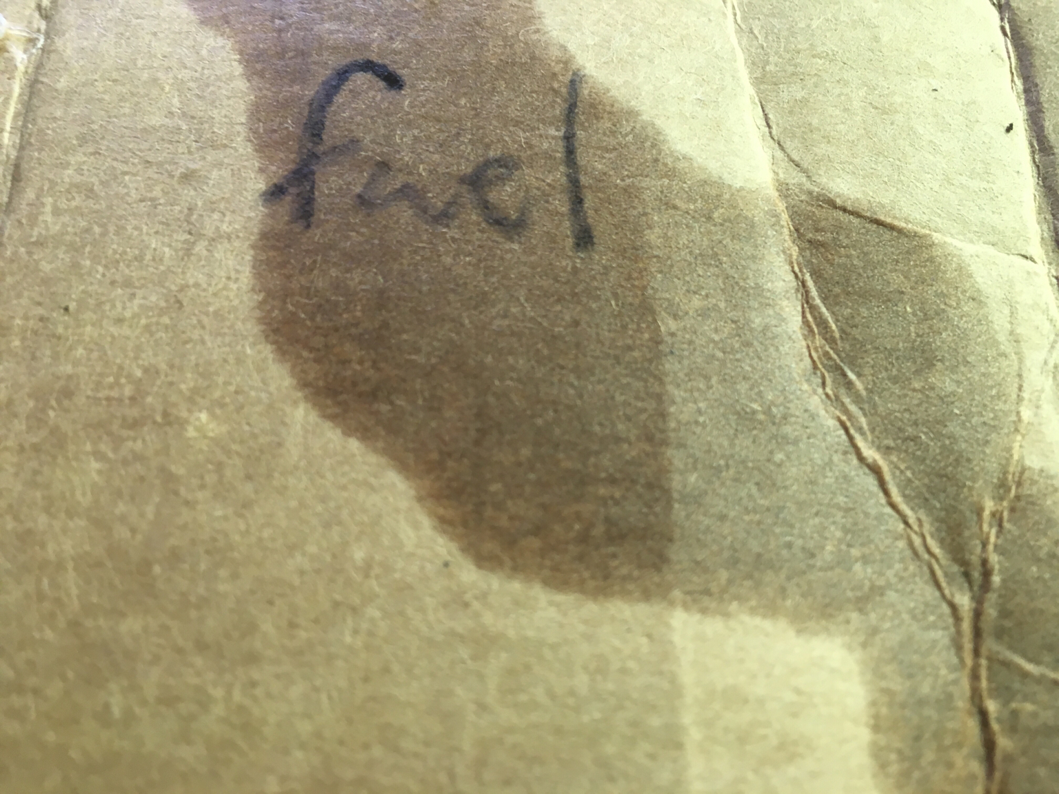

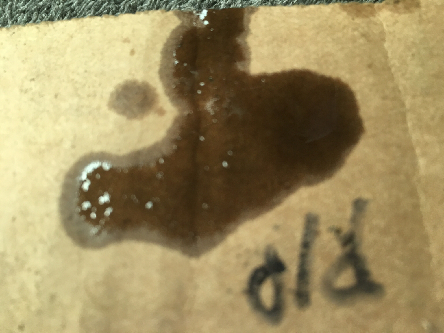

Ok folks here is a tip for you, if trying to figure out if there is fuel in the oil all you need is a piece of cardboard and a timer! Put a drop of clean oil on the cardboard, wait 30 sec and take a picture. Then place a drop of fuel and repeat the process, same with questionable oil. The diesel will separate and soak in faster than the oil-even of mixed. IMG_0280.JPGIMG_0279.JPGIMG_0281.JPG This tip came from the dealer!
