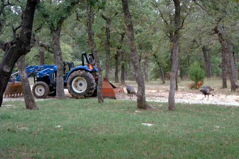

You haven't seen my woods, Soundguy. The 5' cutter ensures that if my tractor's wheels fit between trees, I don't have to worry about the mower following. I'd love to have a 6' or 7' cutter, but I'd either rip up my trees or destroy the cutter. Actually, the way my tractor is set up, the wheels are only 68" side-to-side. So my tractor is slightly less than 6' wide.
Now, if I were finish mowing my 3 or 4 open acres, I'd buy a RFM at least 6' wide and stay out of my trees with it.
I also have a 5' boxblade and a 5-1/2' boxblade. This is stuff I've had for a long time before I bought the TC45D. My loader bucket is the only 6' implement I have. I take it off when I mow and the 5' cutter allows me to mow with no front weights needed.
Check out the photo of my tractor sitting in my driveway. This is one of the more open areas. I won't clear out anymore trees because I like the "visitors" that come out into the open from time to time. /forums/images/graemlins/grin.gif
