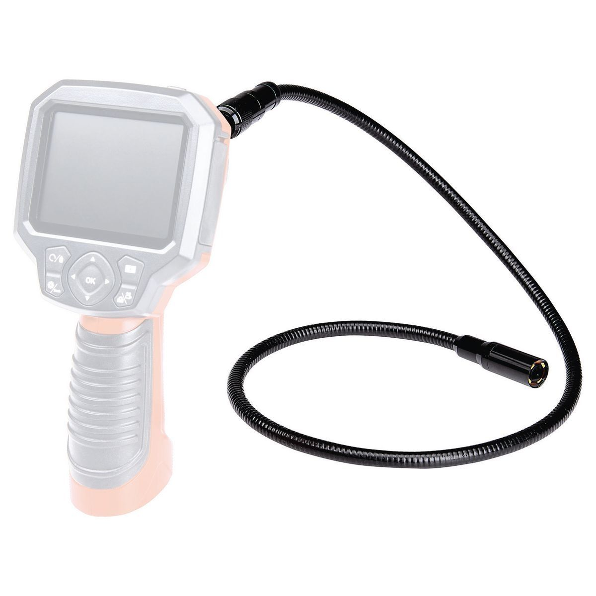

You could use this to check your cylinders or drain oil
and look to see what you have left in the oil pan:
Harbor freight special $20
