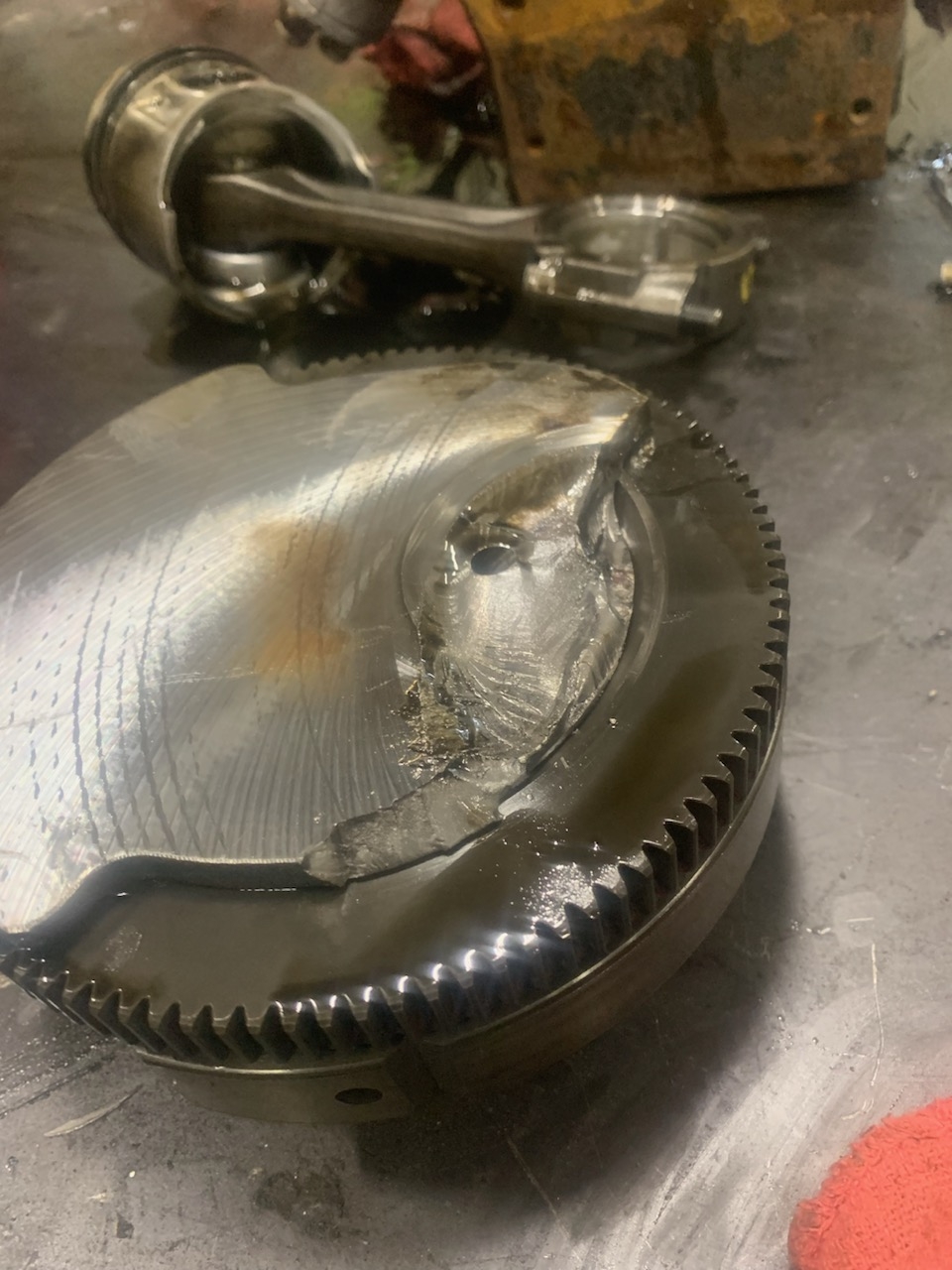

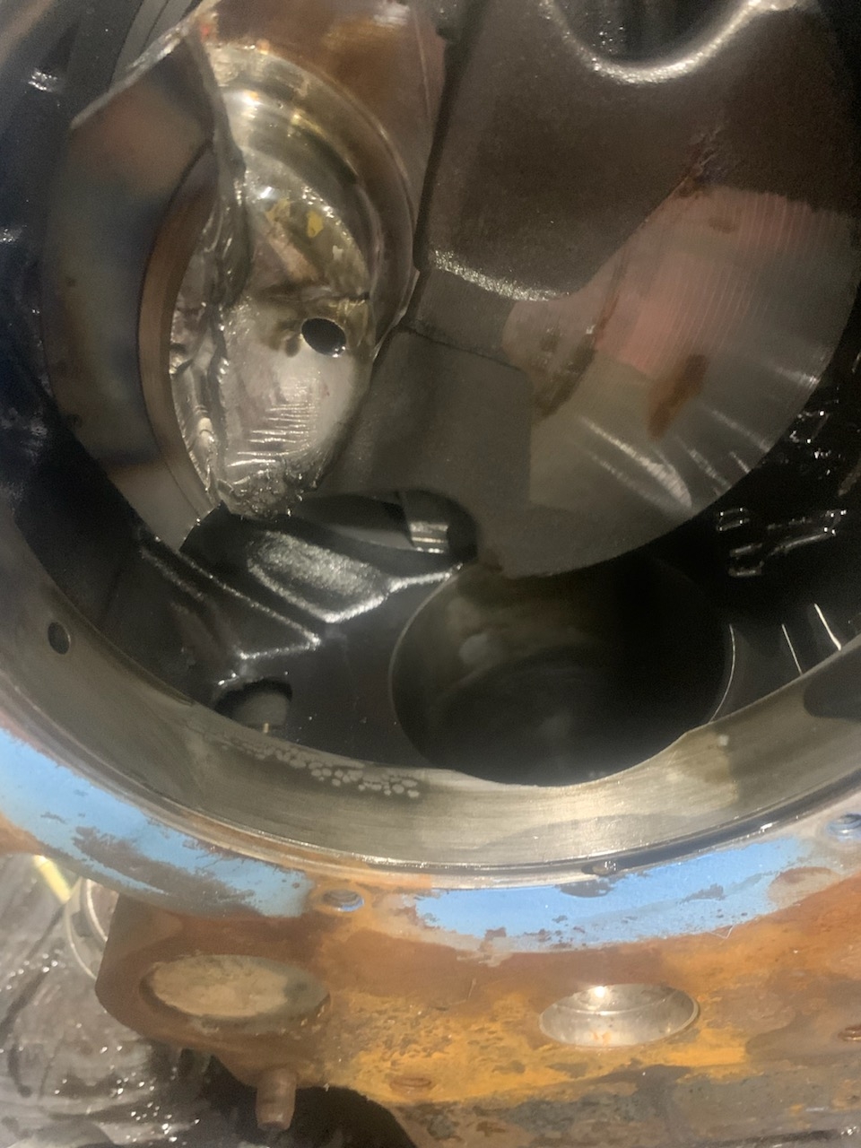

Crankshaft broke and the bearing was chewed up. Other than that the mechanic said everything was in pretty good shape and wont need to do much machine work wise. Will replace/rebuild what should be while it is disassembled.

He wasn't sure. Said he'd never seen a crankshaft break where it broke. You can see discoloration in the pictures above the break. One other section of the crank had the same discoloration, but everything else looked as it should and the bearing surfaces weren't that bad either.
Mechanic also mentioned that someone had been in the engine previously, but other than that he wasn't sure.

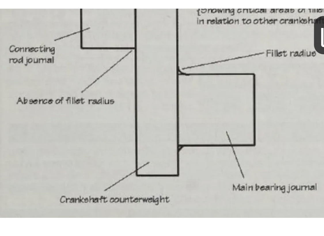

What did radius look
Like on journals if they are not tapered when cut or ground will create a shear point and snap
We had a machine do a few cranks for us years ago all of them broke
Not sure what you are referring to when you say "radius"? Can you clarify?
   / NH TC45D No start. Single Click/Clunk and nothing. Seized Engine? #20
When a crank is turned, at the edge of rod and main journals it should
Be like picture lots of you tube videos also
Same
Goes for when it is bored for sleeve cut for sleeve recess cannot be square cut other wise sleeve will crack and get sucked into pan
Experience talking. Hate doing stuff twice and finding machine just goes oops 😉🤙
