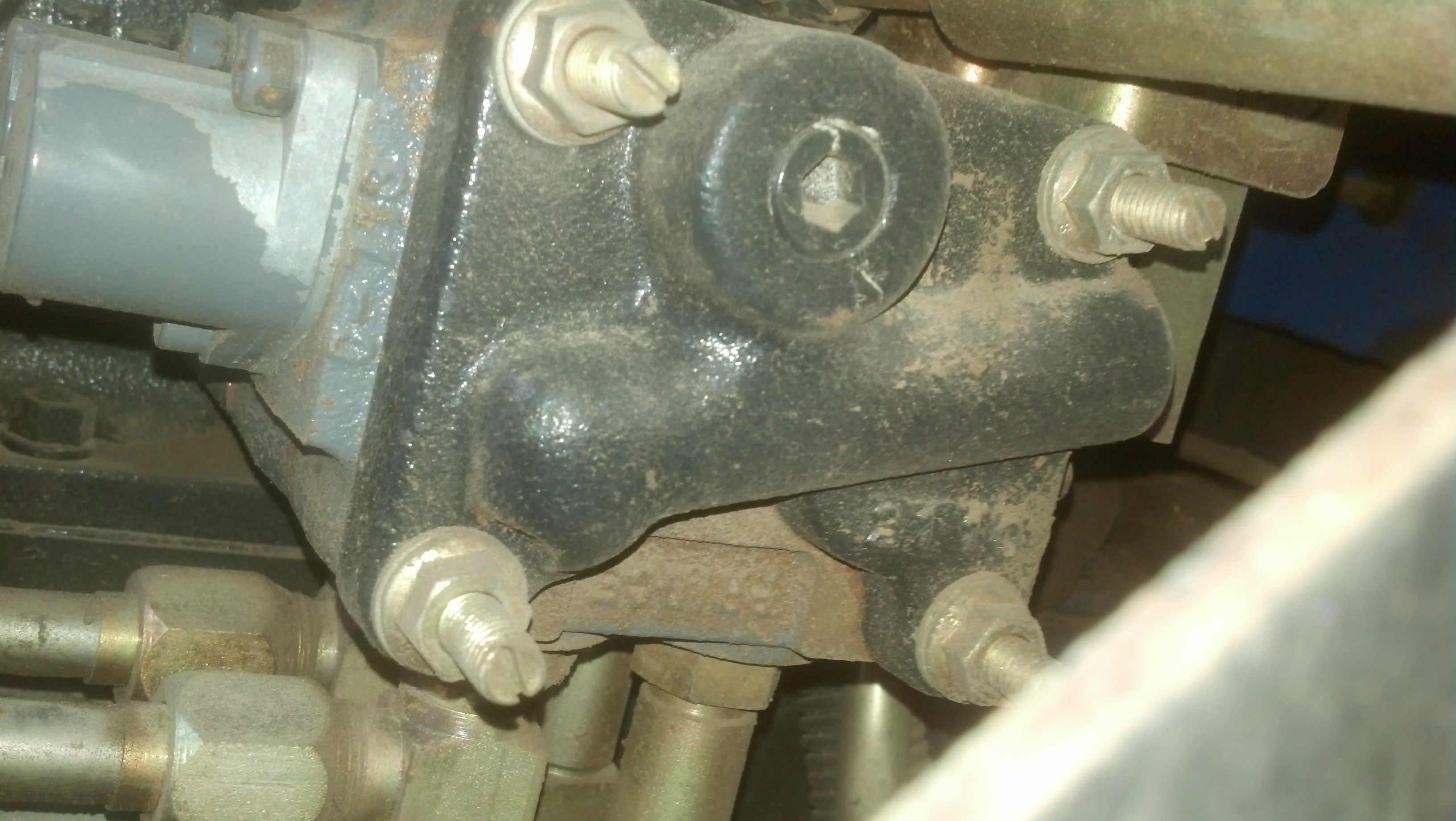

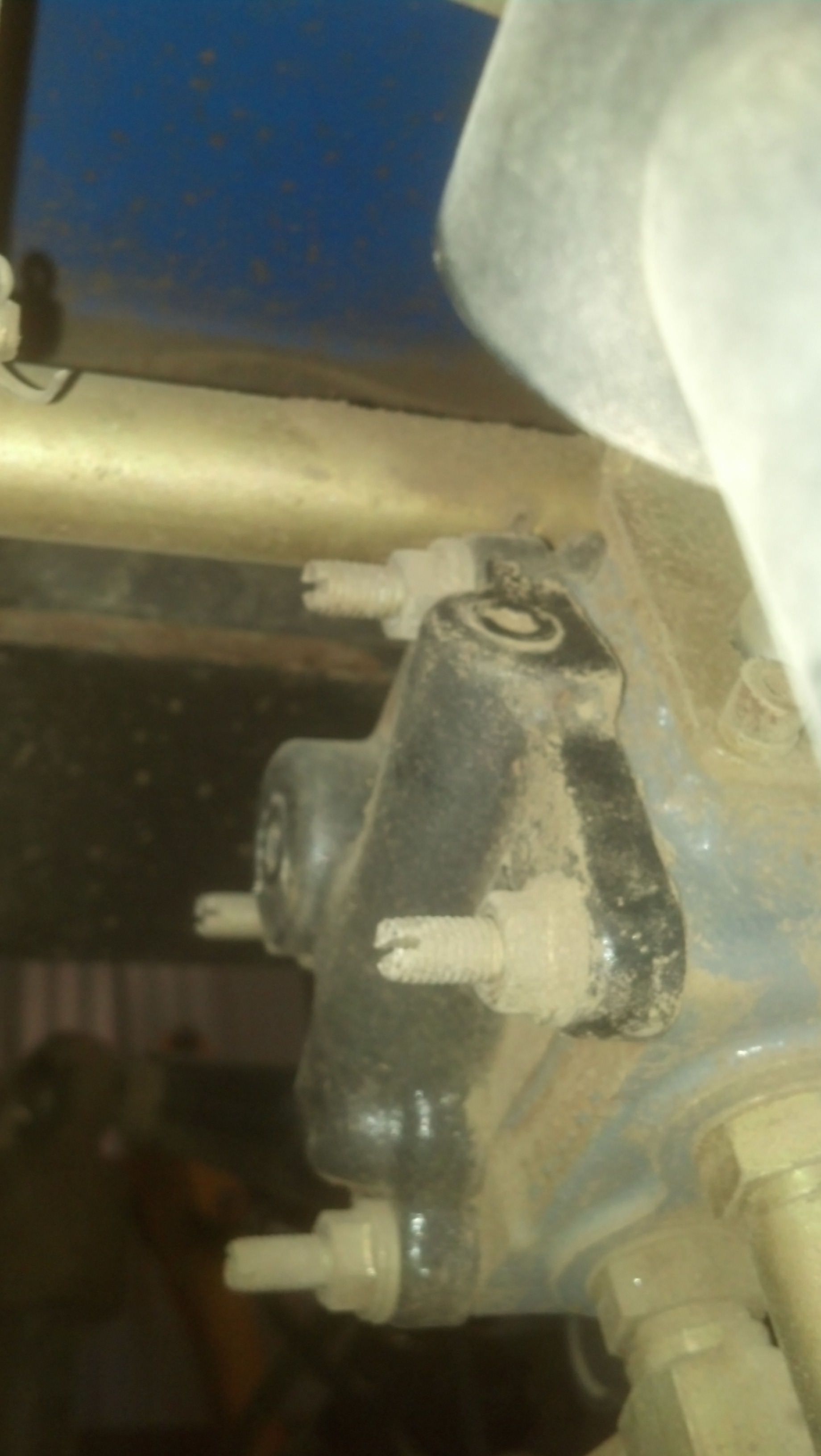

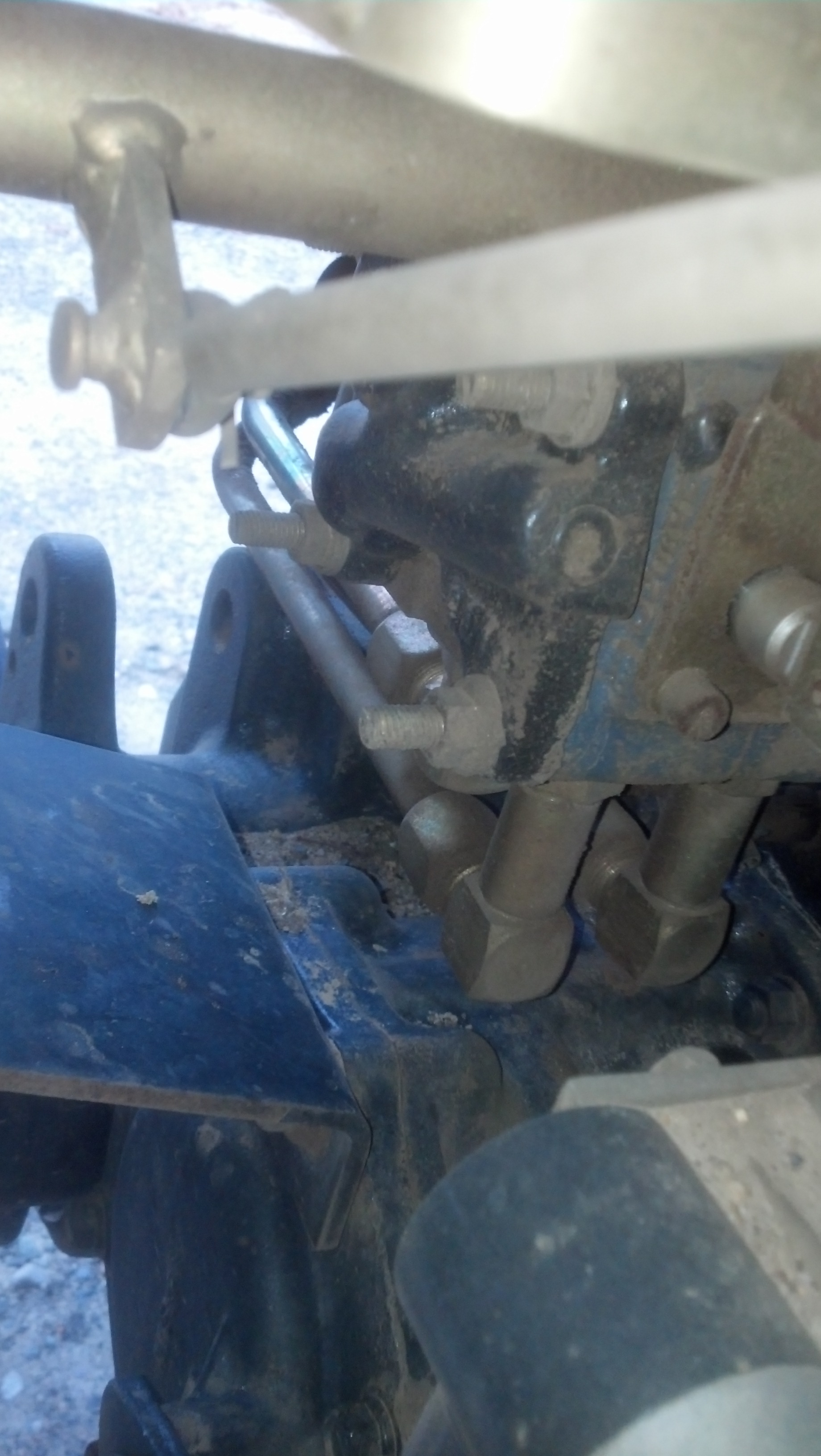

"The return can go where the existing pipe plug is in the OEM remote valve stack end cover."
Rick are you saying that I can pipe the tank return from the new Joystick into the rear remote valve stack end cap instead of using a "T" at the diverter Block? This would make things easier I wouldn't have to fight with steel tube to get a "T" in line and only have to remove the one PB steel tube and replace it with a hose to the new joystick. Which Plug in the end cap do I use the one facing the side of the tractor or the one facing forward.(see attached pictures.)
View attachment 287654 View attachment 287655 View attachment 287656
Use the port facing the right rear wheel.
   / NH TC45DA TNT install questions
#33
Thanks for the Info Rick. Just to make sure . You mean this one in the attached picture it is in the end cap facing the right rear wheel. Looks like it might be 3/8" pipe thead.
   / NH TC45DA TNT install questions #35
Jack, I've been wanting to do the exact thing you just described. I've been searching forums to make sure I had the right idea on how to hook it up. You post is exactly what I am planning on doing. You just confirmed I had the correct lines pinpointed. Thanks
