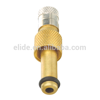

Oh. I think I now understand. The stem unscrewed from the wheel? I was thinking the cap was unscrewing the Schrader valve.
Yep, this part unscrewed:
Back together:
