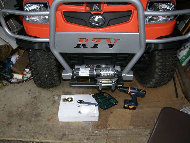

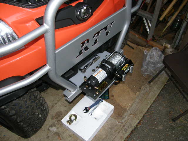

Simple fix for mounting
I had a 10" X 15" X 1/4" plate cut and punched four holes to match Grill Guard and seven holes to match the Harbor Freight Mount, it fits great and will look nice as soon as I get it primed and painted. Threaded Grill Guard Holes are 12 mm X 1.25 Threads, used Grade 8 bolts. The only other out of pocket mount sold cost $89.00. I will post pictures as soon as it is painted and mounted. $89.99 for winch and $9.99 for mount from Harbor Freight

P2160032.JPG This is a progress photo

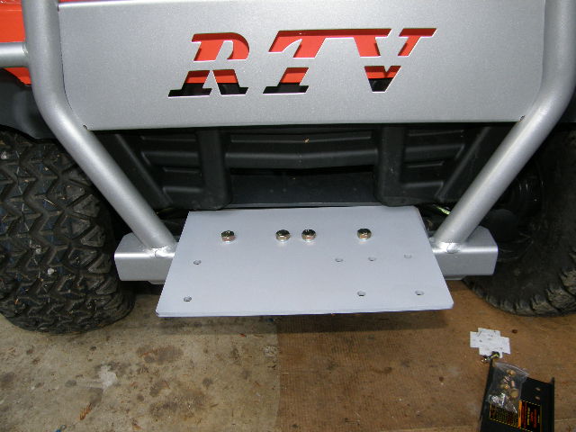

There are four threaded 12 mm bolt holes in the Grill Guard that the plate is bolted into. Tried to attach photo but it did not attache (doing something wrong)

yea i noticed that on the other website you posted a extra pictutre.lol i would put two bolts where you have your wrenchs sitting at to keep that plate from flexing up and down . it just seems that them bolts along the front will not keep that back from lifting up if you pull down on the front of the winch with a load. other than that it looks great man.
you will have a sea-saw affect if you know what i mean
