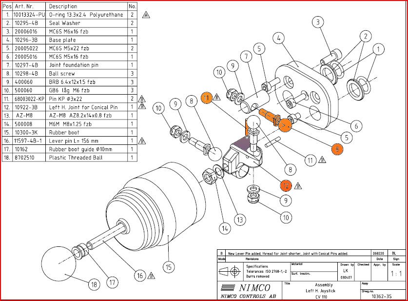

I finally got a reply from Nimco. The info was quite helpful, so I am posting it here for others to reference.
Attached is a drawing of the 10373-2S.
It is CV112 power beyond unit.
This is an older version of our valve configuration.
There is no relief valve in this unit. Reference # 5 is a solid plug that would accommodate a MRV.
There is an option for RV is this valve. The only option is fixed RV.
Currently the only RV we have available are.
10900-4K-140 set @ 140bar - 2030 psi
10900-4K-150 set @ 150bar - 2175 psi
You will need to contact one of our dealers or Mahindra for parts.
I have a PDF drawing of the valve now. If anyone needs it, let me know.

Nimco redesigned their joystick to add a pin to the socket to hold the ball in place (actually for all three balls).
In the attached picture, you can see the orange highlights are the pieces concerned. I need the orange ball stud (13mm, 5/16" thread, 1.54" overall, .75" thread length). Considering a stainless steel to prevent rust.
The darkened gray is the back part of the overall housing for all the sockets for the balls. Just under (backside that you can't see) is the tapered slot where the ball stud fits.
Hope this diagram helps someone else, too.
Edit: Here are the parts I need.
Item #8, "Ball Screw, 1409-3052"
Item #12, "Left H. Joint, 1409-3054"
- JC
