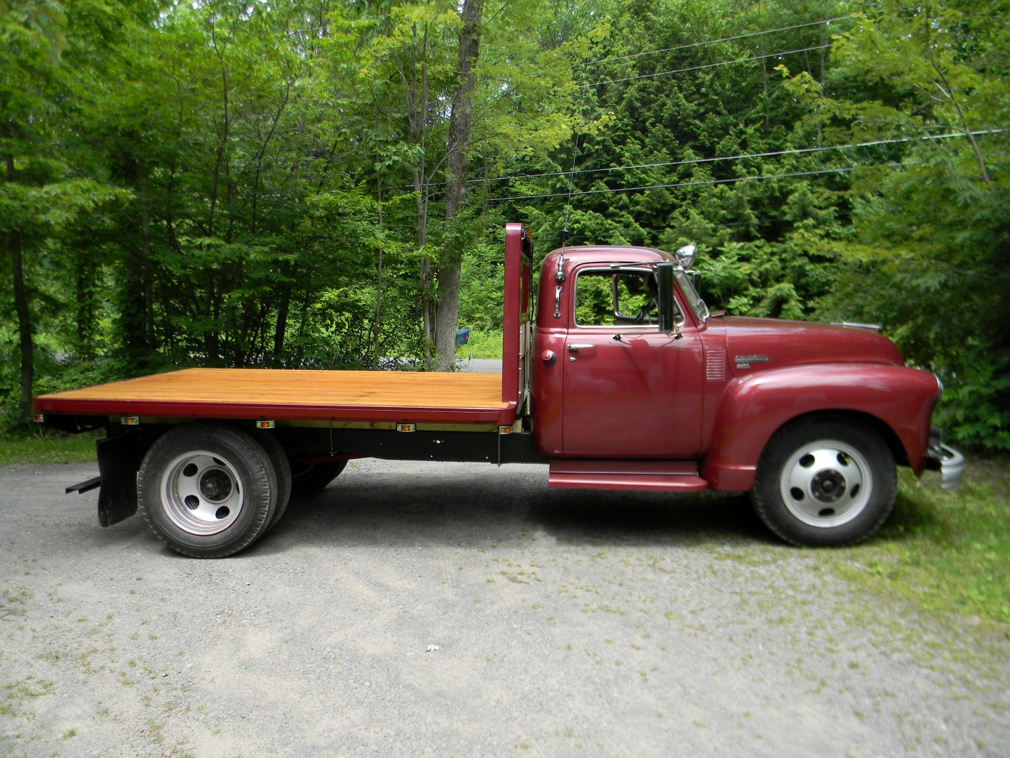

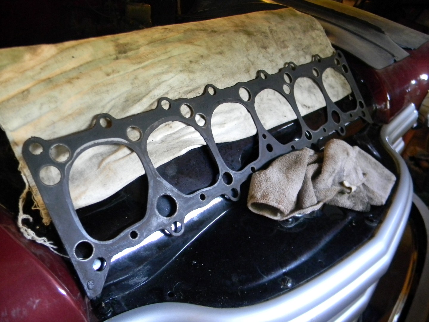

PS does work but it whines a little. Going to check with him in a few minutes for the pdf but I'm working on my classic truck to get it ready for the Syracuse Nationals next week. Blew a lower radiator hose today on way to a car show. Never made the show, had friends give me a ride back home so I could get my truck / trailer, then went and picked up truck. Put new hose on and refilled and started. A few minutes later engine started blowing white smoke out exhaust. Usually a sign of a blown or at least leaking head gasket. Cylinder head is now off, the gasket, head and block all look good but head bolts were loose. Required very little pressure to remove the bolts. Engine gasket kit on order. Shipping Monday and will get next day but not till the afternoon. That gives me Tuesday afternoon /evening and all day Wed. to get it back together. For me, the Nationals start Thursday and run thru Sunday.

That's the good thing about a 66 year old truck. No computers, plenty of room to work on them. Bad thing is that parts are available but not locally and need to be ordered. I think the head gasket started leaking because bolts were never re-torqued. Truck only has 6,600 miles on it.
