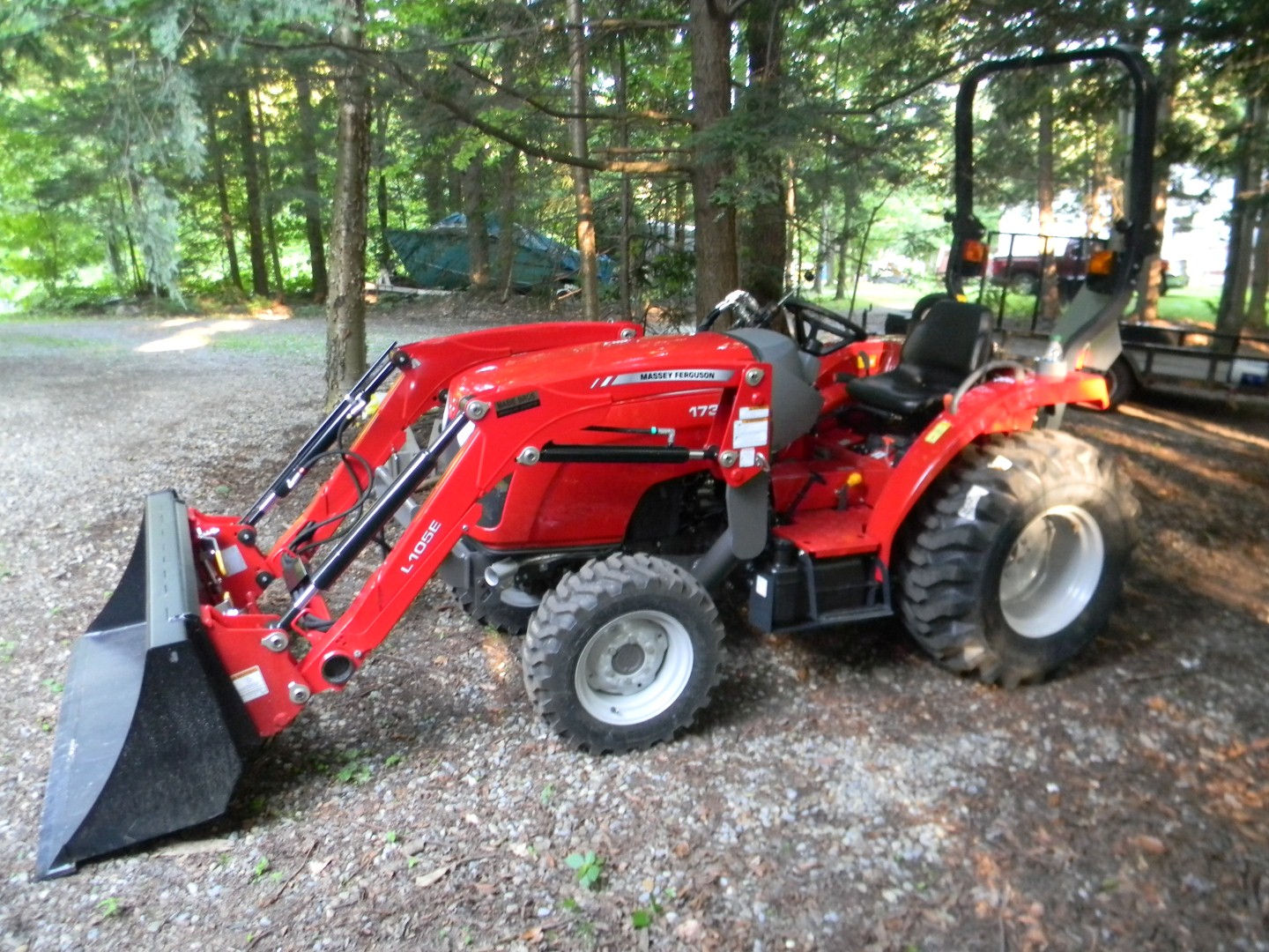

UPDATE:
Neighbor got his tractor fixed. He got lucky, as it wasn't the pump or the shaft. He had run over some large boulders (He hadn't mentioned that to me, He told me it just stopped working) and one of the boulders crushed (pinched) off a metal hydraulic line cutting off the flow to the loader and 3 pt. Dealer replaced the line and got it working again. Cost to him was about $300.
When he went to pick it up, He paid his repair bill and ended up trading it in on a new 1734E. The 1734E was just delivered to him today.

UPDATE: Neighbor got his tractor fixed. He got lucky, as it wasn't the pump or the shaft. He had run over some large boulders (He hadn't mentioned that to me, He told me it just stopped working) and one of the boulders crushed (pinched) off a metal hydraulic line cutting off the flow to the loader and 3 pt. Dealer replaced the line and got it working again. Cost to him was about $300. When he went to pick it up, He paid his repair bill and ended up trading it in on a new 1734E. The 1734E was just delivered to him today.
Now he can drive over bigger boulders. :D
Nice looking tractor!
