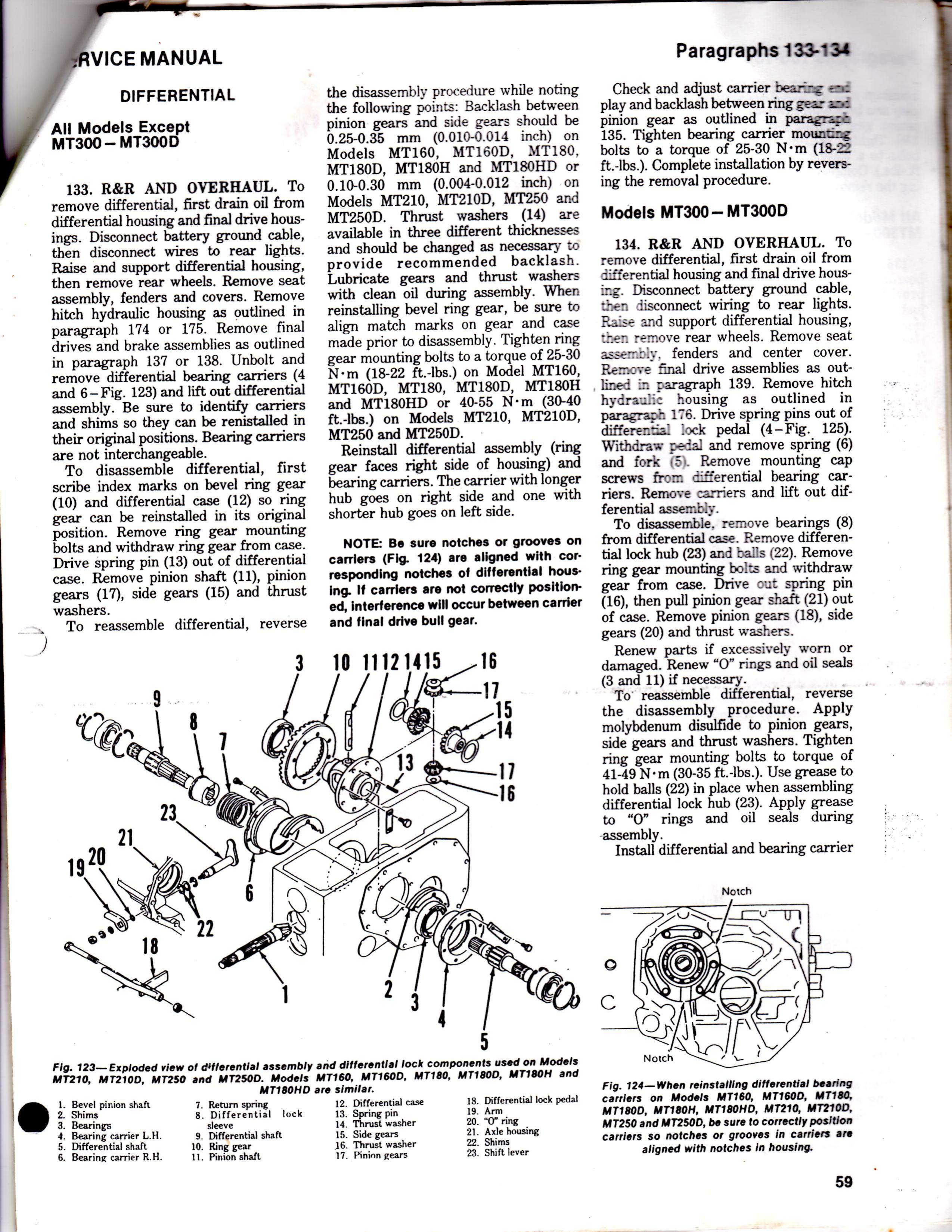

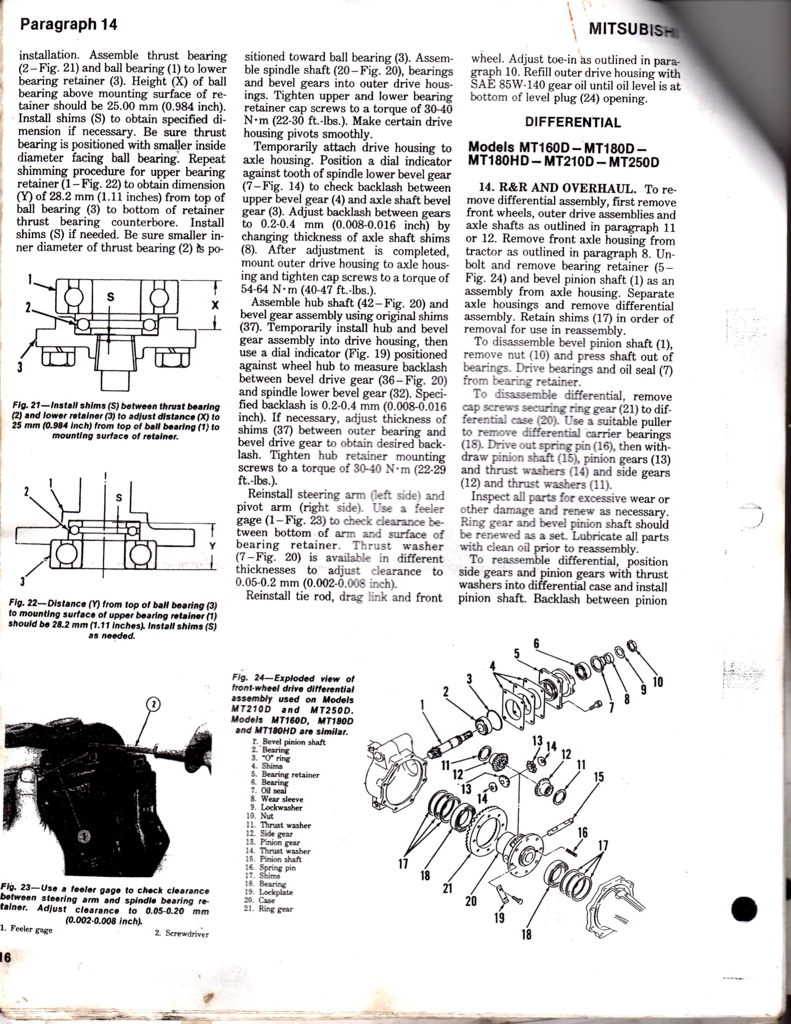

Sounds like the front differential has been neutered. There has to be some parts missing, possibly the pinion gear off the input shaft? When you spin one front wheel and the other turns opposite, that is normal. The locker might be a little loose, not sure. Is there a nut on the shaft where it pivots? Most are pretty tight and have to be freed up. Can you tell by a close inspection if this tractor has been disassembled? You could have one of the notorious vietnam rebuilds. Hope not.
This is what I'm thinking. I will tear into it this weekend. There is a guard around the driveshaft at the front yoke that is missing half it's parts. So it looks like is has been messed with.
   / No 4x4!!! #12
Oliver is right on. It sounds like everything in the front drive system is working from the hubs to the diff. If the drive shaft is spinning the yoke, it should be turning the pinion gear shaft because the shaft is splined, not just pinned. Sounds like the issue has to be either a ring or pinion gear issue. I believe the pinion gear and shaft is one piece.
The lockslide has 2 dogs on it that engage the diff, the "bump" you are feeling is most likely those dogs attempting to engage. They or their corresponding slots are either too worn or something is loose or bent allowing a too short throw to enagment.

I tore into the front end and the ring gear is not attached to the carrier. I don't yet know if the bolts have been sheered, if they backed out or both. I haven't split the case yet but the oil does not have any chunks of metal in it from what I can tell. and I cannot feel any metal in the bottom of the case. The mystery is there does not seem to be a way to get to the bolts on on the carrier/ring gear unless the case is split. So either the bolts have all sheered off and were fished out or somebody split the case and put the carrier and ring gear back in without the ring gear being attached. I will update when I split the case. Thanks or all the help.

OK, the ring gear bolts were sheared off. The Carrier and ring gear need to be replaced. I will definately be safety wiring all of the nuts when I put it back together.
