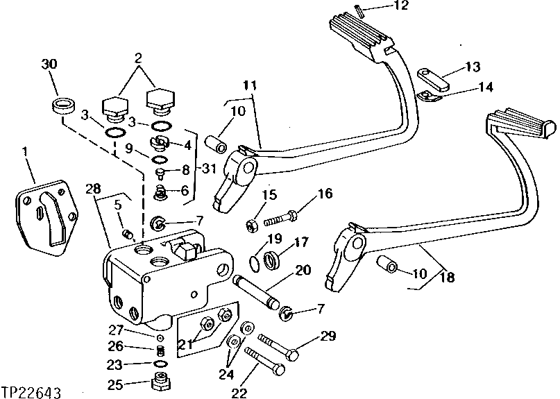

I have no brakes on my machine. Drained and changed all hydo. fluid and filters. was real ugly grey fluid. put new boots on shift levers.and now keep in the barn out of weather. Tried bleeding them several times. no luck. last time I bled them the fluid was looking milky again after only 20-30 hours of use. ???. any sugestions ??

When you say "bleed" them, do you have a master cylinder? Are the brake pedals spongy, or what does bleeding do?

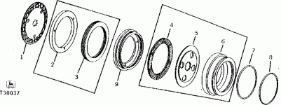

No brakes could be caused from valves in master cylinder not seating or leaking o-ring on brake pistons in one or both final drives.

I know no additional water contamination has accured. It's been stored inside.I would guess that the milky looking fluid is what has been circulated around the system from not being able to drain every last drop out. Is the a way to get every drop of old fluid out ? when I first bled the brakes after new fluid and filters it still had nasty old fluid coming out and could not get the new fluid to come oue ,even after a number of attempts. Machine is a 60's era tractor,backhoe is a 92 model. loader ?original equipment. I have a master cylinder but never touhed it,only the bleeders on the axel.NO pedal.no air coming out the bleeders.I do have brakes at the very top of the pedal stroke on ocation. but it is only at one point in the pedal travel near the top. any movment past that point is no resistance at all on the pedal and no brakes. if i depress the pedal quickly there is nothing at all. going very slowly I can sometimes get a little braking action at the very top of the stroke the nothing

Next choice seems to be to isolate the master cylinder as a problem. Find a way to test each brake to check the o-rings as TXJim suggests. Maybe a pressure test on the output side of the master cylinder would point to the problem. Maybe at the bleeders on the axle that you mentioned.

If no more air turns up after the fluid improves then look into rebuilding the master.

Here's the part number for the kits to overhaul the brake master cylinder.
KIT AT182633 BRAKE VALVE OVERHAUL (REQUIRES 2 KITS FOR 1 VALVE)
