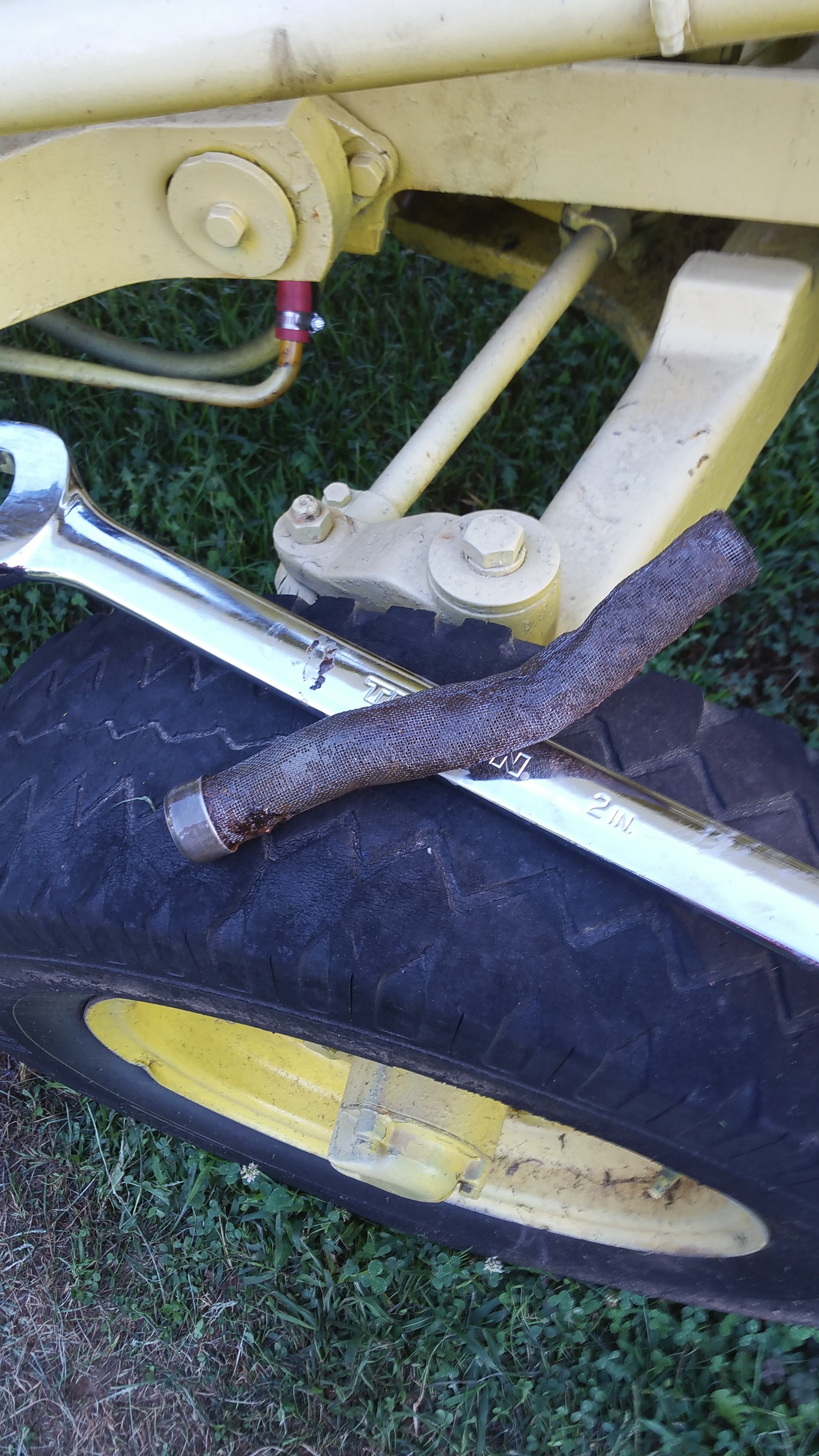

I found some time to work on my tractor today, I pulled the sump screen and found it to be damaged. Its looks like both ends supposed to have a metal ring on the ends but one is missing. I looked into the sump and the other end in not there.

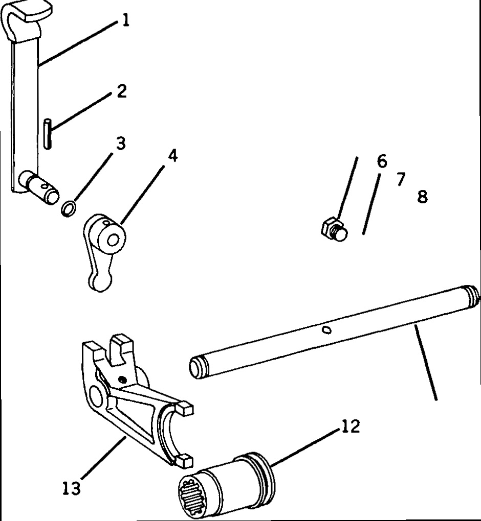

I also stuck my finger in the transmission drain hole and I feel something laying in the bottom. Its too big to pull out the hole and it doesn't feel jagged like its broken off of something. I moved it around and if feels similar to item number 4 in this picture, or something similar. I don't know if it is possible for that to be in the bottom of the transmission or not. Needless to say my problems keep getting worse.
