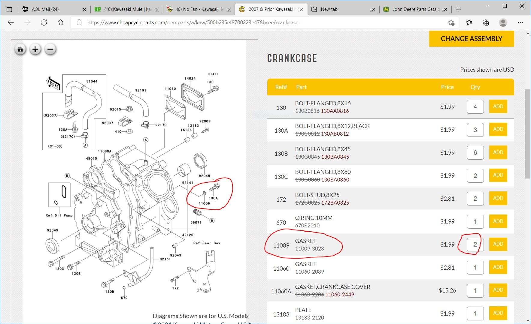

Just a wild guess, from looking at parts drawing. Since it has a gasket and there are two, I think these are it?? :unsure:

Update: (sorry for the long time gone, but life got busy) Finally found a local shop that was willing to work on it. They found the fan did work when direct wired, and set about adding a switch and wiring the fan directly so I can just use it when necessary. In the process, they also checked the oil and coolant and found oil in the coolant and coolant in the oil. Blown head gaskets. Not what I wanted to hear, but better than a new motor expense. Hope to have it back from the shop late next week.
   / No Fan - Kawasaki Mule 2500
#20
UPDATE: Local repair shop replaced head gaskets and found no internal problems (valves and cylinders were OK). Machine runs great now. Starts right up and runs smoother than ever. Fan was not rewired as it came on right away when they ran it until coolant temp reached 190 (I think that's what he said). Oil and coolant look clean and fresh though I've probably only run it about an hour so far.
