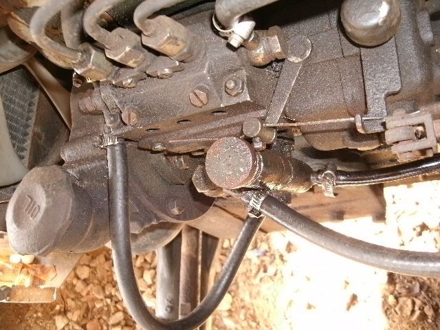

How do I check the oil level in fuel pump? There is a rubber oil filler plug at the very front of pump. If pulled, there is nothing there but an elbow oil passage.
That is for adding engine oil. I see there isn't any dipstick, so you should have a short 6mm bolt on the side of the pump slightly below the centerline that is removed to check the level. Oil is added by removing the vent (the dome shaped device at top right). Oil is drained from the injection pump/governor by removing a short 6mm bolt on the bottom. Note: Not all fuel injection pumps will have a drain bolt, in which case it's necessary to suction the oil out.

Here is a picture of the fuel pump on my 284 that may help.

Noticed the vent cap before while looking at pump, but did not know what it was. Tried to lift it off with some pressure. Looked under it and saw it had a nut below it. Do I remove vent cap by unscrewing the large nut below it? Will try to find drain plugs Click on photo in above post to blow it up.
   / No fuel out of fuel pump #18
Yes, the nut at the bottom is how to remove vent cap.
