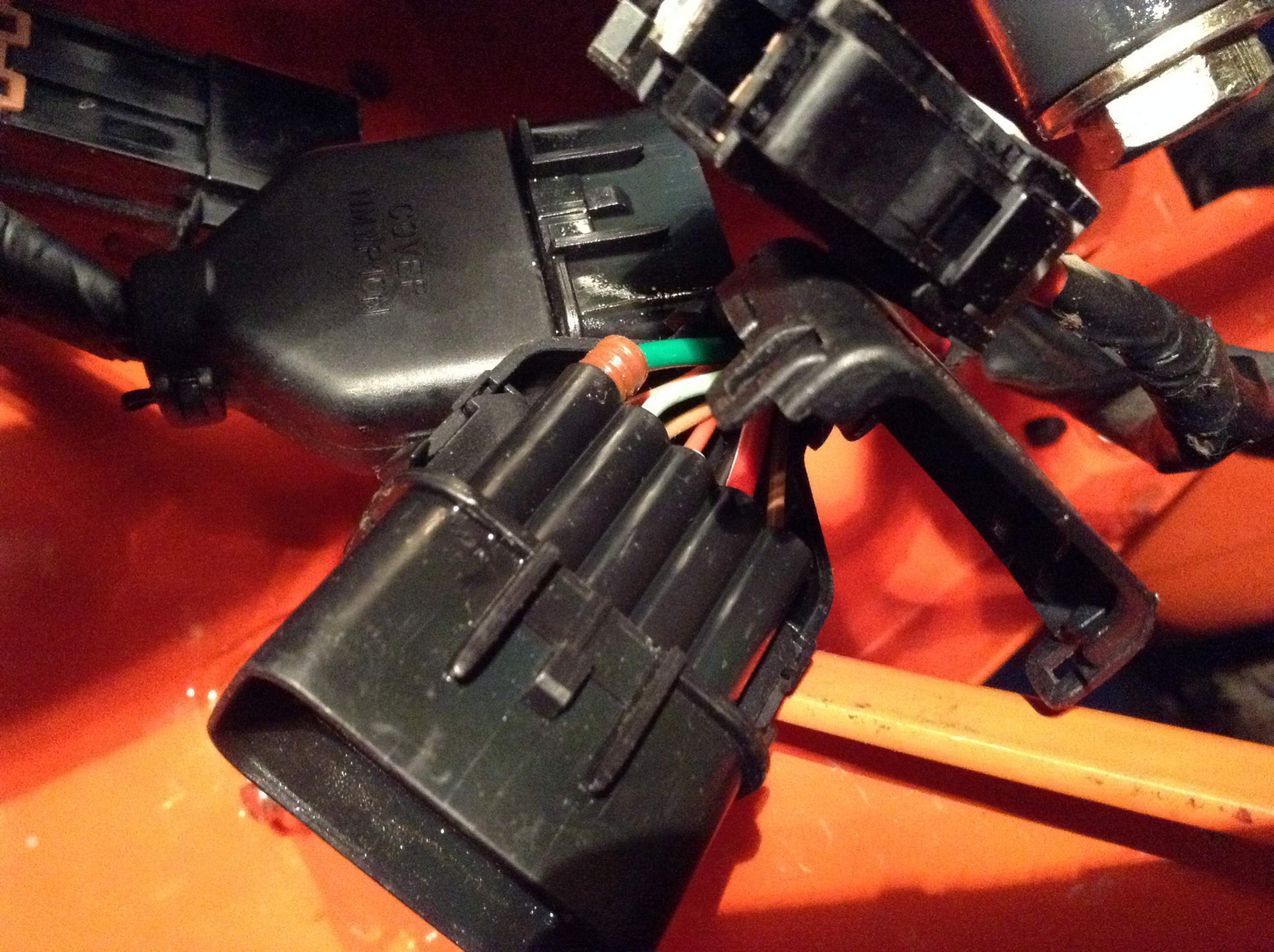

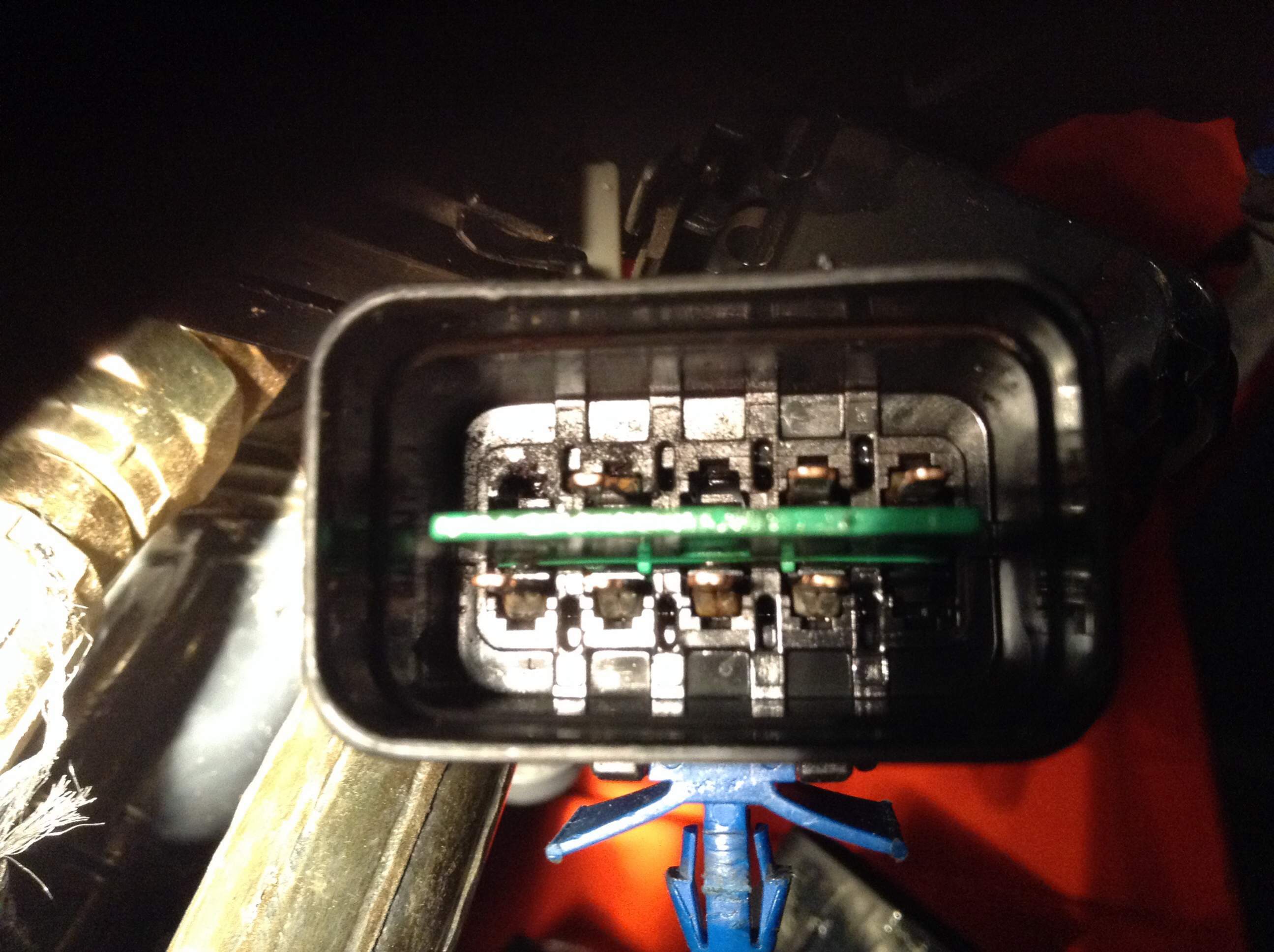

Well,I finally figured it out.I didn't see it at first ,but a lot of threads point to the connectors under the floor boards and that is where my problem was.Thankyou Ritcheyvs for the personal help you gave me,and tj for your posts.I overlooked the connections because they looked good,but after going back and forth I changed up my thinking and started at the relays for the hi low beam and kept jumping the green wire until I got power.IT was at the connection and was pushed out and the spade was rusted off,because it was pushed back it looked good.I should have counted the spades on the one side,because I was missing one .wish kioti made better connections

   / No hibeam lobeam on CK 30 #12
It's a shame that Kioti put all those connectors under the floor board where they can gather all kinds of slop and cause many elctrical problems. Members here have disconnected them, along with other connectors throughout the tractor, and used dielectric grease as a way to keep them clean and working. Maybe someday Kioti will use the connectors with the wires sealed as they enter and then the o-ring where they connect as is used on other vehicles. At least you're lights are working again.
