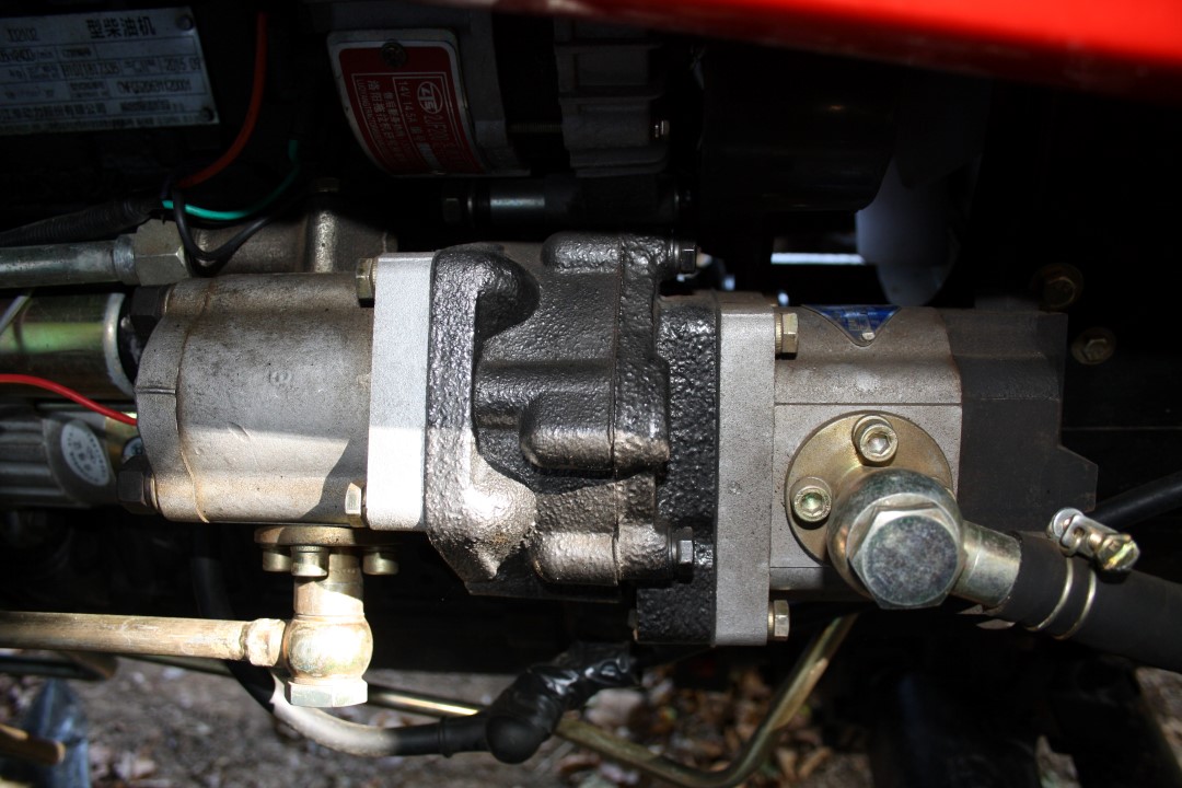

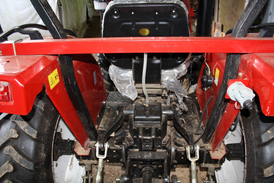

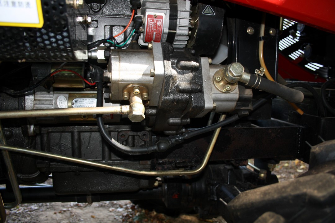

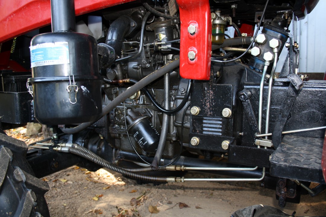

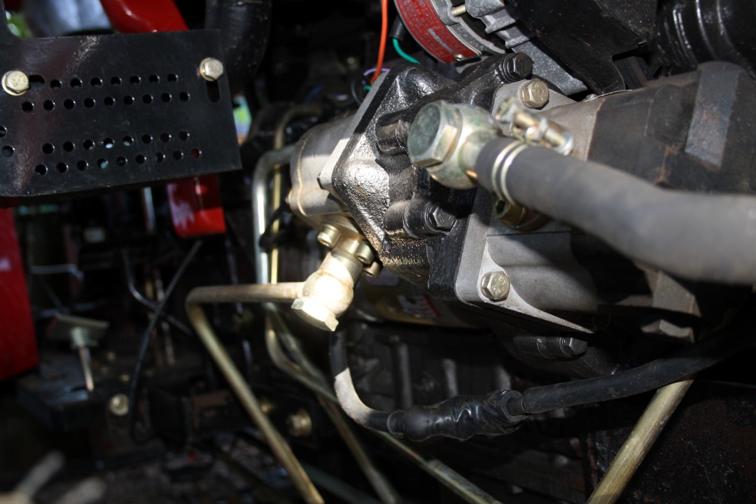

I wrote to the vendor and this is what he said :
"the power steering and mechnical steering is different from the new model. different front axle, and different engine, it's will be expensive to change both front axle and engine, what about to buy a new tractor?"
(I wonder ... my tractor is "1" year old!!!)
I have added a few pictures of my tractor and in my wildest dreams I am imagining that someone out here is couragous enough to explain this dummie what I am looking at and how to solve my problem .... :(

It is obvious that your dealer does not want to help you!
He WANTS to sell you another new tractor.
Do not ask THAT dealer any more questions, he will not give you an honest answer.
   / no hydraulics can be added ????? ... the end of my dream ?? #10
Try asking in the Chinese Tractor forum. The pictures look a lot like my Jinma, the hydraulic pump in particular. Typical Chinese hydraulic plumbing is you cut into the line between the pump and the 3pt hitch with a male and female quick-connect.
