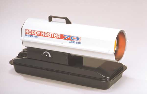

Time for a torpedo heater. I would NOT light a fire under the tractor, but a torpedo heater will heat things up really fast, especially if you block the far side of the tractor with a full or partial sheet of plywood so that the air/heat doesn't just escape. These things say they are to be run on kerosene, but outside, I run mine with diesel.

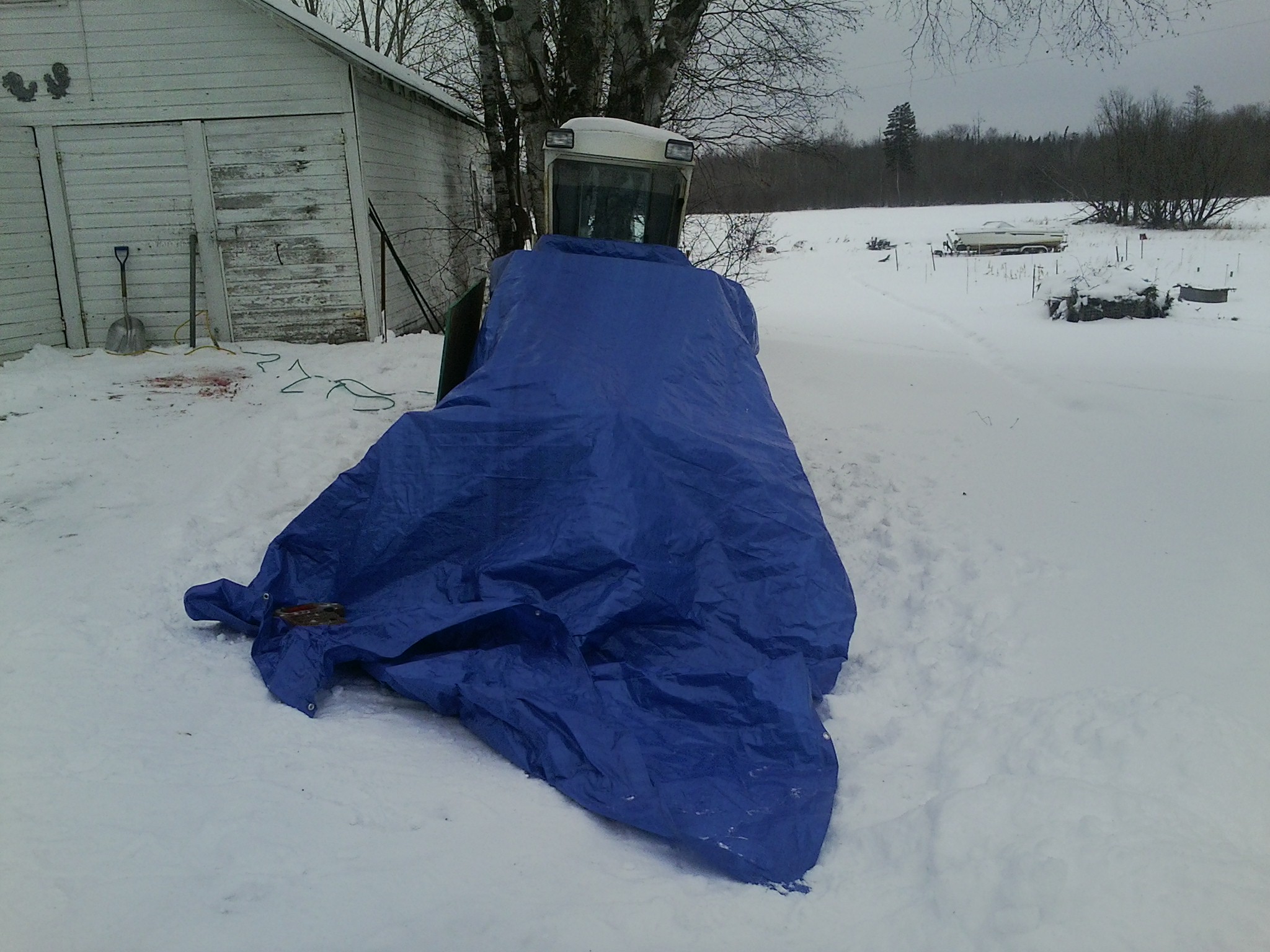

I went to the house in town and got our 55,000 BTU Reddy Heater. I'll put some scrap plywood sheets around the tractor and perhaps a couple tarps over the top to trap the heat, ignite the heater and let 'er cook! After a couple hours (or when everything feels warm to the touch), I'll loosen the drain plug to see if any water comes out. If so, I'll drain until hydraulic fluid appears. If no water comes out, I'll just fire up the tractor and see what happens.:crossfingers:

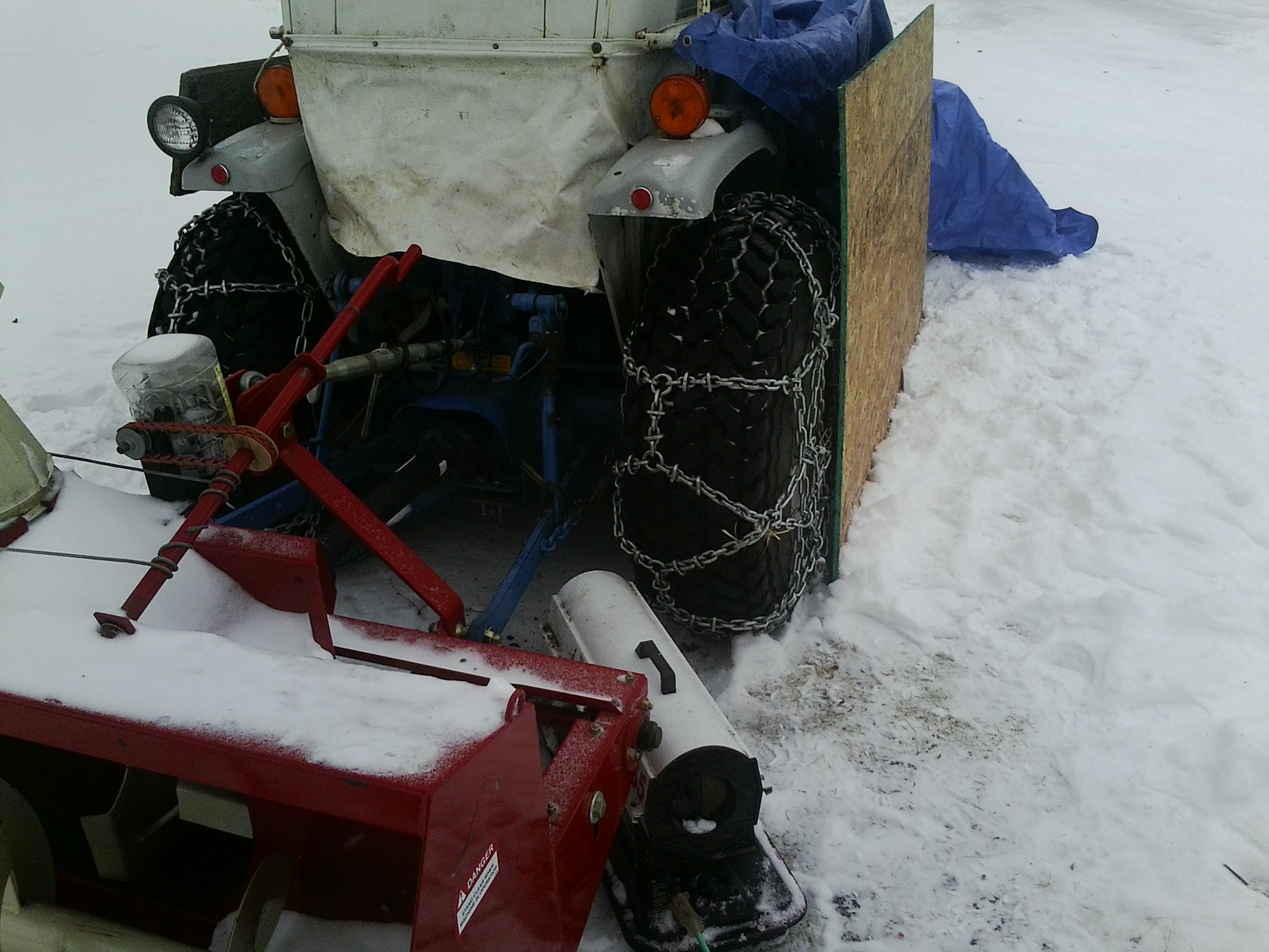

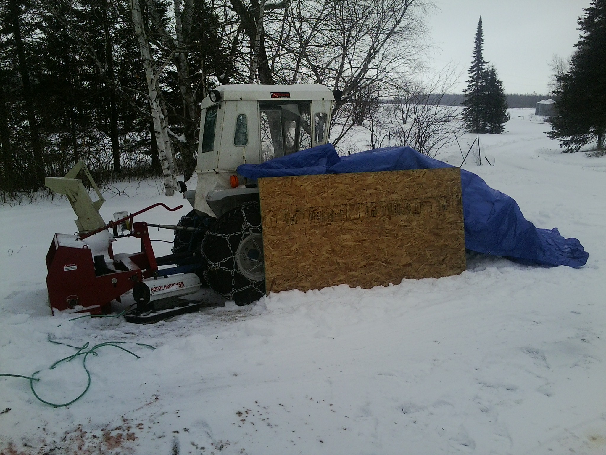

20 degrees today, so I put the Reddy Heater between the tractor and snow blower, put a couple sheets of OSB on the sides and covered the top with a cheap tarp. I then plugged in the heater, did some chores and went in for lunch. About three hours later, I crawled under the tractor, cracked the drain plugs to see if there was any sufficient amount of water to drain out. One plug netted about 1/2 teaspoon of clear water. Nothing else but Hydro fluid in the rest. By this time everything on the tractor was warm to the touch. I figured it was time to fire it up and pray.
SUCCESS!:cool2:
