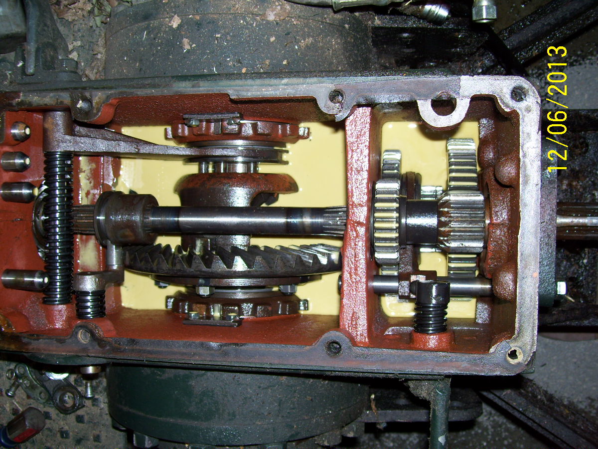

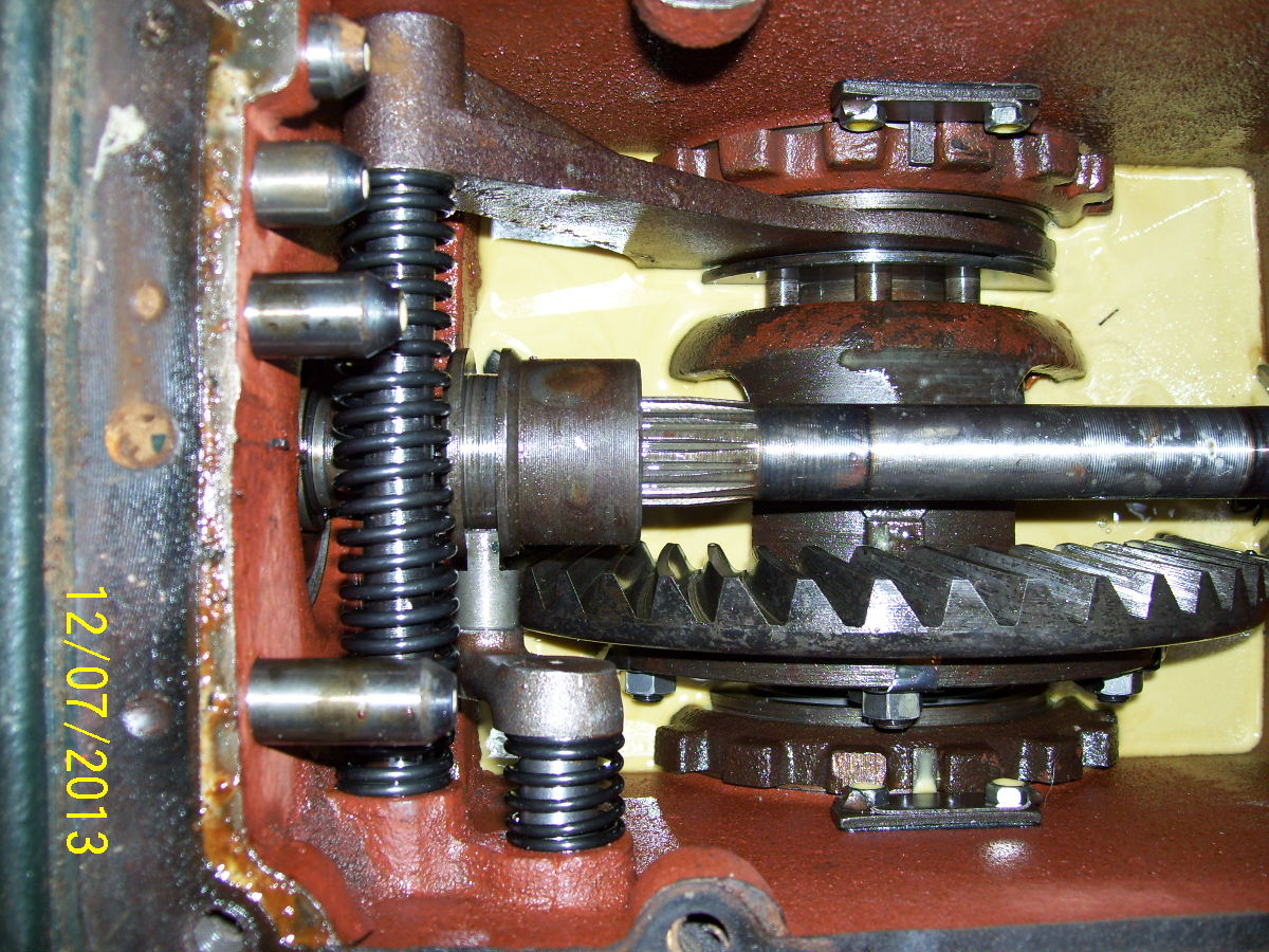

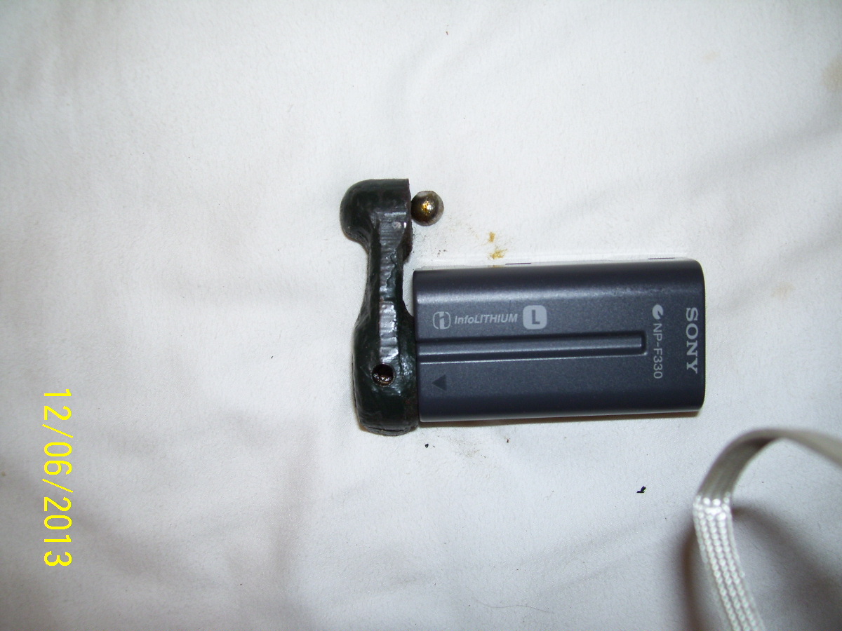

429 Lever.JPGI finally got the top off of the PTO box on my KAMA and found that the splined connector was jammed all the way to rear of the pump shaft, The pin that holds the lever to the on\off shaft was sheared. The splined shaft is now in place and I'm going to drill the lever and shaft and put in a bolt.
Thanks to all who replied.

See that yellow crap at the bottom of the sump? You don't want that in there when you pour fresh gear oil back in. That stuff is an emulsification of oil, water, paint, and rust. It has significantly reduced lubrication capability, and will create more rust if not removed. Sponge that all out before you close up. A kerosene rinse wouldn't hurt either.
Another hint if you've opened the hydraulic sump; use a proper gasket and only enough gasket cement to prevent slippage upon reassembly. Avoid shortcutting with "gasket inna tube". It will break down, and eventually clog choke points in the hydraulic system. Same advice applies to Teflon tape; don't use it on threaded hydraulic connections. Use a pipe thread compound appropriate for oil/gas - or liquid Teflon sealant if you can find it.

At 10 hours I decided to replace all of the Chinese fluids in the tractor with new fluids. I thought I had covered all of the drain ports but I guess I missed the PTO box. I noticed that when I finally got the PTO box off. I wanted to wait until I was ready to put the PTO box back on to drain it figuring that I'd rather drop crud into the Chinese crud than the new 85W140. I got it ready to put the box back on yesterday so I crawled under the beast and drained a ton of fluid out of the box, rinsed it with mineral spirits and poured in new 85W140. Big difference. The gasket stuck to the gear box so I am going to check it to be sure it's firmly attached before I put the PTO box on, hopefully today. Sure be glad to get this job done. Wife want's her parking space back.

David,
A question for you to further my education. Thank you for the pictures in the note above.
It looks to me like the internals on your gearbox are the same as the info that I posted on the Jinma 284, except that the controls on yours come in from the left side rather than the right.
Is that correct?
If so, I can add your pictures to my files (they are better pictures than I have).
Thank you,
RonJ

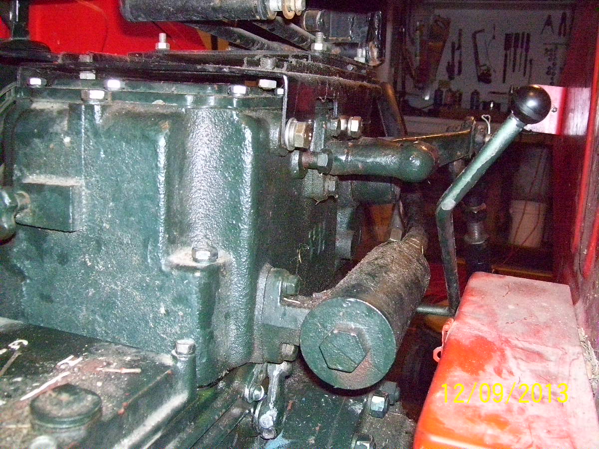

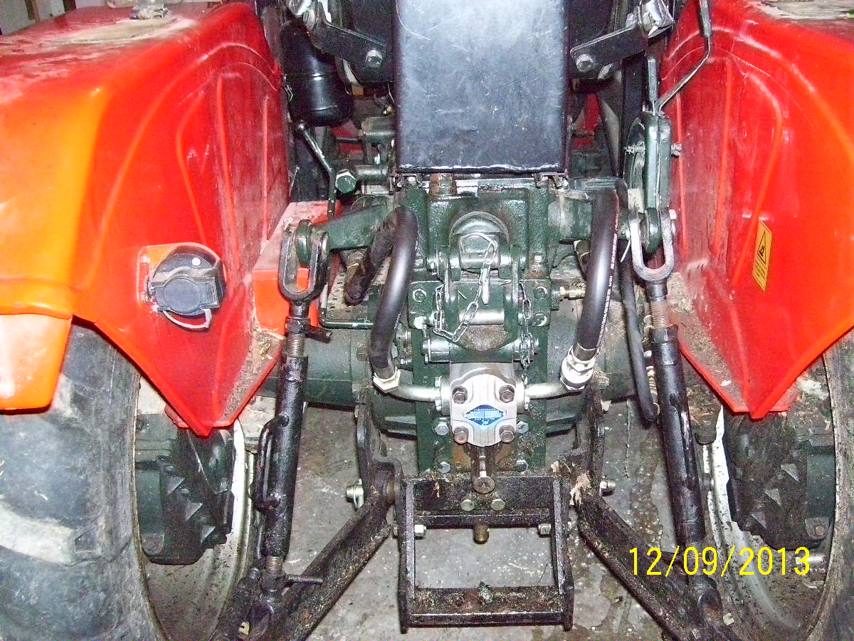

erj, yes the controls are on the left side. Here are a couple of pictures that show the lever that turns the tractor hydraulics on and off and the PTO on/off control. The other is Just a shot of the rear of the tractor.
Thanks,
David
