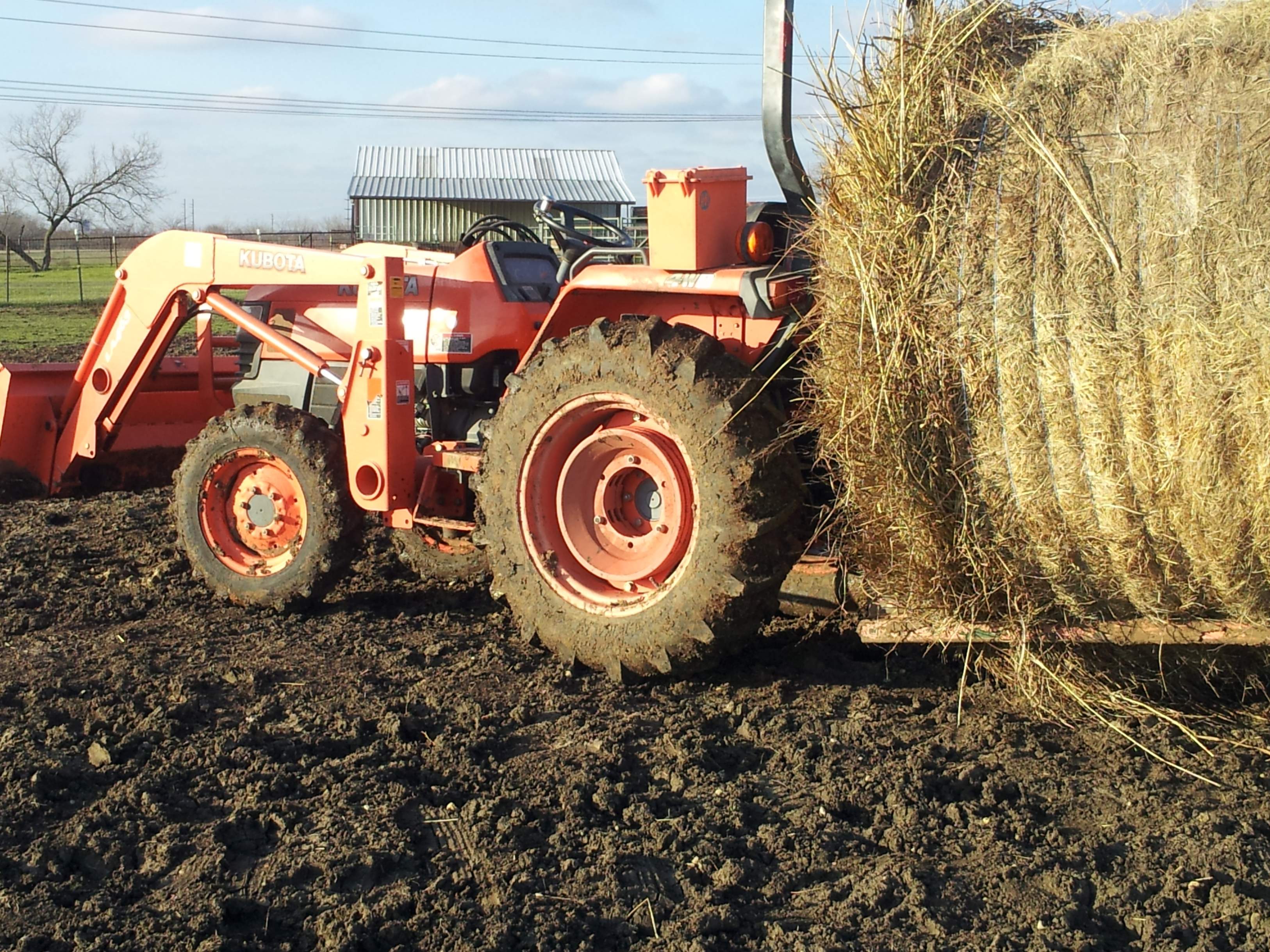

:thumbsup: Hi Guys!! It's been a rough couple weeks. I'm sorry didn't get back to y'all sooner! I've spent 2 days and evenings stripping my barn and putting back 650 pounds of fresh straw for bedding/soaking up all the darn water. Short story is, I ended up with sciatica. Hard for me to even sit long enough to read your excellent responses. Anyway, that first adjustment (http://www.tractorbynet.com/forums/...ift-3-point-hitch-img_20150307_233526_966-jpg) you all suggested helped me get a bale back to the cows without having to push it backwards on the ground. Many, many thanks! I have to goose the FEL to get the lift, but at this point, I am grateful.
As far as putting the tractor through its paces, I have to wait on that until things dry out... ... ... ... In the mean-time, I finally broke down and scheduled a visit with my chiropractor... Thank you again!!!

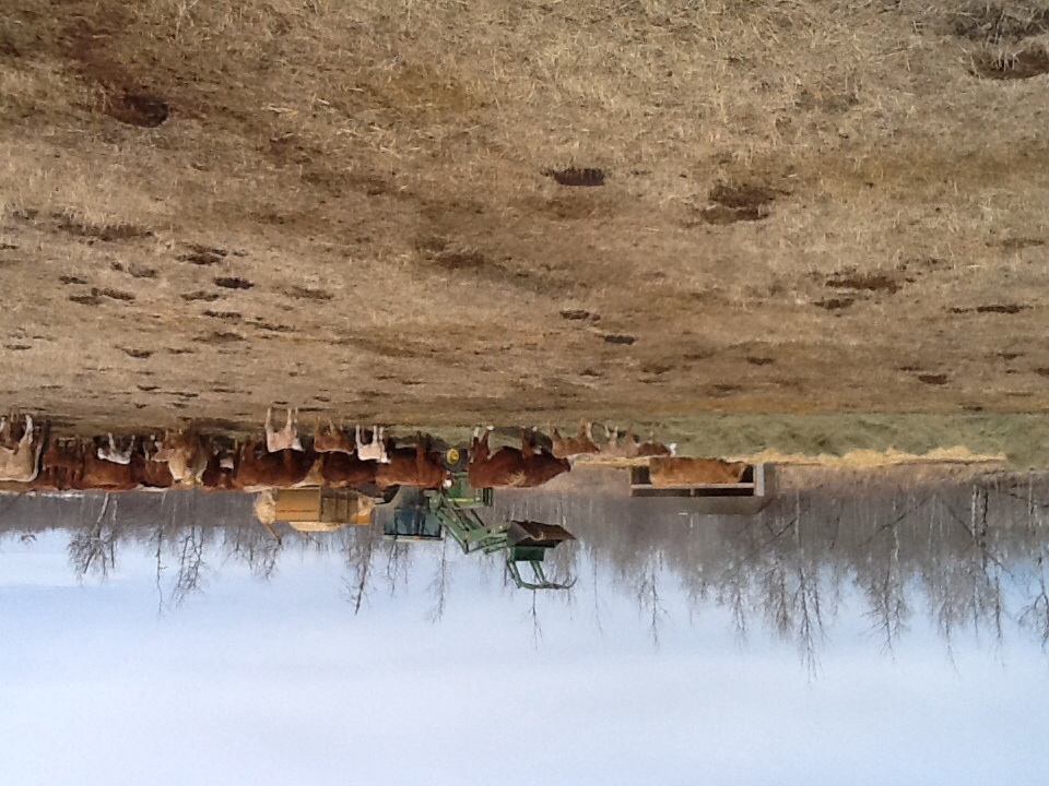

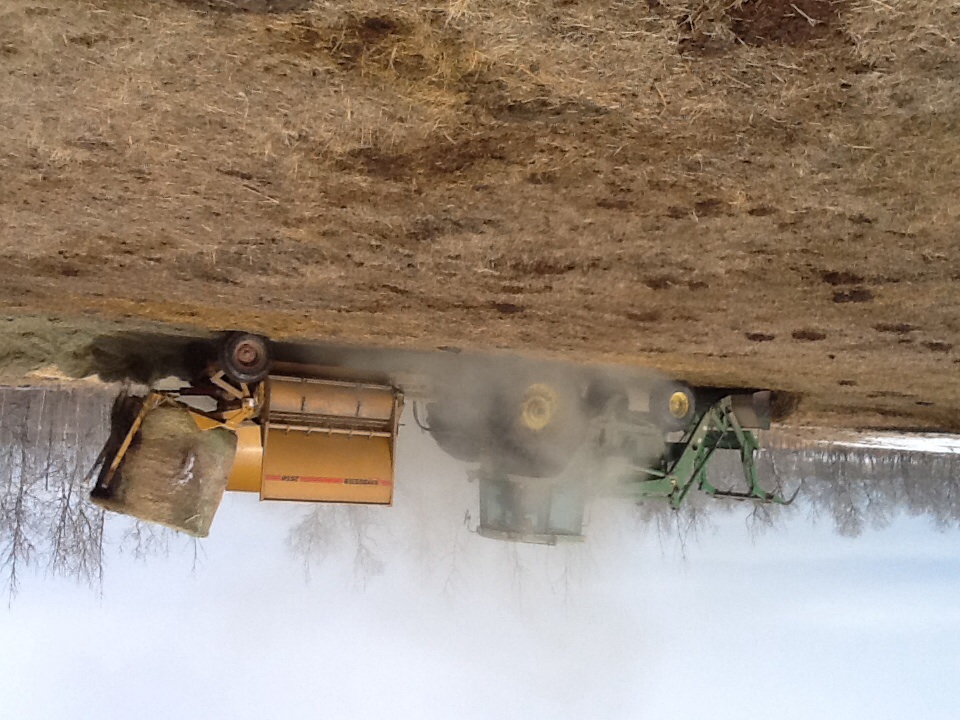

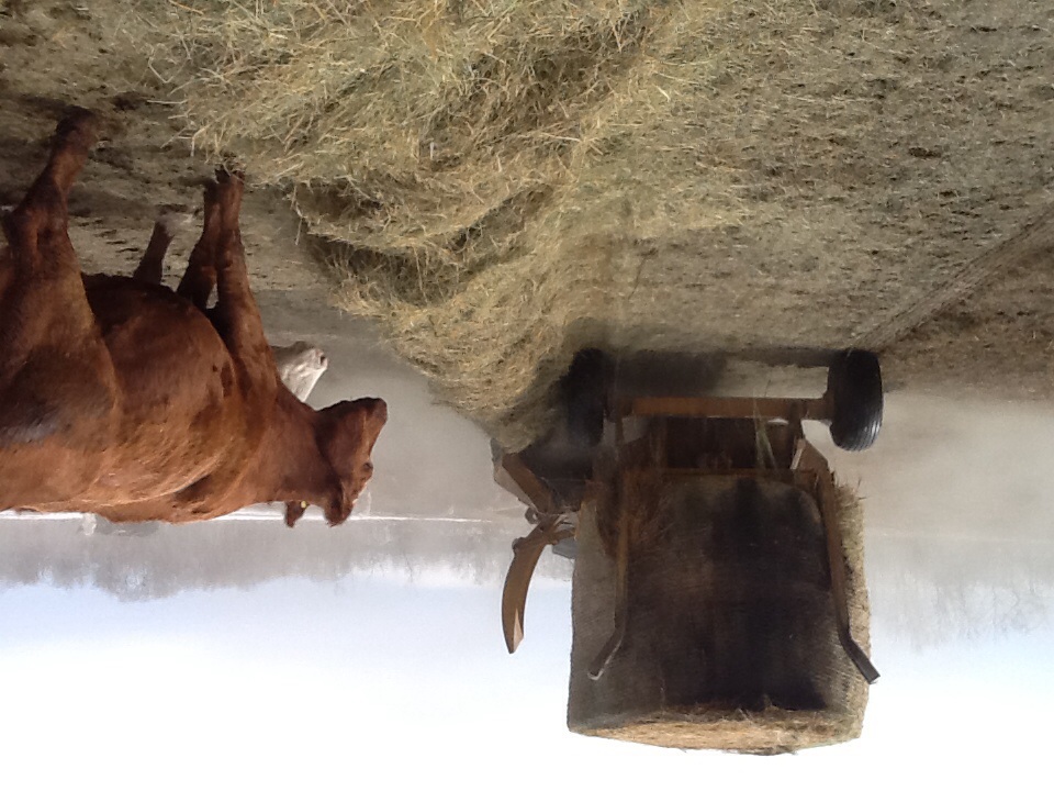

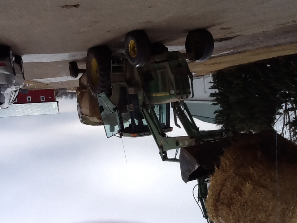

Pictures of feeding bales in Alberta. Thought it might be interesting.image.jpgimage.jpgimage.jpgimage.jpg
The ipad ! Upside down
